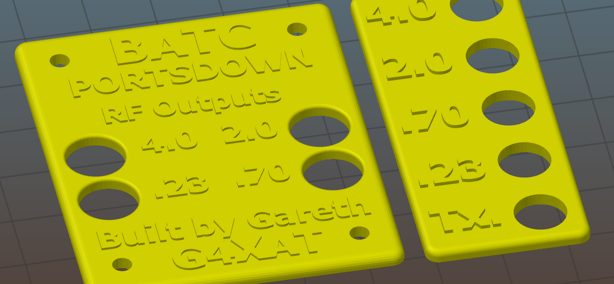

Not impossible to run a pair of same colour LEDs from the same point. I've made a plate to help me.

Very impressive 3D printing!

Thanks, I'm thoroughly enjoying making it work for its living, having to learn CAD to drive it but 'needs must' is a good motivator
I think I have the same such aerial in my storage, and a spare. To make the clips would be relatively easy and with availability of PETG filament which is both flexible and UV resistant would make for perfect spares. Must have a look at the dipole driver, can't be too mysterious.
