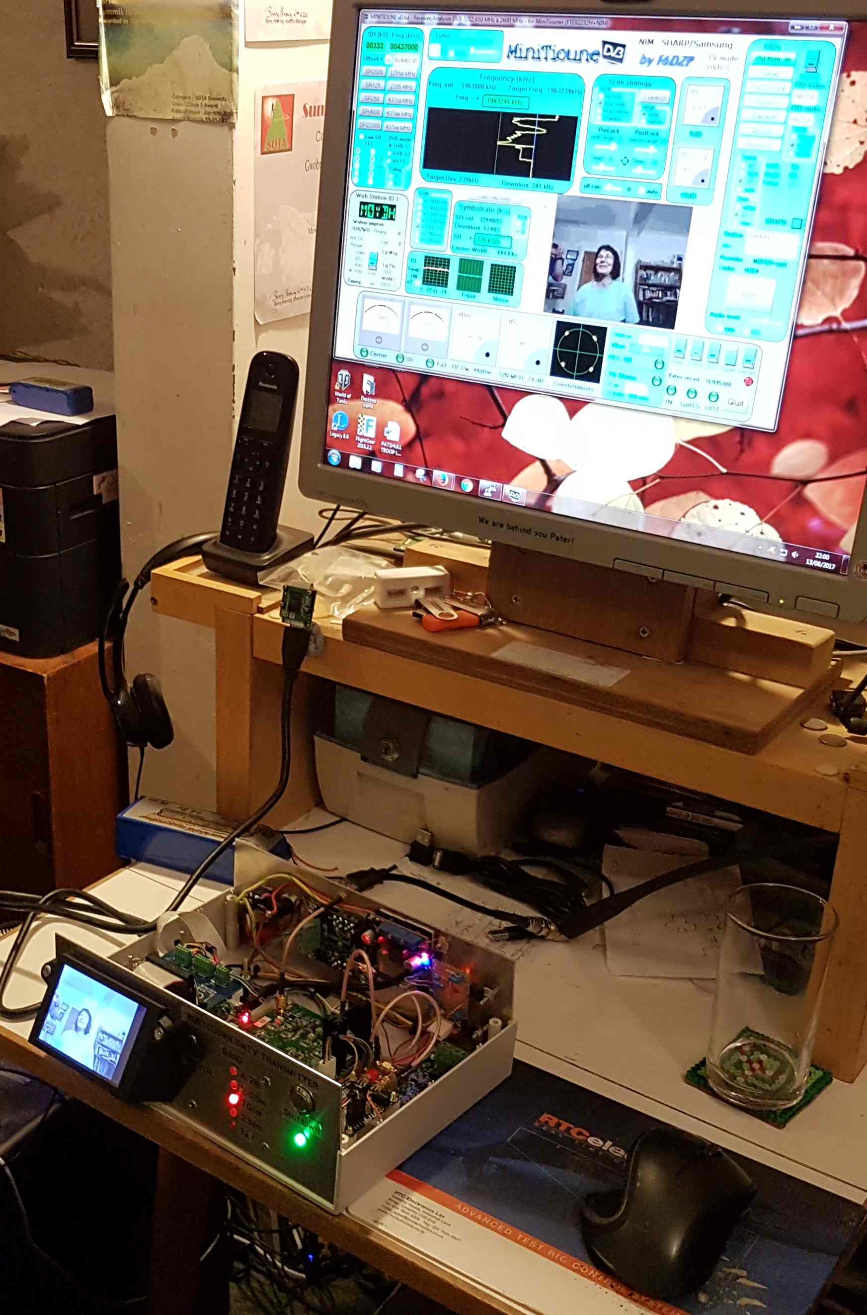

I've made it to this topic! Great relief too. Thank you very much everyone especially Noel, Dave and Colin.
My wife Ann-Charlotte is making her DATV debut below. Now I can help Dave G7MEG with his Portsdown set so there are 2 of these a mile apart.
David M0YDH

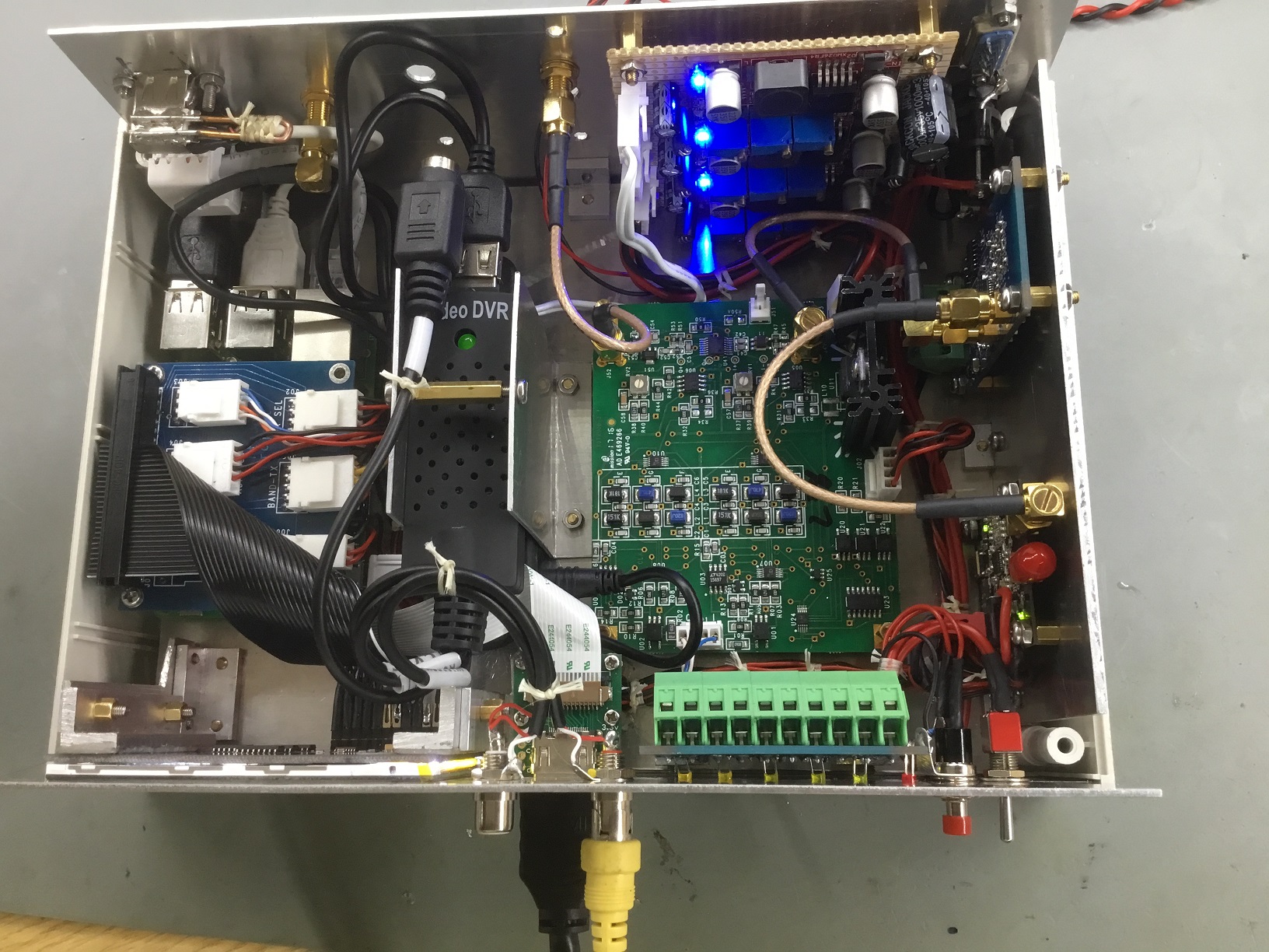

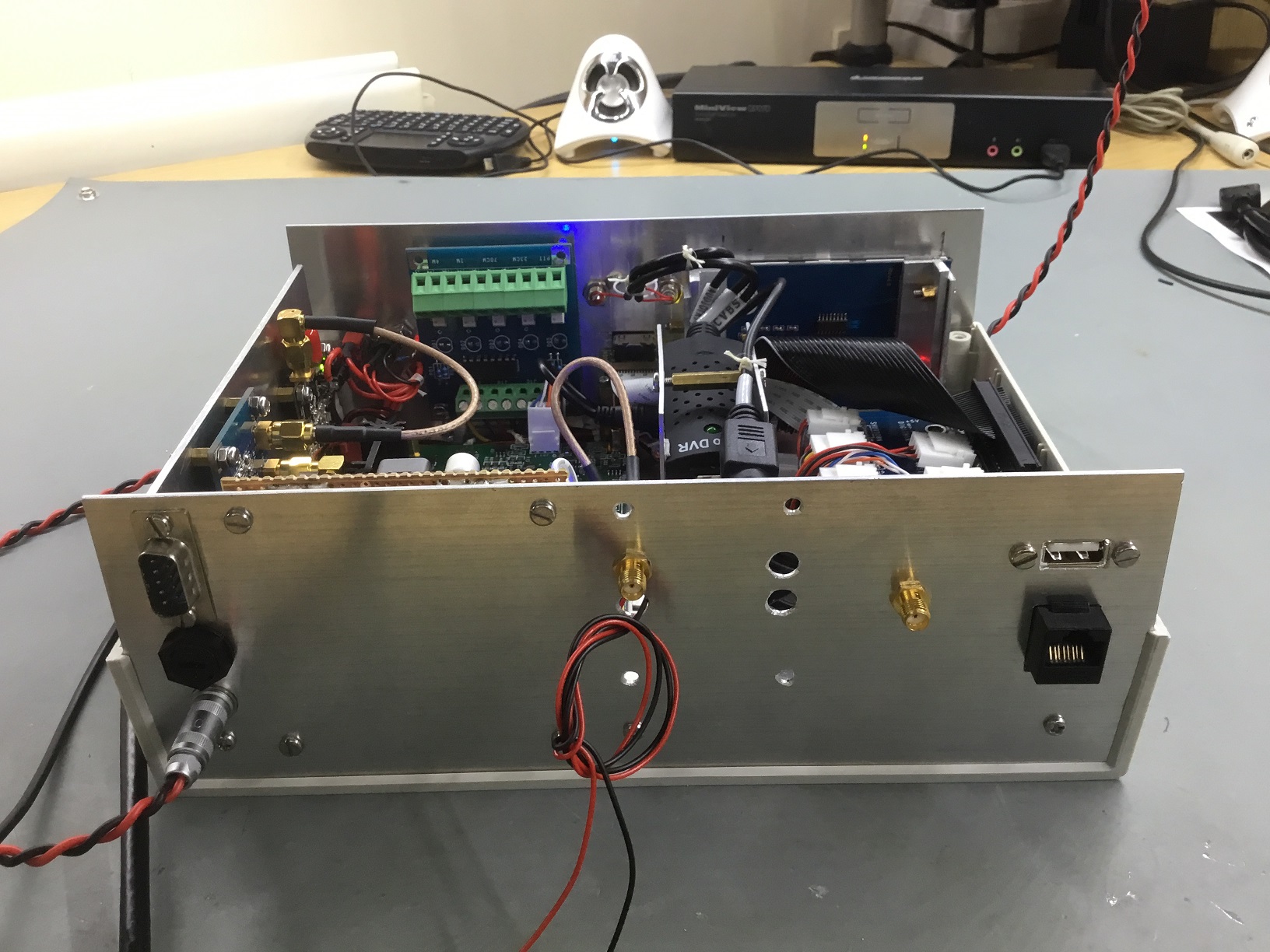

Here's a few photo's of my attempt at a Portsdown.
It has both the rtl rx dongle and EasyCap built into it, but no RF switch yet....
The front panel has the HDMI and composite + audio sockets easily accessible and no screw heads in sight - just need to get it engraved now.
The rear panel has connections for ethernet, USB, linear control (9 way dsub), DC input + fuse, RTL dongle RF in and RF output switch PCB (yet to be fitted).
I was a little concerned about heat build up but have had it running most of the afternoon in a fairly warm shack with no excessive temp rise.
In hindsight, not sure it was a good idea to build in the RTL dongle and EasyCap but if the worst came to the worst heat wise they are easily removed.
To help manage the heat issue, internally there's a 3mm thick base plate 'chassis' which supports the right hand chassis plate for the LO and filter and the rear panel for PSU and RF switch PCB.
The display and band switch PCBs are held to the base plate chassis by means of extrusion.
The RTL and easycap dongles are held in place by simple brackets attached to the base plate.
The modulator has its own 7V SMPS while the LO and filter are powered from another 7V SMPS. The RPI has its own 5.2V SMPS
I suspect because of the construction using fairly heavy aluminium plates to spread the heat and only 7V supplies the internal temps are adequately low.
I'm yet to test it with my DATVExpress - but so far so good.
Next project - linears for 70 and 146MHz.
Well done to everyone involved in creating this excellent bit of kit and 'putting up with' the barrage of questions from those of use who should spend more time RTFM
73 Tim

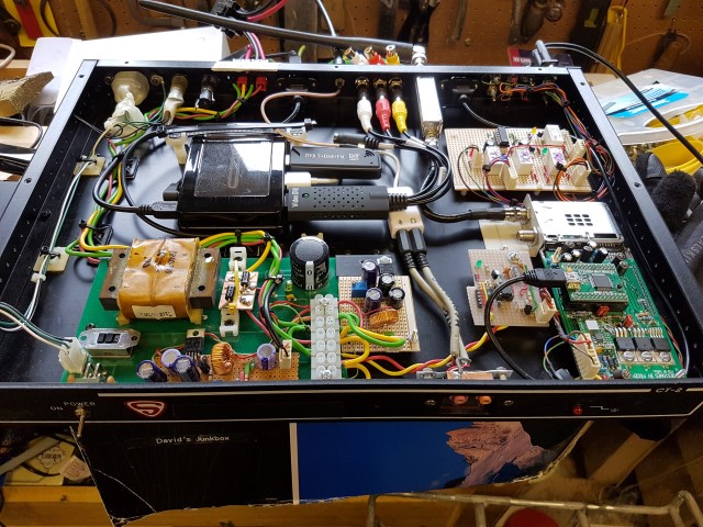

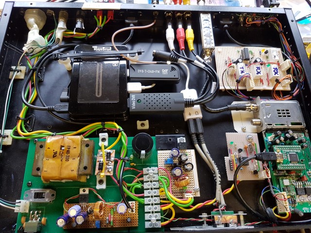

Hello all.
I've made an accessory unit to house all the items that connect to Portsdown transmitter but don't fit in the case because I adopted the G4KLB example early on. I'm really happy with it BTW. This means my Portsdown is in a small Farnell case. The 19 inch rack case used to contain some class of low frequency function generator. There's a 5 foot stack of these in our radio club room which I assume are towards club fundraising. I purchased a mains powered unit and cut off the function generator.
I had a Plugable powered USB hub left over from Raspberry Pi 1 days so I made the circuit from the LM2756-ADJ datasheet because I have the parts to hand to power it and it takes 32VDC input from the mains unit large capacitor. I made a diode switch from two 3 amp rated diodes to select the highest voltage and connected battery input line to one side of this and 32VDC to the other. I made another regulator like the first for 12v service to the rest of the contents. It's a home for my Minitiouner and converter with DISEqC switch. I've used a mini to USB B panel mount lead in 2 places for data. Also the relay sequencer circuit is housed and under Portsdown control.
Everything seems to work showing up on the Info menu item and across bench transmission were successful on pattern and Pi camera. MPEG2 view on the touchscreen worked but no pictures were seen on the Minitiouner. One to work on later. I saw the spectrum scope and it showed activity on fm calling frequency so RTL dongle is working. How do I test audio please? I recycled part of the front panel of a scrap PC to get the pretty audio fascia and socket unit. The accessory unit draws 100mA. 1.5A is needed total to also power the Portsdown. That's fine on the 13.8vdc input but too much for the original mains psu. Not a problem.
David M0YDH

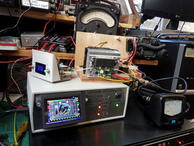

Re: Success Stories
I like your little developer privileges Dave!
Back in the shack this weekend, I had some positive progress. Whole watts of output from the Mini-kits 70cm amp were a source of joy and relief!
I had taken advice from Paul G8AQA and Ray M0DHP on the amp. My construction techniques were poor said Paul and the GM3SEK Blog article 14 ways not to make a 70cm transverter agreed! Packing the PCB up on washers when using a Mitsubishi module is number 11. Lots of leaky radiation points too. I was getting 10 to 20 W out using FT817ND on its 2 lowest power settings. My Attenuator board was doing good service. My M0HMO power meter stopped working so I can't give input power values. I tried with the Portsdown as pictured and it made 5W out at 0dB into the meter and dummy load and 6W without the attenuator. I guess patch lead cut into 2 isn't the best overall connection but it's the best I have to hand.
I've made a pcb box for the low pass filter so it can definitely give no trouble in the amp enclosure.
David
