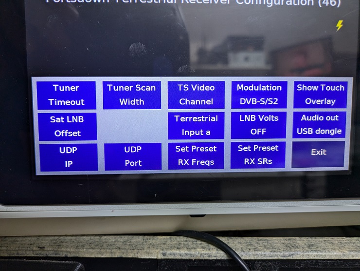

Hi Brian, Keith,
the LNB auto calibrate is not showing!!!!
Dave, I have rebuilt the card and the LNB calibrate has appeared.. Did a test TX to my PD4 Pico tuner combination, but still no picture. Also the LNB auto calibrate has disappeared.
Just to recap..PD4 is TXing, taking pictures on my Ryde. PD4 will not take a picture from my PD2020. The PD2020 is TXing as the Ryde will take a picture. I think I will do another card rebuild with a different SD card, see if that will solve it

Re: Pico tuner help
Two immediate comments.
There is no auto-calibrate in Terrestrial which you have selected. If you select QO-100 it will appear.
You have a low voltage warning (the lightning bolt). Please check the voltage between pins 4 and 6 on the GPIO. It should be at least 4.9 v. This could be the cause of some of your problems - especially if the voltage is low during card build.
