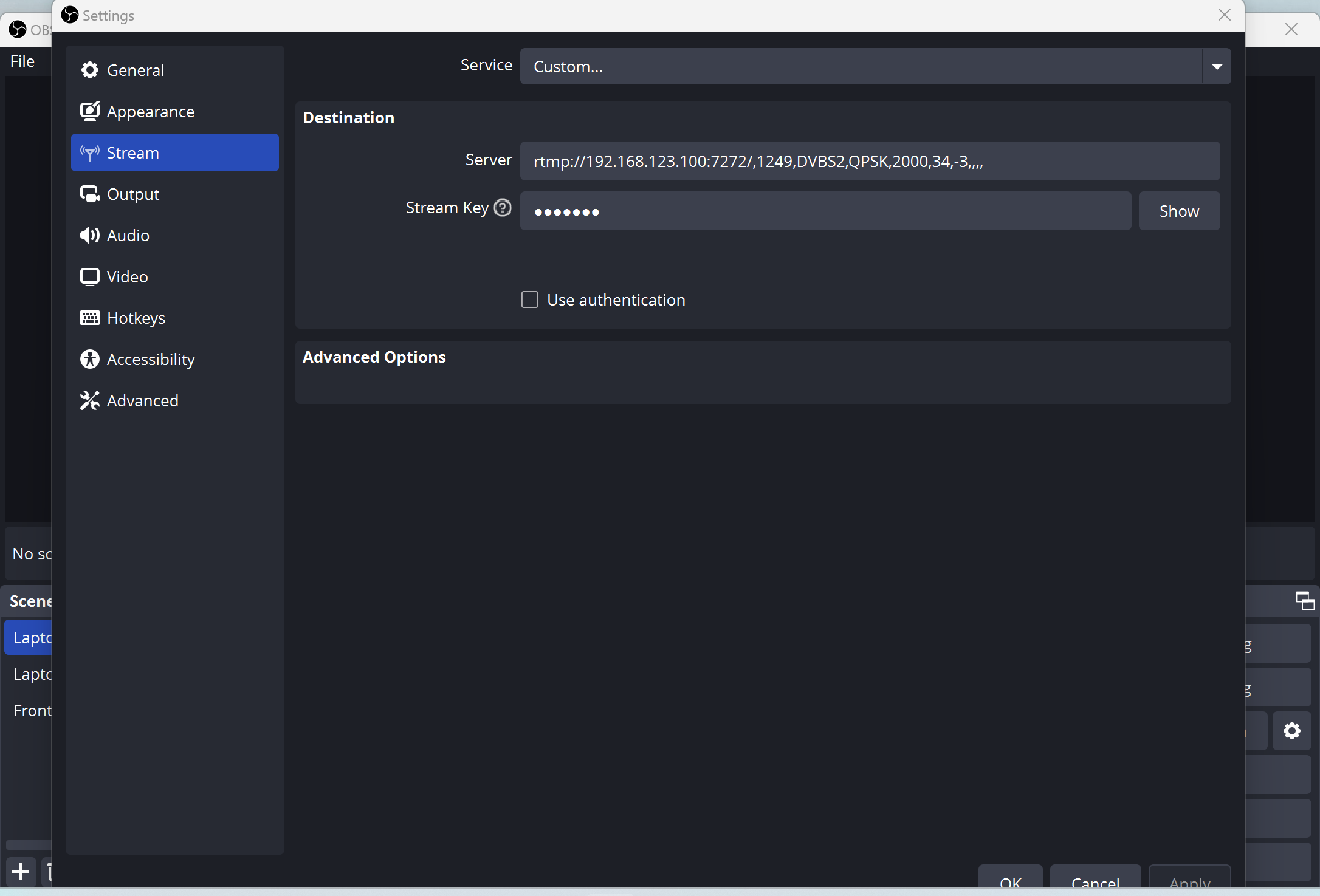

Joe, you could just transmit from your laptop as you are running OBS. You need to have your Pluto on your network (you have to find out how to do that) then stream from your OBS to it.
Here is a clue to that (this is from my network) Martin G8LCE
Re: portsdown 4
That's the stream in option to a pluto - I thought we were talking about the Portsdown 4. You can stream in to the Protsdown. This is the IPTSin - here is an old quite long thread on the topic viewtopic.php?t=6118
