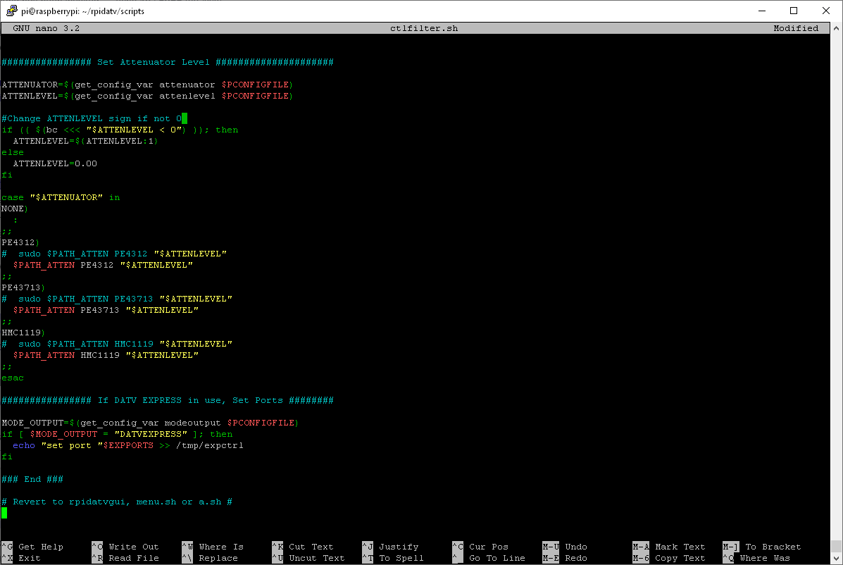

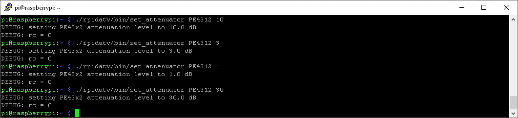

I had a problem also with the attenuator on Portsdown4. Worked fine from the command line, but not when called from the menu into TX.
I think the problem is that the ctlfilter.sh script wants to run the application as root. I modified it to run without elevation and it seems fine.
Tested using PE4302 on Portsdown4 Buster 202102250.
Command line testing done with the platform in TX. Changes on the fly without issue.

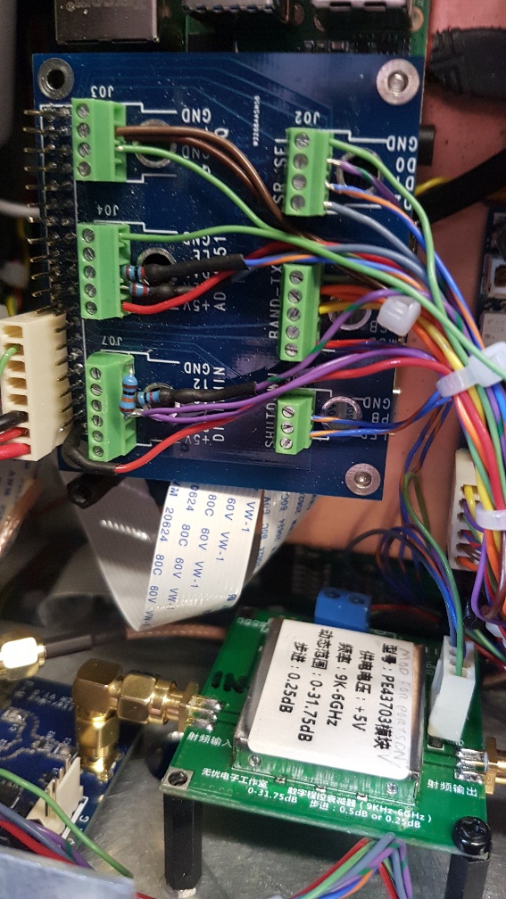

I can't get the Pluto and attenuator combination working.
I've a PE43703 which has seen Portsdown action before. Solder blobs J4 and J7 are open circuit. J3 is soldered. I did find that I'd cross connected LE and CLK - now corrected. But that hasn't brought the device into control. In 437MHz 333KS Pluto 0, I have 577uW out of the 2 way and 8 way switches. Adding the attenuator card lowers this to 458uW so -1dB instead of anticipated -2. Altering the attenuation value on the screen to e.g. -3 makes no change to power output. During Tx, I'm measuring 0V at the card's connector block of DAT, CLK and LE to ground. These lines all measure 1Kohm terminal block to block.
Software is Buster 202104250.
Can anyone spot an obvious problem or suggest a course of action please? Is the attenuator a dead 'un? I have crude control using Pluto output [-10 here makes it 54uW output]. 2 PE4302 cards are on order and may arrive in late June.
David M0YDH

David
Do you see any data on the data line when you change the filter settings?
Pluto Power should give you control of Pluto output in 1 dB steps. Do you need the attenuator?

David,
Does the attenuator work in parallel addressing mode (using the DIP switches) ? If so, then it may not be technically 'dead'. However, I had one of these that simply would not work in serial mode, even though I checked everything, but it worked in parallel mode. Not much use as a 'programmable' attenuator, but it's in the junk box in case I need an adjustable attenuator.
Jen
