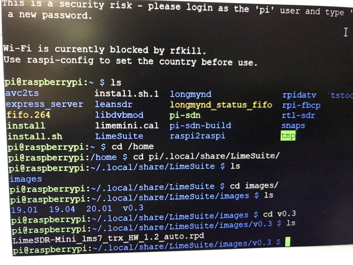

Re: Portsdown Buster 202003140 - Recommended Build
There are, the firmware file. Testing 30 versions of the same signs.
I always think about the unknown problems in the process of building, (Including my problem encountered in portsdown2019 h264 doesn't work)is likely to be caused by network.
Can you provide a building to complete the SD card image file to test the reason?

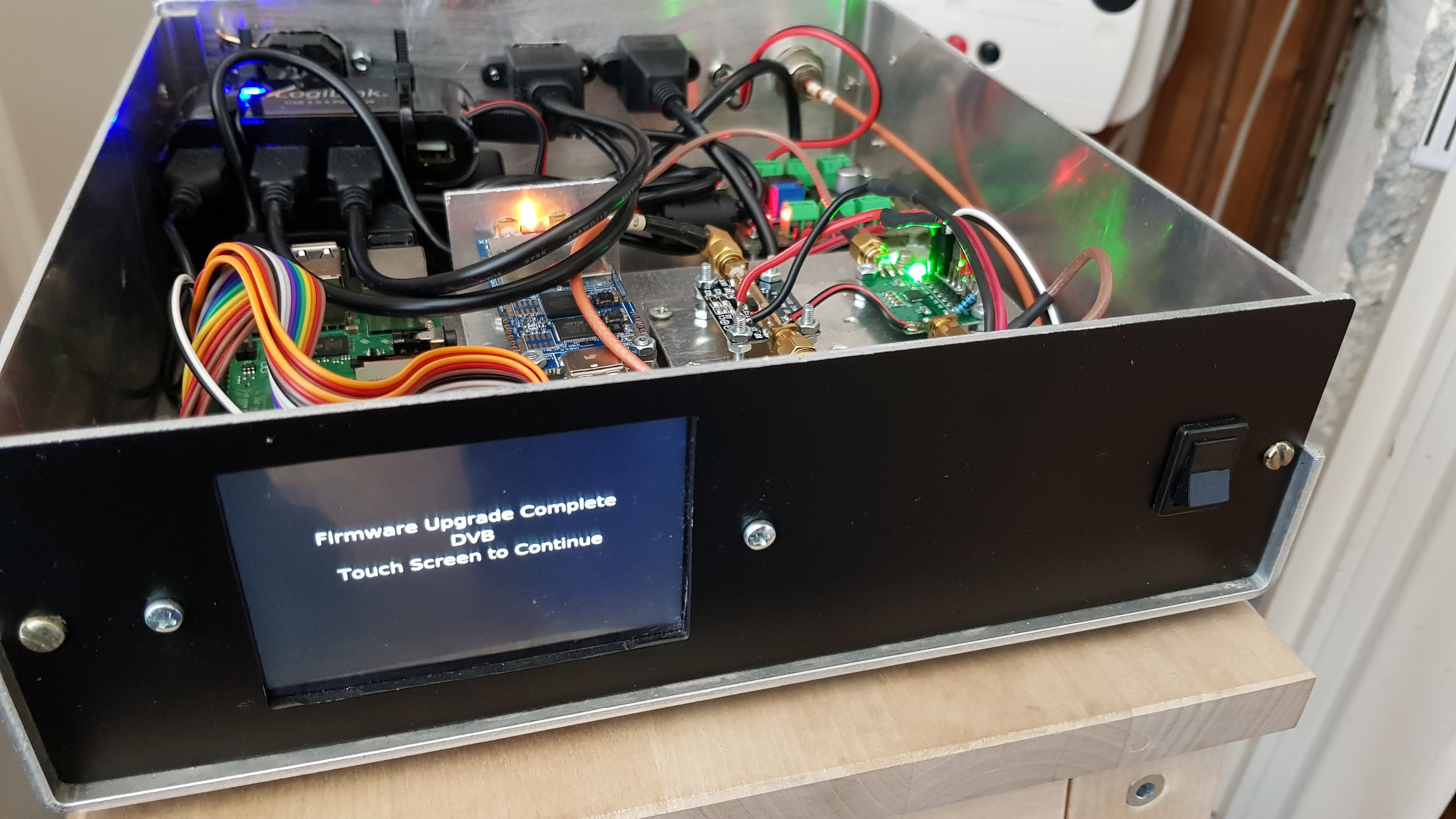

SW upgrade worked fine.
Thanks Dave
Thanks Dave
Hi BG0AUB
You have some files in your home directory that suggest you have not followed the installation instructions properly.
What is the file install.sh.1 ? That should not be there. And the file install ?
Have you looked at the terminal during the build? Are there any errors coming up?
I cannot post an image file as I change the software too often for that. Last time I did it, it took me 4 hours, and I do not have the time to spare. I build at least one new card each day and very rarely have any problems. If you are really stuck, you could buy an SD Card from the BATC Shop.

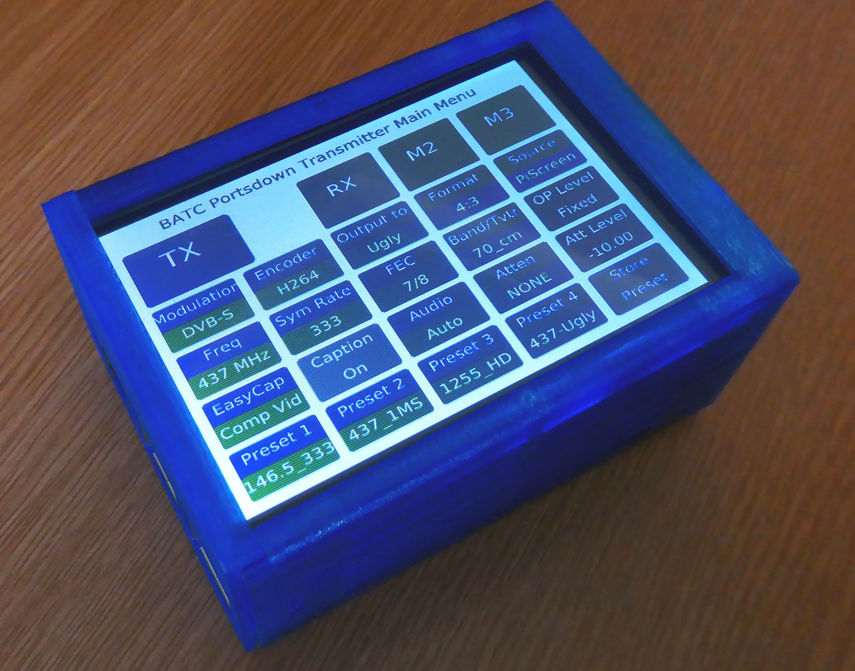

My new minimal portable Portsdown.
RPI3
Pijuice
Waveshare Screen
To do anything useful things need to be attached, e.g. A webcam and a LimeSDR, or a network cable.
RPI3
Pijuice
Waveshare Screen
- Posts: 1490
I can see this concept taking off. New case to include a Picamera, Hardwire a Lime mini inside but leaving access to SMA's, add external DC power (powerbank being commonplace - option). Good to go
I've already got a RPI/Screen/Camera/DC converter/RTL Dongle which I use for 'sanity checking'.....and to do a proper job is on my to-do list.....)
