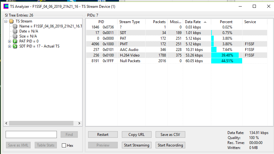

F1SSF
Posts: 93
Joined: Sat Nov 25, 2017 5:14 pm
Re: OBS via IPTSin on the PortsDown
Post by F1SSF » Tue Jun 04, 2019 8:12 pm
Hi John (and alls)
Thank you for short contact and support on QO100.
As I told you, I set OBS by following the forum informations.
Generate profile SR250 + script SR250 + modif thread ffmpeg
when I transmit on QO100, all lights are green on Minitioun, and the datas enter in minitioun, but I do not decode the image.
Before, I would like to correct a stupidity, my video card on Laptop is not an Nvidia, but an Intel integrated. CPU is I5 with 8Go Ram.
I think my problem is my video stream is not conform, there are some informations on the script that I don't understood and a lot of null packets when I record my transmission
ts analys.PNG (36 KiB) Viewed 9623 times
My webcam is C920, I use Porstdown + Lime .
I have calculated the MUX , and FFVBitrate, but I am not sure about Input and output video screen format for SR250 in OBS and script.
Do you have an idea?
Thank you very much.
73 Franck F1SSF
Sorry for my English, it is more easy for me to write that speaking et listening :oops:
