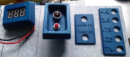

Post by radiogareth » Thu Nov 08, 2018 8:08 am
That's filled the gap :-)

Posts: 1487
Re: Portsdown boxing/build thread

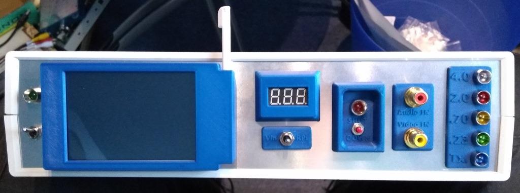

Post by radiogareth » Sat Nov 10, 2018 2:12 pm
Front panel done :-) Just got to wire it all up now.....

G1BVI
Posts: 334
Post by G1BVI » Sat Nov 10, 2018 7:32 pm
Hi Gareth
Looks like your printer has been working overtime :-)
You could add audio out, which I use when I stream to Portsdown
Nick
