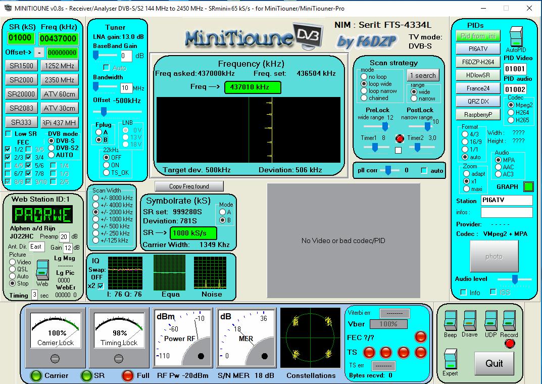

Re: No video on transmit
Hi All,
I'm trying to get some picture from my Portsdown, but nothing at all....
I tried everything, even the remarks in this treat.
I have attached a screenshot of MiniTiouner and I hope op some eureka....
73's
Rob PA0RWE
73's
Rob PA0RWE
- SNAG-001.jpg (216.14 KiB) Viewed 4841 times
Hi Rob
We need some more information before we can guess your problem.
1. I take it that MiniTioune works with PI6ATV, so the problem must be in the Portsdown?
2. Did your Portsdown work in Ugly mode? (437 MHz 333KS)
3. What video source are you trying to use on the Portsdown?
4. What Encoder are you trying to use on the Portsdown?
5. What modulator are you trying to use on the Portsdown? (Filter-modulator Board, DATV Express, Lime?)
6. What Portsdown software version are you using?
Photos of Menu 1 and the Info screen would be useful.
