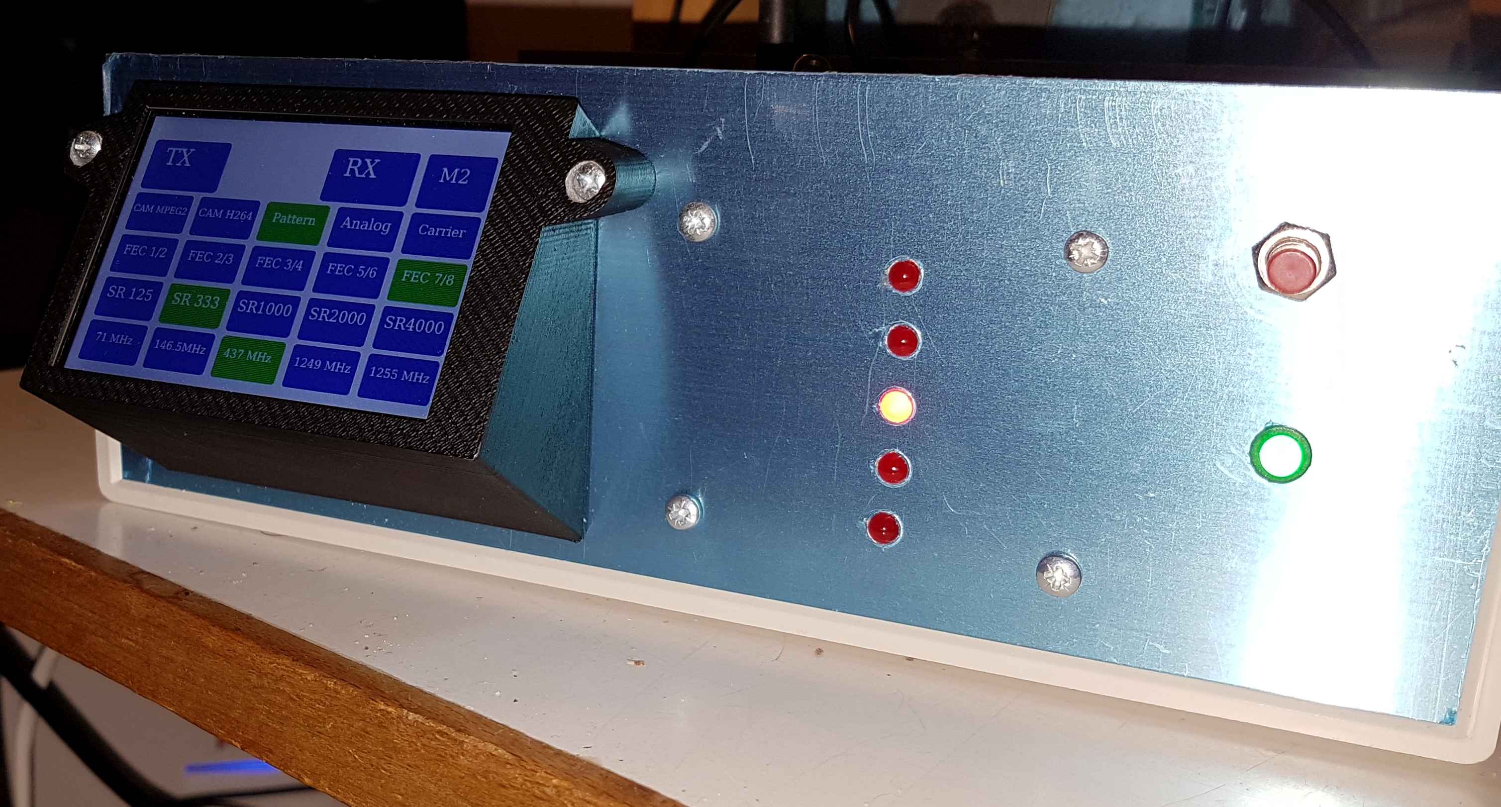

I quietly had 2 printed at work as a training exercise. Please don't ask for more.
Fit is good to the LCD. Mounting to your Farnell case is easier ie 2 tapped M3 holes and an aperture nibbled in for the connector. My son spray painted it with 2 coats of black primer. Ergonomically it gives an easier reading angle plus Dave G7MEG and I found out the pushing angle helps the case stay still. I made a wooden packing piece to fill the space behind and miss the connections and IC's.

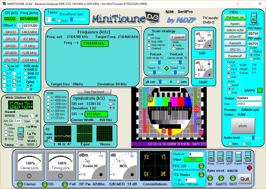

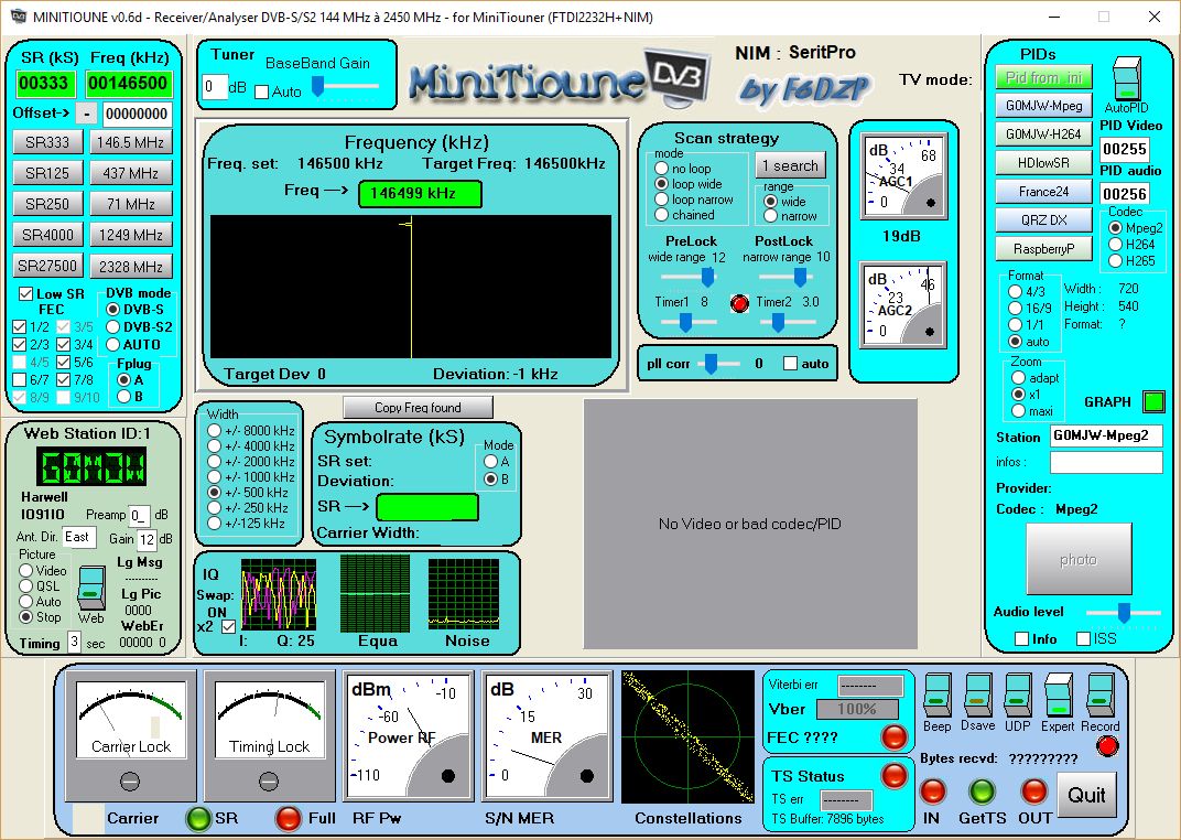

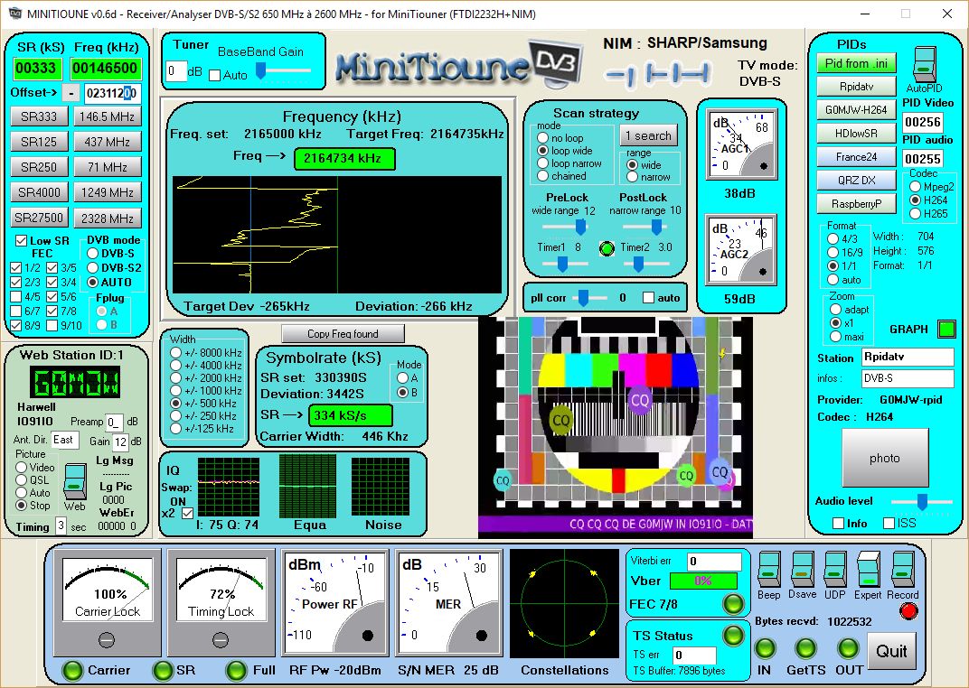

I suppose pictures don't lie - Serit does not work so well on 2m natively. The three images are all exactly the same set up and power levels and in degrading levels of performance. This is a direct cable connection, with attenuators. The first is the sharp with an up-converter. The second is the Serit with the same up-converter, the third is the Serit on 2m directly.
Sharp NIM - Portsdown.jpg (233.1 KiB) Viewed 8446 times
Serit NIM - Conveter - Portsdown.jpg (228.61 KiB) Viewed 8446 times
Serit NIM - Portsdown.jpg (209.49 KiB) Viewed 8446 times
I could not get the Serit NIM to lock to the portsdown. However, it will lock to my digithin and my DATV Express, so there is something about the signal it doesn't like. It must be the spurious signals. I then put in a low pass filter. This recovered the situation considerably. The forum will not allow more than 3 screenshots, so I will put this in another message.
Moral - you can't expect the Serit to work on 2m without good filtering.

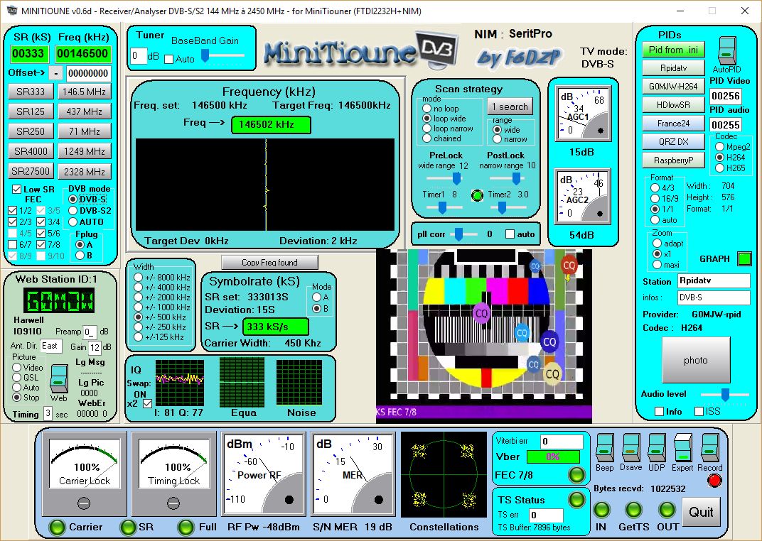

The Serit after I fitted a low pass filter to the portsdown source.
Serit NIM - LPF - Portsdown.jpg (229.19 KiB) Viewed 8447 times
I suppose the other thing to add is the Sharp Nim, even after an up-converter, has a much better MER.
