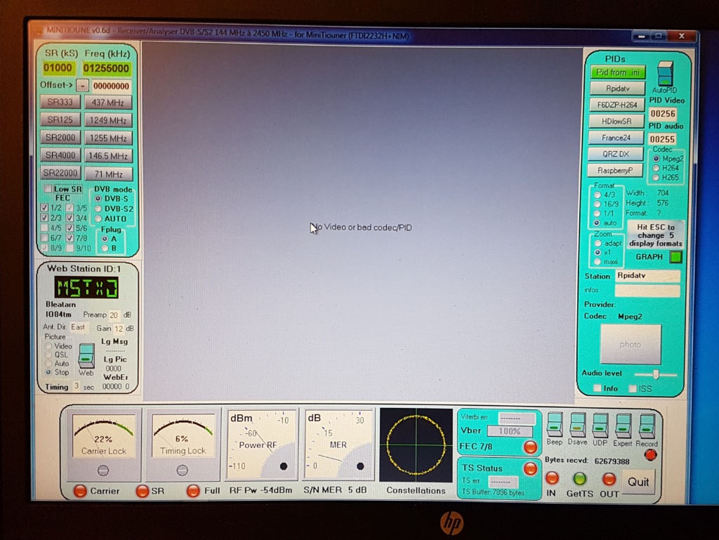

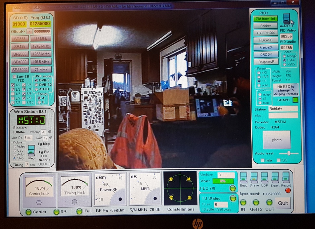

Yes me again! The build and testing continues and I've hit an issue, not sure if it's me. The Portsdown works great on all modes with the Pi camera but I've just acquired an ex CCTV camera and although all seems fine on H264 I'm getting the circular constellation if I try MPEG2. I've tried various frequencies and SR's but always the same. Software version 201801061

Thanks Ray but the camera is composite out into the easy-cap, and it works fine in H264 just not MPEG2.

- H264 mode
- 0162018174037.jpg (314.45 KiB) Viewed 5577 times
- MPEG2 mode
- 0162018173952.jpg (270.06 KiB) Viewed 5577 times

Not a problem that I have seen before. However, please go into the console, go to System Setup, and then option 8 "Audio Input". Use the down arrows and then the space bar to select "no_audio" and press enter.
Then see if the problem is still there.
