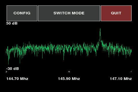

I've just issued a new release 201801012. It includes the FreqShow spectrum viewer (using an RTL-SDR) which can be selected from Menu 3. More details here https://wiki.batc.org.uk/FreqShow; example display below. It also introduces basic support for the Element 14 7 inch touchscreen, which can be selected in the Display menu of the Console. Note that FreqShow and Video View modes do not yet work with the Element 14 7 inch display.
The release cures the occasional crashes that happened after multiple selections of the signal generator and also enables IPTS streaming in all (H264 and MPEG-2) modes. It also correctly highlights input selections made on Menu 2.

- fs2.jpg (39.55 KiB) Viewed 5014 times

Hi Dave,
Edit: It works with the waveshare 3.5, but no touch with HDMI waveshare 7.

Yes - that's what I meant by not working with the 7 inch screen. FreqShow does not respond to touch commands from the 7 inch screen. The package used for the touch handling is tstools, so if anyone knows how to get tstools to respond to touch on the Element 14 7 inch screen, I'd be very interested to try to fix the bug. There is also a minor problem with event labelling, but this is not the root cause of the problem.
