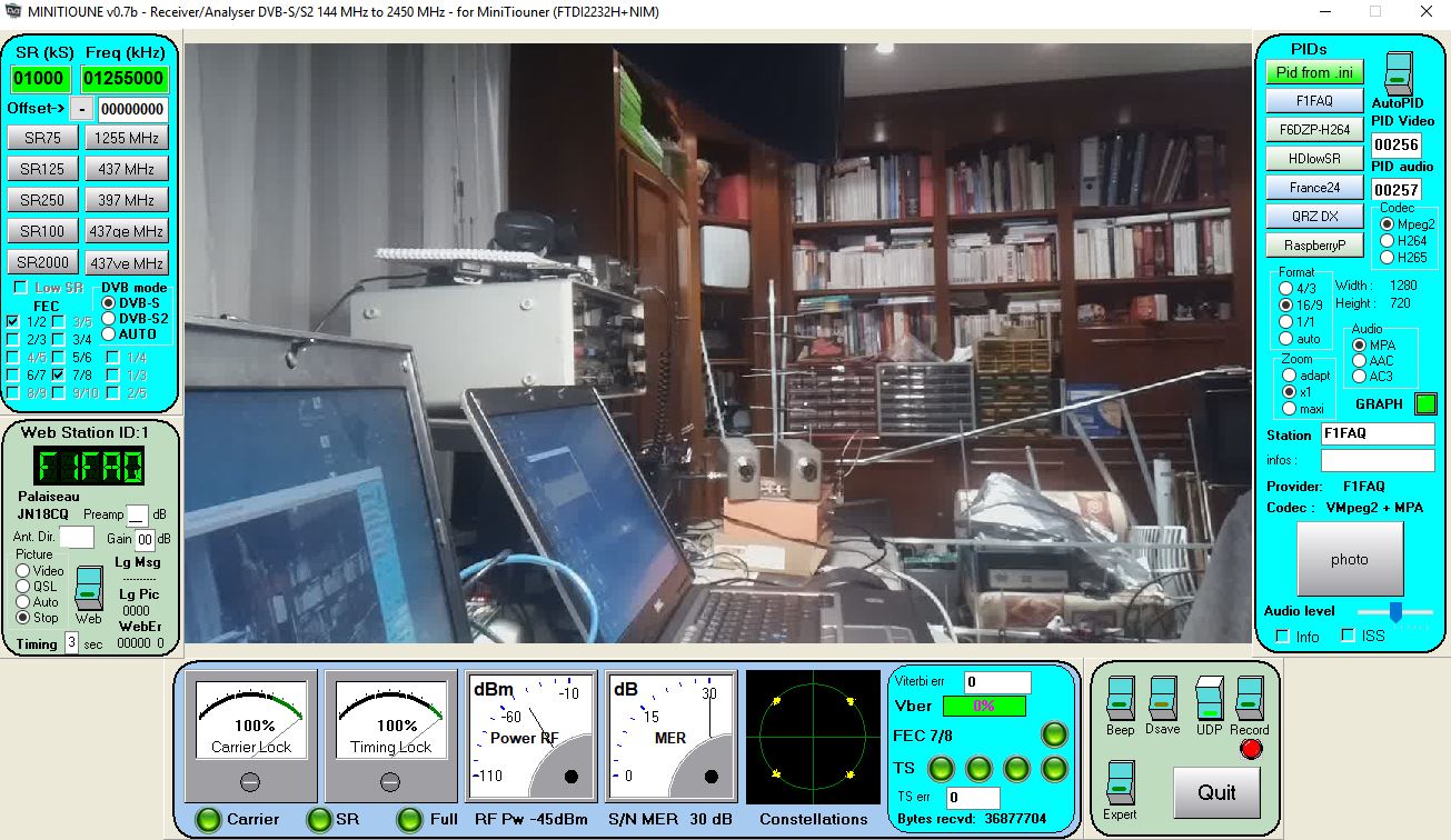

With the help of some further tests on 201711271 release
1. Can you explain what we should see with option "static test Card F"
I have nothing displayed at all, just have the "beep" sound
2. I confirm you can drive the Datv Express board via USB port from Portsdown in H264
or mpeg2 encoded (but now also with 1280x720 resolution with CAMHDMPEG2) TS.
But yes you are limited to DVB-S by doing this way
But:

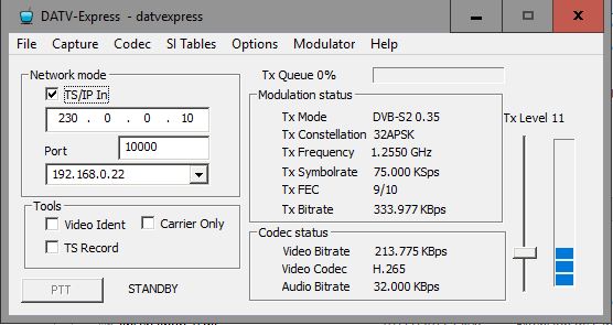

3. If you use the last version V1.26 of the DATV Express software released by Evariste F5OEO,
you now have an Ethernet based (IP - udp) input for the TS.
This means that you provide an external TS (from Portsdown or ffmpeg running on xxxx or....)
and the V1.26 software will enable you to choose DVB-S or DVB-S2 or DVB-T modulation !
My latest tests were :
- Portsdown H264 TS (input the raspi cam / output is IP) from Ethernet port to V1.26 DATV Express software
feeding the DATV board through USB link
- Same with mpeg2 encoding from Portsdown does not work (from where my question above)
- ffmpeg software running on a pc with a modified Vmix2rpi file, streaming H262 or H264 or H265 and finally having
high definition/resolution pictures streamed in 100Khz bandwith ! parameters were : 1255 - 7/8 - SR75000 - DVBS2 - 32APSK
But yes with a delay of 25 sec in case of H265 !
Below the faceplate of the V1.26 release and the result with CAMHDMPEG2 on Minitioune
Faceplate V1.26.JPG (41.81 KiB) Viewed 6011 times
Minitioune CAMHDMPEG2 Datv Express from Portsdown (USB).JPG (218.02 KiB) Viewed 6011 times
73 - Christian

Nice 720p picture!
The Card MPEG-2 mode should transmit a static test card F in 720x576 5fps in MPEG-2. I'll check it out within DATV Express this weekend.
