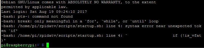

I performed an upgrade to the lastest version and encountered this problem:
The RPI was streaming to my personal stream, connect with Putty and execute /home/pi/rpidatv/scripts/menu.sh menu and select Upgrade after rebooting got this result.
RPI streaming.jpg (110.71 KiB) Viewed 6243 times
This error is also shown using /home/pi/rpidatv/scripts/menu.sh menu
RPI streaming_1.jpg (93.92 KiB) Viewed 6243 times

Update:
An upgrade of the previous FW version with default PSW worked OK

Post by G8GKQ » Sun Aug 20, 2017 8:34 pm
For Freddy ON1AVO:
Sorry for the delay, I've been trying to understand the errors that you have. They just do not make sense. I think that your SD Card might have been corrupted.
Please try another update. If that produces more errors, I suggest that you rebuild the card with the latest version.
