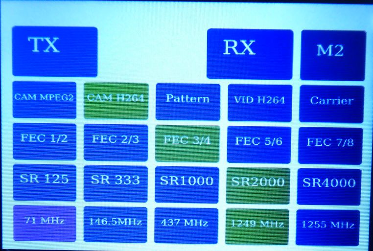

I've just issued a new release 201707311. It introduces 2 new features. You can select Menu 3 from Menu 2 of the touchscreen; the only new button on Menu 3 (so far) is an "Info" button, which puts up an information screen including the Portsdown software version, IP address and configuration. The other new feature is that on selection of "Vid Out" mode, the USB microphone audio is routed to the RPi audio output. This allows the use of the Portsdown to drive analogue transmitters with sound and video.

Took me a while to see that little menu 3 in the bottom right. Is the touch screen source code available?
Edit - I have found it. Made a very subtle change to test I understood what I was doing.
