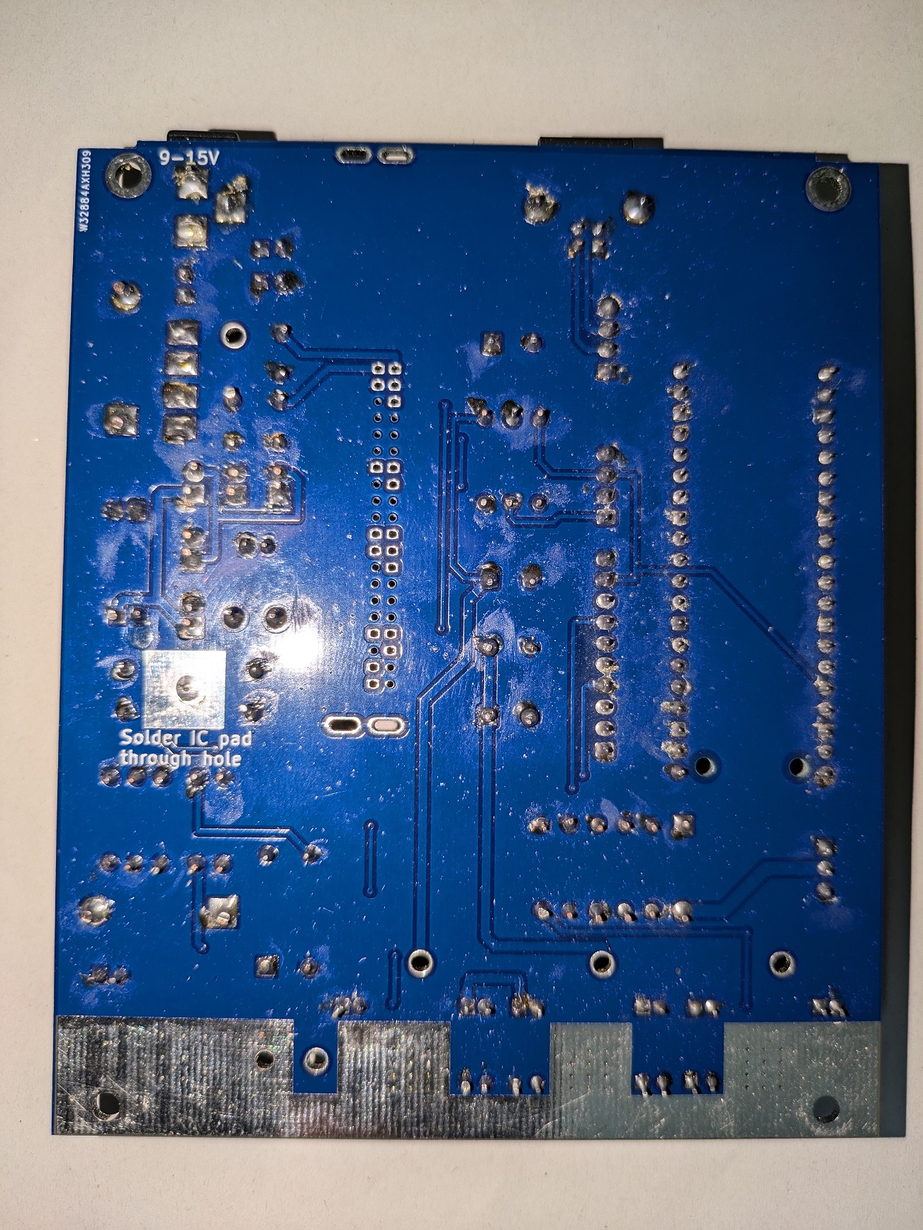

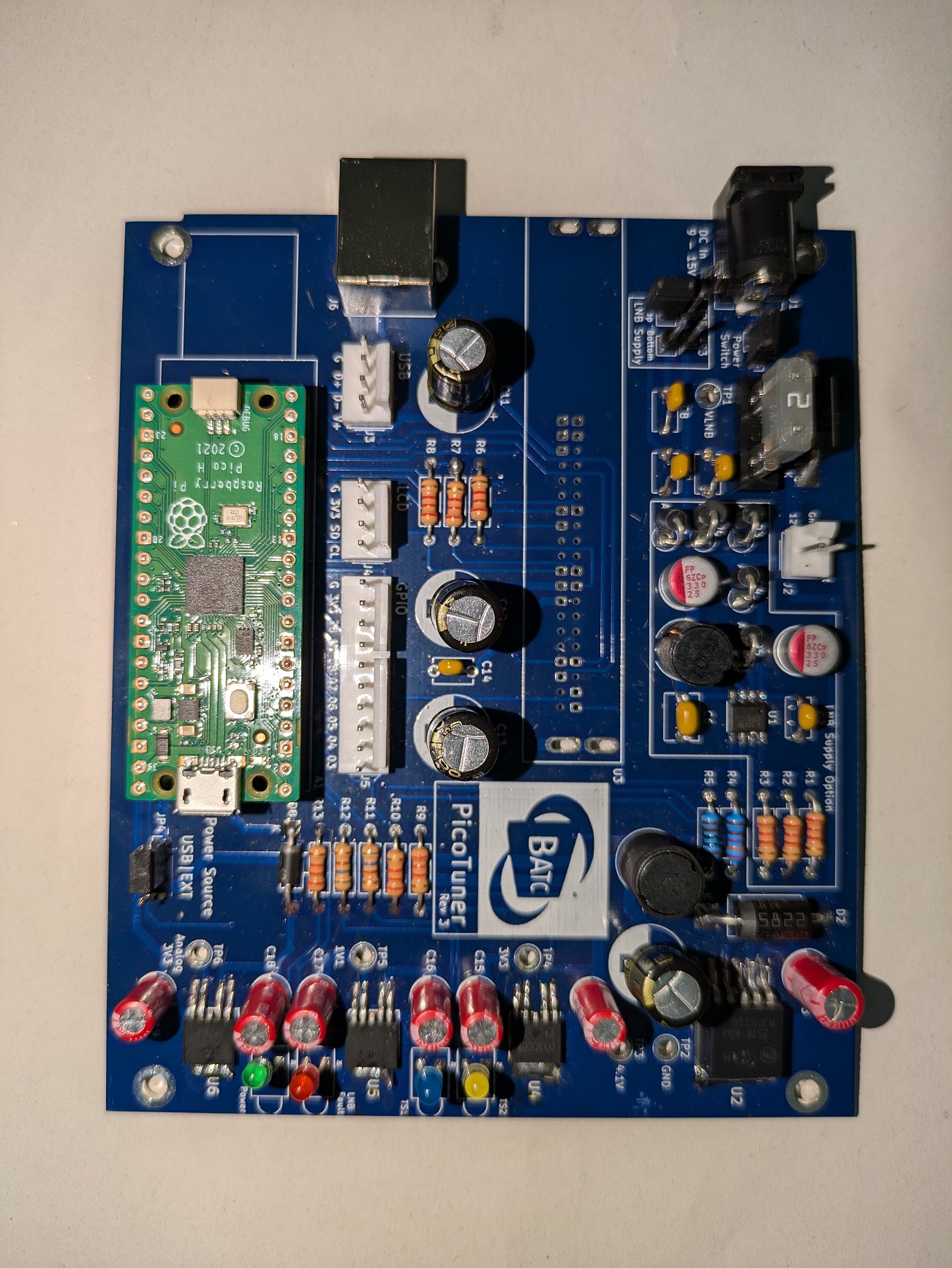

Where exactly did you buy the regulators? I still think you have a short on the 3.3V digital line. Hence the request for a high res photo of both sides of the PCB. There is probably nothing wrong with the 1.1V regulator, it is supplied by the 3.3V regulator so won't work until then.
I am assuming you have not over-volted the regulators, say with the wrong resistors on the switching supply, nor reverse biased them. Also that the tab really is soldered properly and not just sitting there on a film of flux.

I've attached front and back photos as requested.

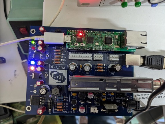

The TP volts look ok, I suggest you test it now on ext 12v input, remember to move link and test lnb volts, if all ok fit the nim and test with opentuner 0b or portsdown 4, hope it all goes Ok.

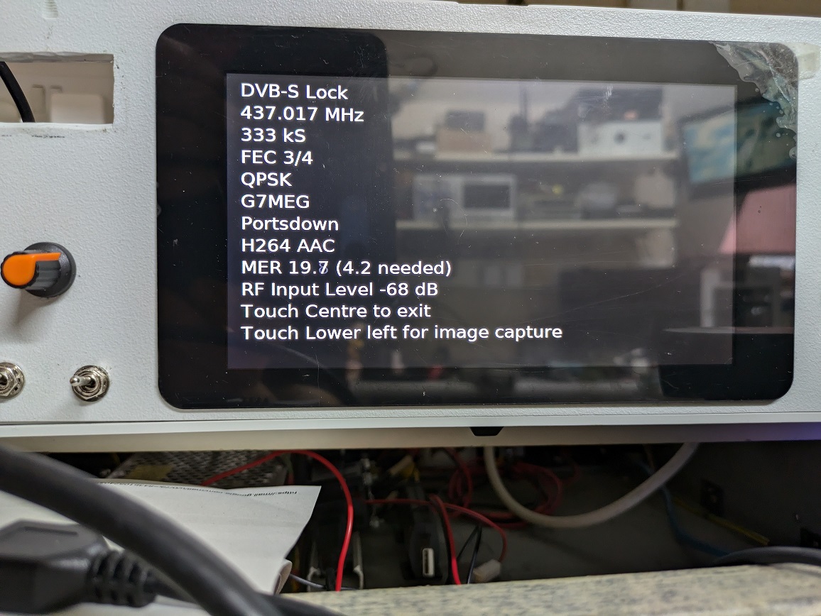

Nim's in and all seems ok (I think!)
Just need to figure out why there is no picture!

Are you actually sending a picture? Test card is a good one to start with. Note, if you get all the metadata from the tuner but no transport stream, it may be several things causing that, but in this case you do have a TS as it knows the callsign, image and audio formats. Therefore I think the most likely cause is that you are not sending an image, or there is a problem with the format being sent not being compatible with the Portsdown receiver selected.
The signal level is very low, but the MER seems good enough. I did notice it is DVB-S and not DVB-S2, but that should not be a show stopper, it would not have locked if it were.
