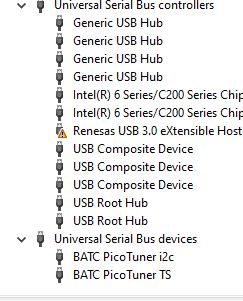

Once PicoTuner is properly installed on Windows 10, it shows up in Device Manager as shown below.
- PicoTuner in Device Manager.JPG (23.62 KiB) Viewed 4980 times

OK, thanks a lot Dave,
That's what I have on my screen as well.
I will try with some subsequent restarts in Open tuner. I will also test different USB as this also could be the problem of not finally connecting.
ON7TU -Lucien
