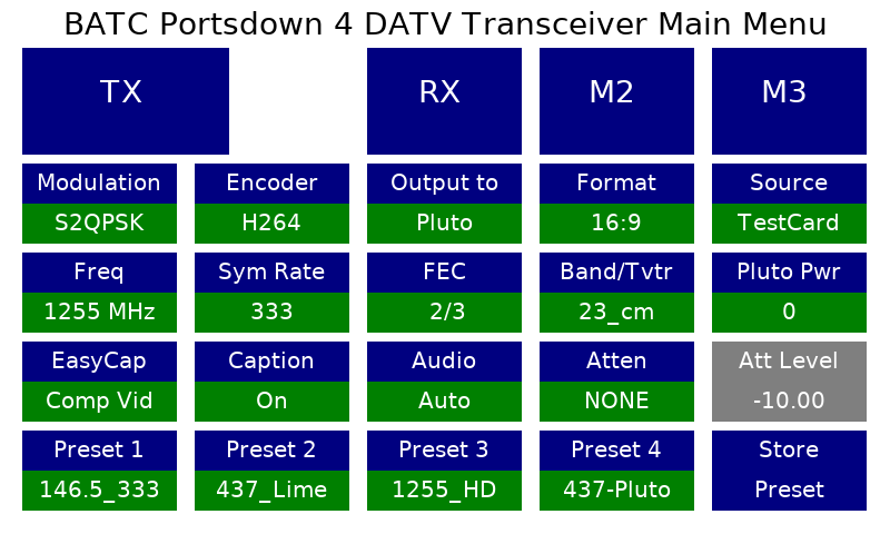

What SR and FEC are you trying?
What Test Card?
Please try it with these settings:
What Test Card?
- Test Card Settings.png (47.54 KiB) Viewed 5804 times
Re: Uitzenden Testkaart
Hi Dave thank you very much for your help I have set everything
up as you show in the picture but unfortunately it does not work with
the test card with the webcam it works great .
the broadcast doesn't work with the contest numbers either
Henk,PE1NCH
