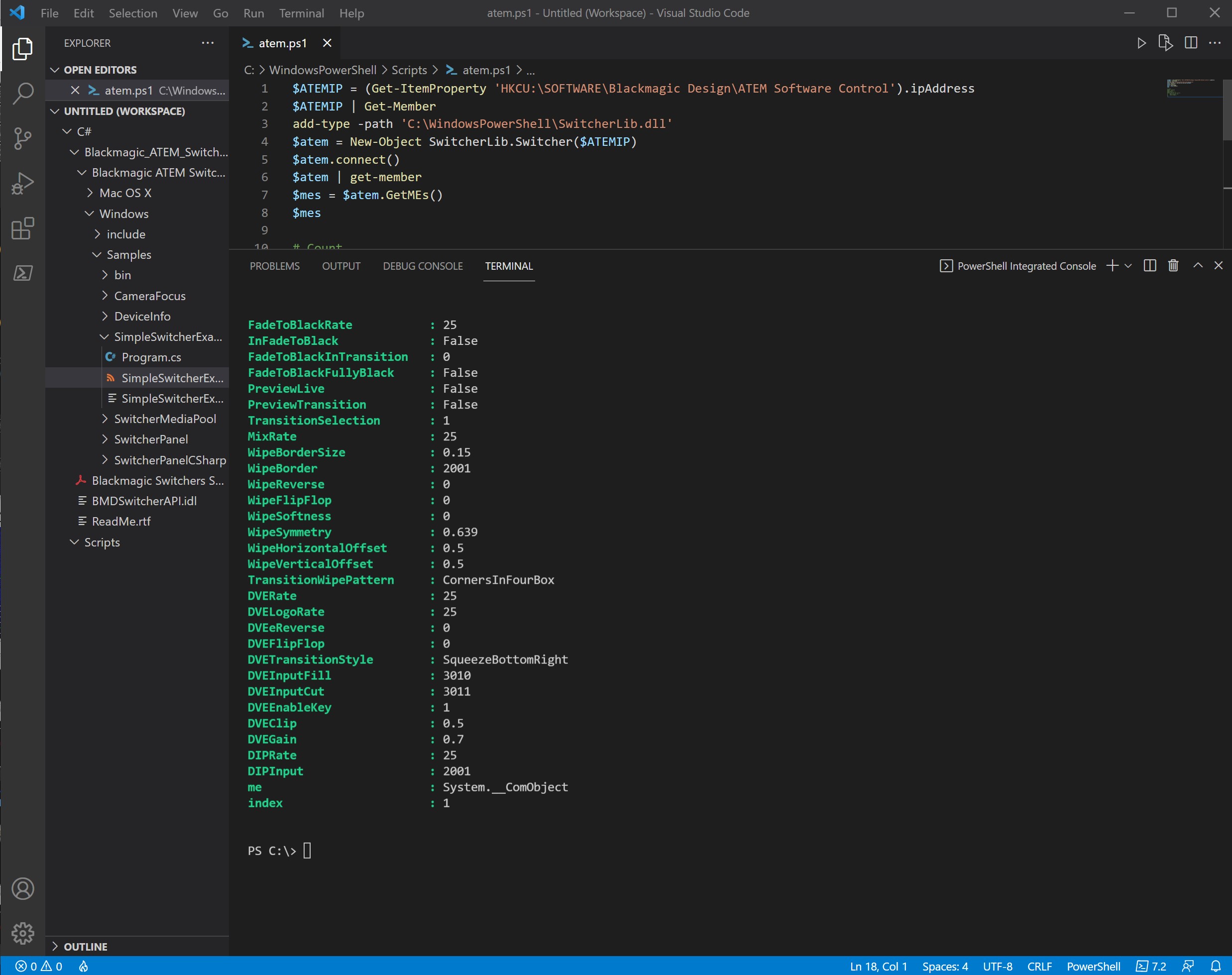

I've been experimenting with connectivity to the ATEM Mini using Node.Red and using Ian Morrish's .dll and MS Powershell. I've got connectivity working for both, I now need to understand the commands to cause switching and transition events to occur. My software skills are not great, but I can usually work out a way to do things.
I suspect node.red might be the easiest, but if someone with software skills could guide me with a few questions so I get started then I should be able to produce something fairly sexy. The questions I have are basic as to how I package the whole thing up and how I can communicate from the Ryde to the controller. I'm thinking if each Ryde or Portsdown sends, say, MQTT to a broker that should be a very straightforward implementation.
If I drill down into the JSON response I can see the current state of the device.

In the picture here is the response using PowerShell:
