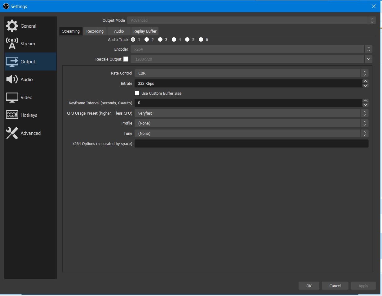

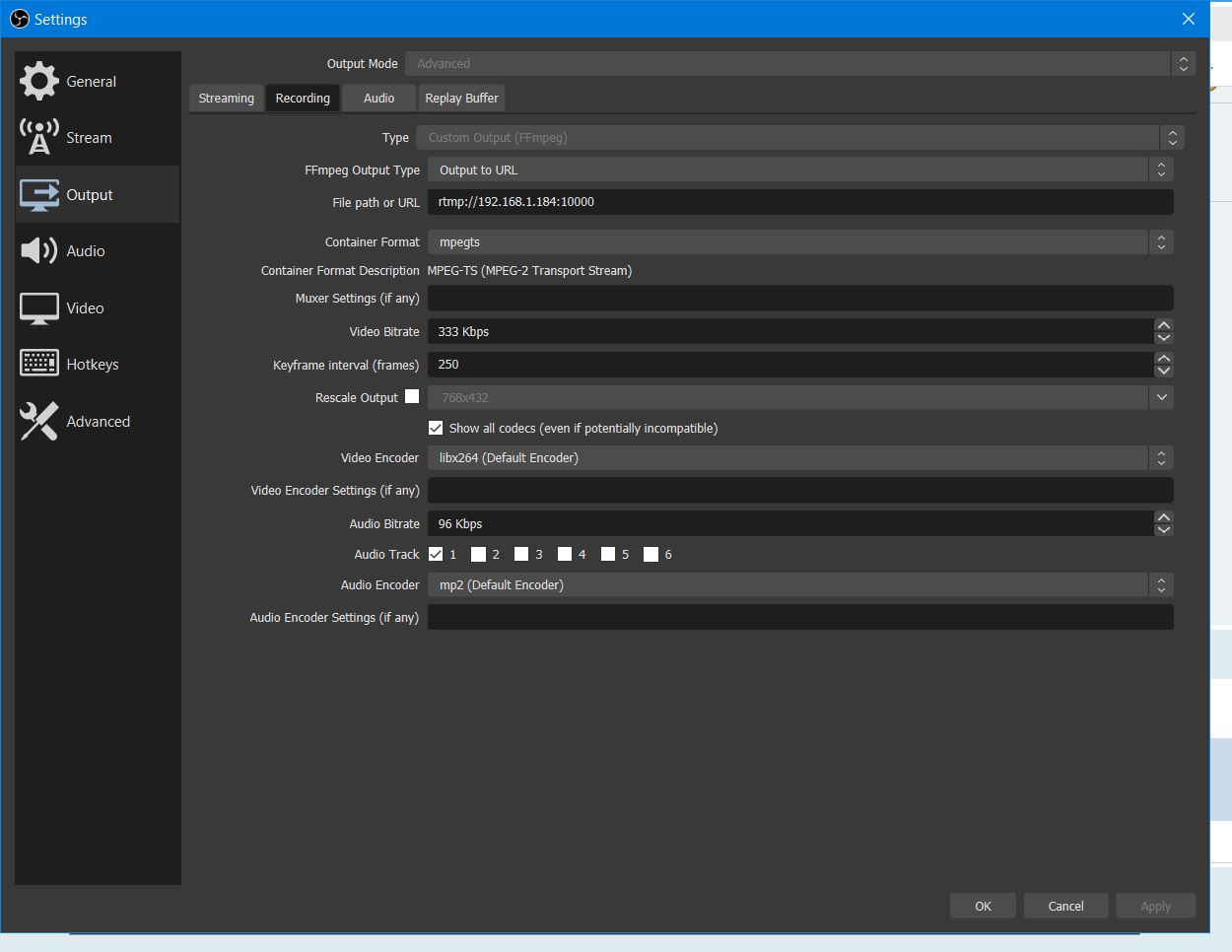

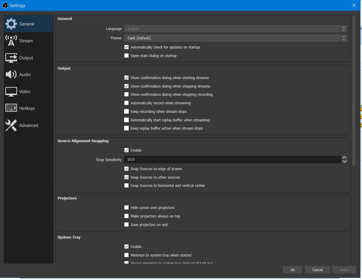

OBS Recording Screen 3 captures in attachements.
- Capture.JPG (100.04 KiB) Viewed 5617 times
- Capture2.JPG (79.81 KiB) Viewed 5617 times
- Capture3.JPG (95.86 KiB) Viewed 5617 times
