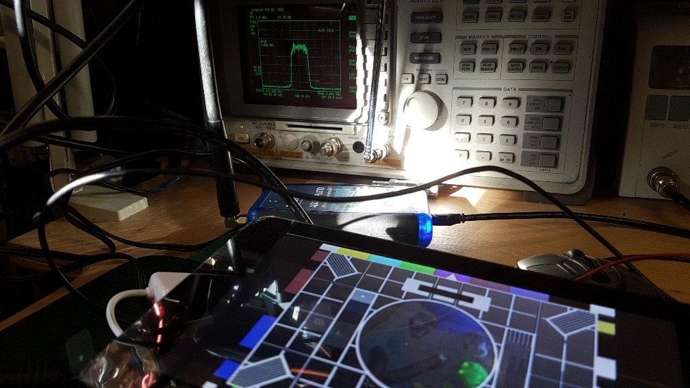

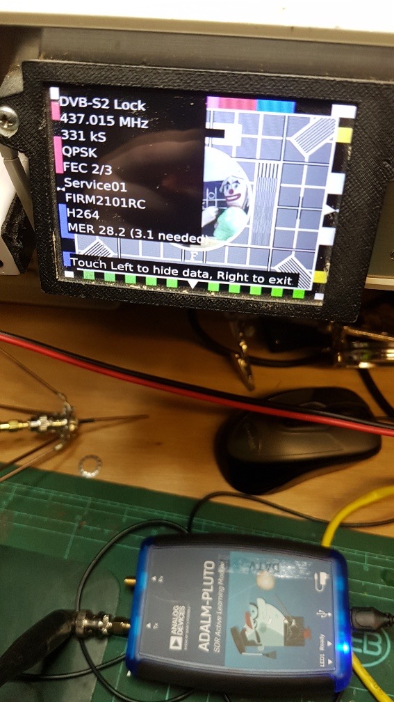

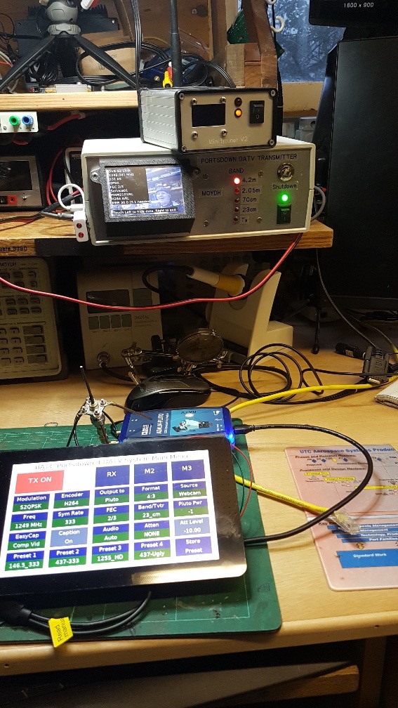

I have received first class help from Dave G8GKQ. I had loaded the wrong version of the F5OEO DATV firmware onto the Pluto. For Portsdown don't follow the instructions in CQ-TV 270 - they're for Windows OBS users - only the Wiki ones work.
It also looked like the three commands that one sends using PUTTY over the serial port that expand the Pluto' s frequency range and number of CPUs hadn't been followed by a reboot command. Portsdown Pluto config reported no AD9364 status and the red update didn't work. So I redid those properly then put the version of the firmware called 'For the Brave' onto the Pluto. The IP address of the Pluto 192.168.2.1 had to be right for the software to work. The other picture is of the characteristic spectrum of a DVB-S2 signal. This did gladden my heart! So far FEC 2/3 437 and 1249 MHz test card and webcam work across the bench. My P2020 receiver was pressed into service because the Minitioune software on the new Windows 10 isn't installed correctly.
