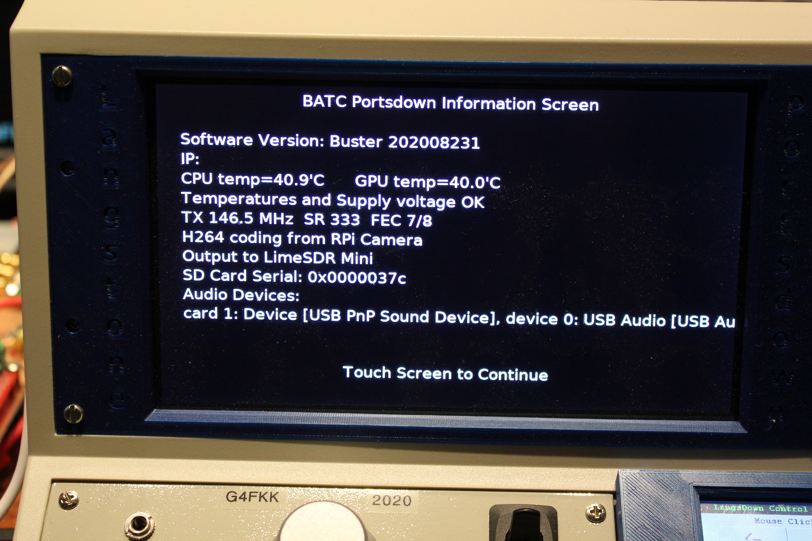

I have just done a new build from scratch and it seems to work. Please could you check the exact voltage between pins 4 and 6 of your RPi 4, and also provide a photo of the info page (from Menu 2). Any other clues as to how you have your equipent set up would also be helpful.

This time I disconnected all the GPIO and sound card and did the install with only the 7" screen and PiCam plugged up. The PD4 install completed ok. I then shut it down and reconnected all the GPIO, sound card and Lime Mini (and not the Pluto). As yet I haven't installed Langstone on this third attempt but doing so made no difference on the second attempt and adding your fix to the second attempt made no difference either. I didn't connect a mouse or my Arduino pseudo-mouse hardware.
When switched to TX the PTT fires but the monitor picture is still freezing and there's no RF from the Lime Mini.
The voltage between pins 4 & 6 of my Pi 4 is 5.06V.
The equipment is all powered from the 'official' Pi PSU. Soundcard is the white one recommended by Colin for the Langstone. The Lime is plugged, via a short USB3 extension, into one of the Pi's USB3 sockets. I don't use a powered hub. The SD card is a 32GB Kingston and is the same type as the one with the build which works (Raspian with A27).
Picture below as requested.
Let me know if there's any further info or tests you might think would be relevant. Thanks very much for taking an interest too.
73, Martin - G4FKK

OK Martin
Please check that you get good Pi Camera images when you select Menu2, Pi Cam Monitor.
What happens when you try to transmit the Test Card?
Not sure why, but also please try when connected to a network. You were not connected in the photo.

I get a good picture on the Menu 2 Pi Cam Monitor.
When I tx the Test Card I still get no RF from the Lime Mini. It's hard to tell if it freezes :) The same happens if I try to TX the PiScreen.

Your last question may be a clue!
The Pi was connected to the LAN when I took the photo. I'm currently watching the GB3TZ stream bu the Info is still reporting no IP!?!

I've disconnected the network and the info is now reporting "IP: Not connected" instead of just a blank. I'm doing a power off/on reboot between these tests.
EDIT: Running ifconfig via PuTTY shows an IP of 192.168.102.114 which is correct for my network.
