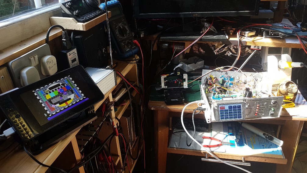

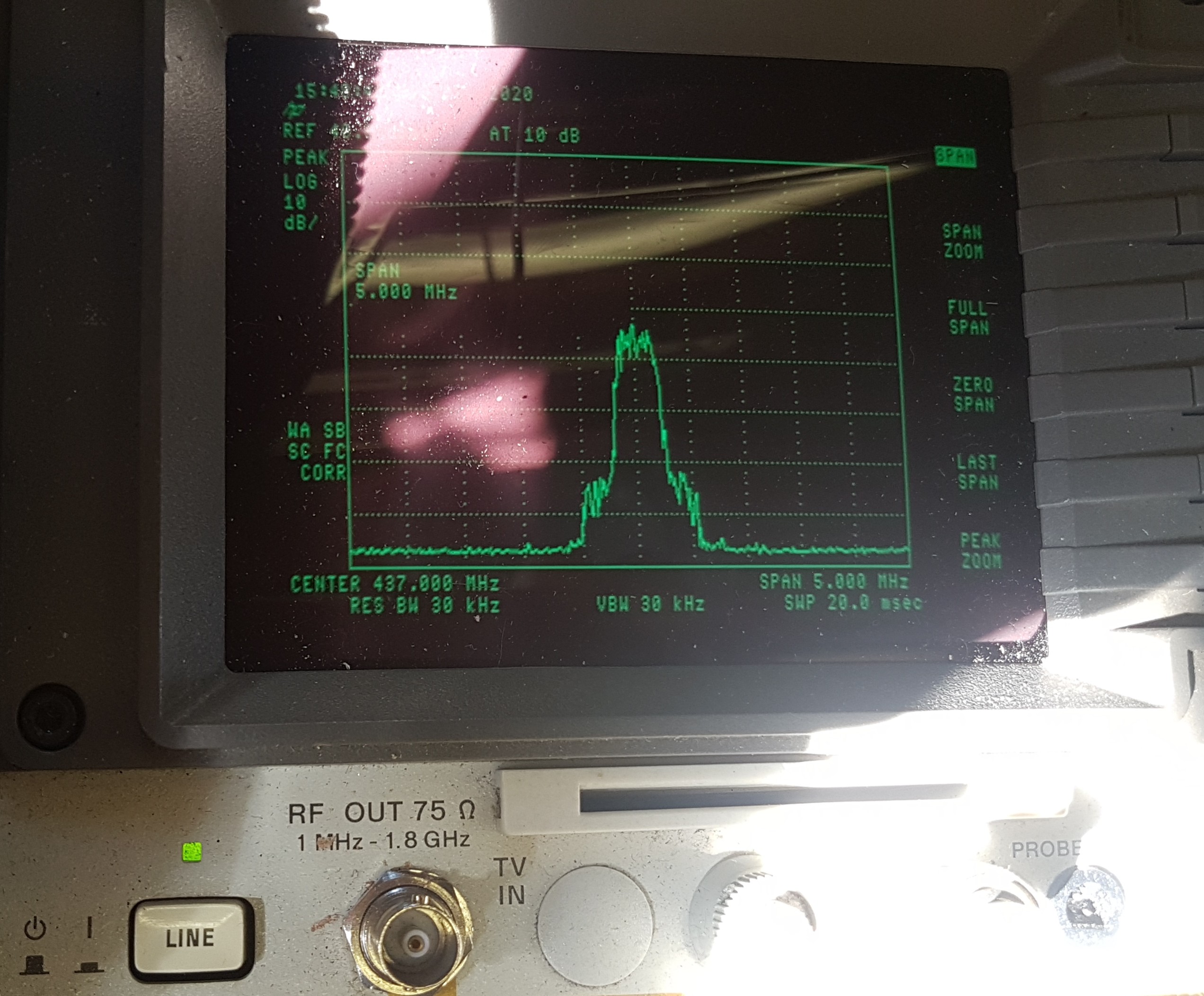

I've made a lash up of my older Portsdown running Stretch 201922100 and the Lime mini and large buck converter from the 2020. I found a powered USB2 hub to use instead of the USB3 hub in the 2020 unit. I've band select and 4 band switch card so can run my rack.
I can get sustained tx of test card and contest number on 2 and 70 in S and S2 but only with the Lime mini setting. Reception is to Portsdown 4 pictured.
I'm somewhat relieved
! I'll try the SD card from the 2020 next and see if that makes matters better or worse.

- Definitely TV
- 20200807_152126_copy_2544x2106.jpg (787.55 KiB) Viewed 4066 times
- A bit of a mess but working
- 20200807_152119_copy_1008x567.jpg (191.3 KiB) Viewed 4066 times
Re: Portsdown 2020 stuck on 4m and not transmitting.
Hi David
Well done! If it's working, I would be tempted to leave it as is. There's no need to use the LimeDVB firmware - I don't most of the time.
