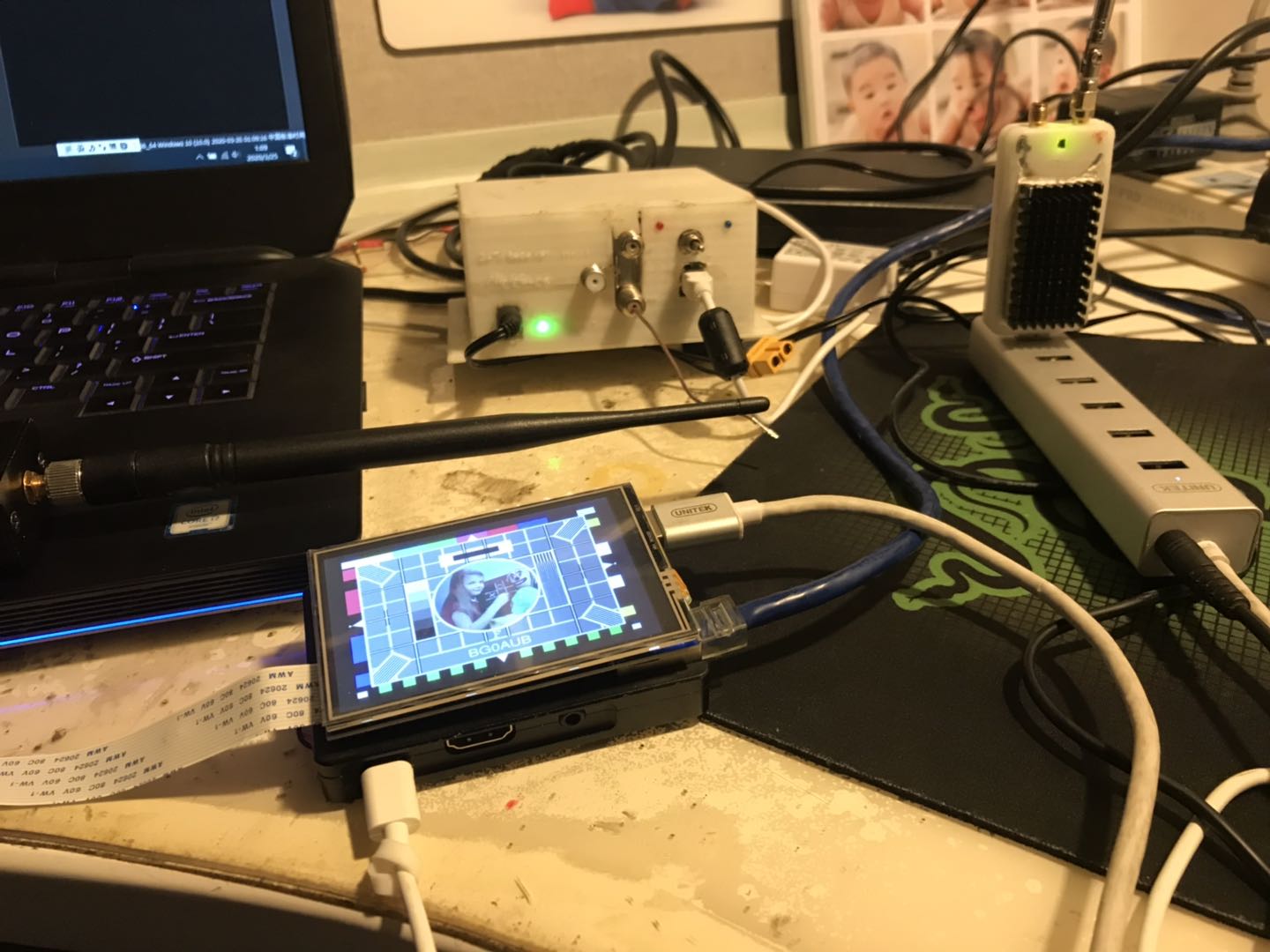

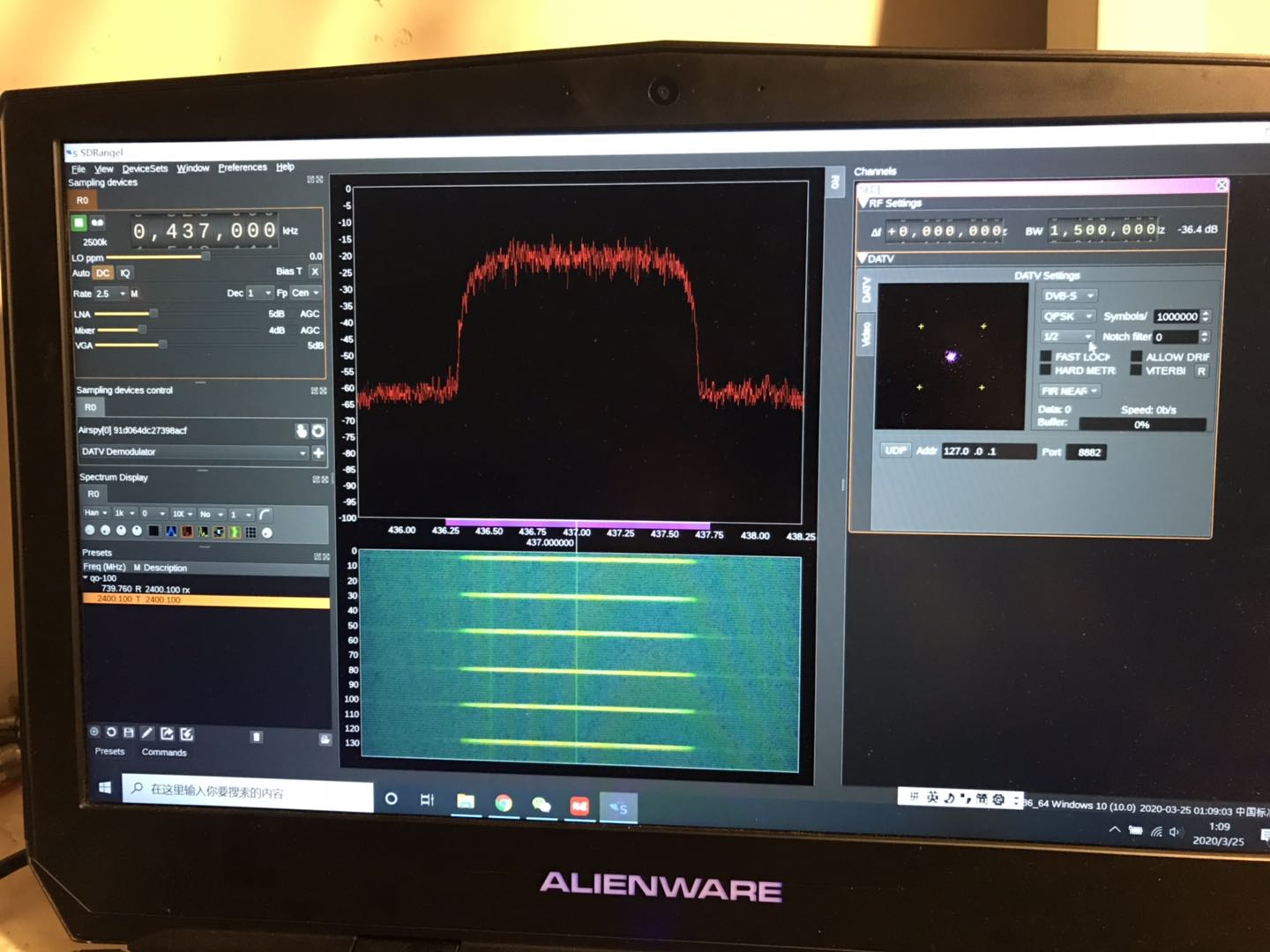

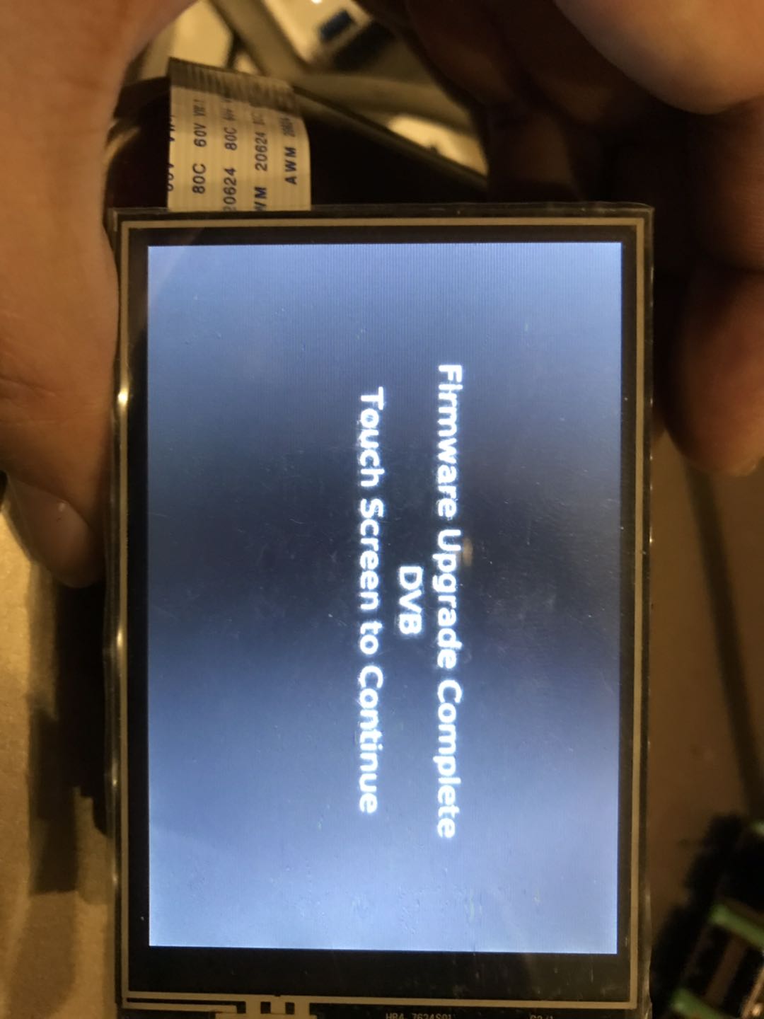

I rebuilt portsdown 2020.Connection limesdr mini, after start transmitting any sr and video source, look from the spectrum signal is always interrupted?
The picture provides some my configuration.In addition must be upgraded to the DVB firmware?I try to use DVB portsdown upgrade firmware options, there seems to be no success

Hi BG0AUB
Have you loaded the the Lime DVB FW on your LimeSDR Mini? Using the button "Update to DVB FW".
Posts: 3028
Re: Portsdown Buster 202003140 - Recommended Build
Post by G8GKQ » Wed Mar 25, 2020 12:32 pm
For BG0AUB
I have just reproduced your problem. It happens when you try to use Lime DVB mode without loading the DVB firmware on the LimeSDR Mini.
Quick fix: Select Lime Mini as the Output Device.
Slightly longer fix: leave Lime DVB selected, and reprogram the LimeSDR Mini with the LimeDVB Firmware.
Please let me know how you get on.

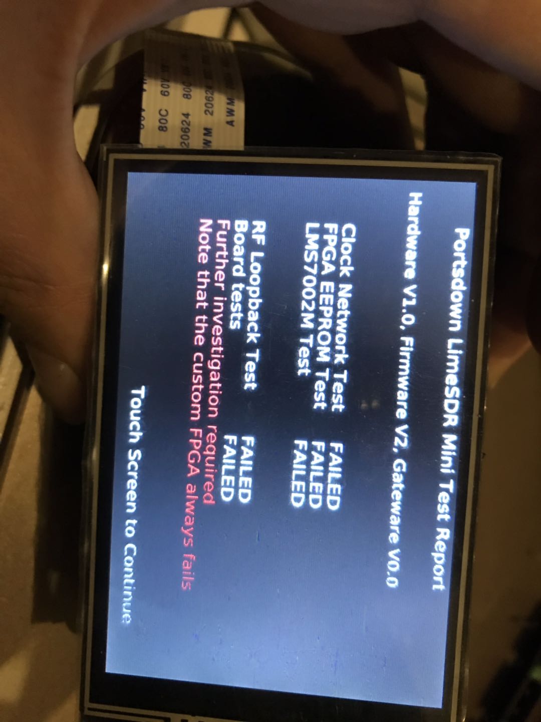

Post by BG0AUB » Thu Mar 26, 2020 4:46 am

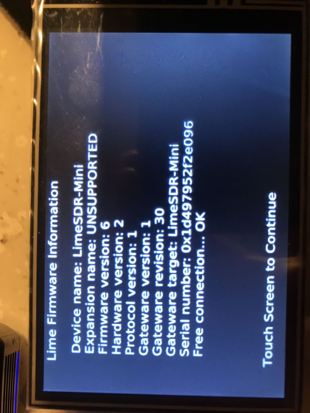

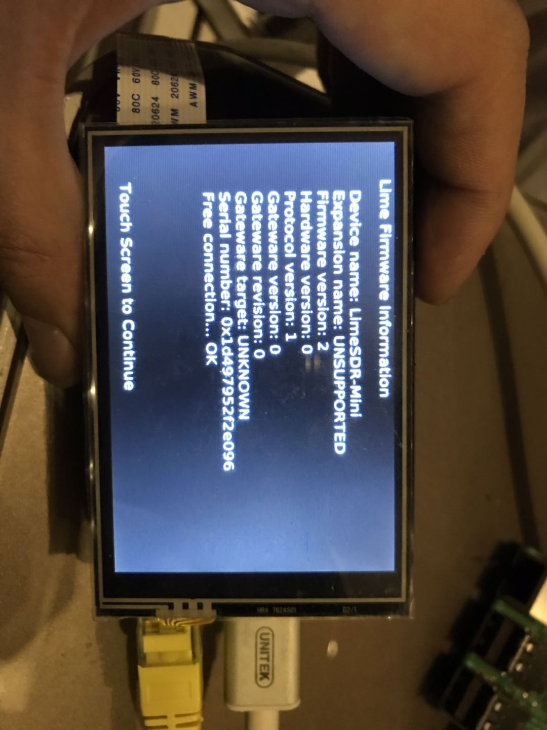

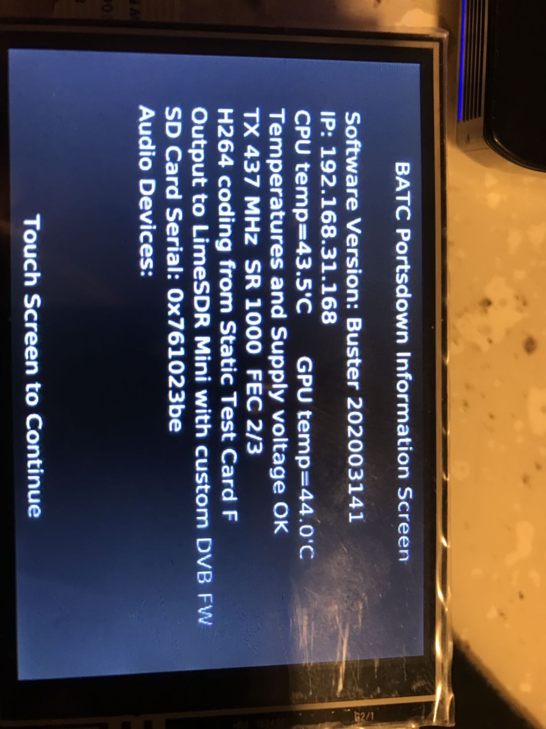

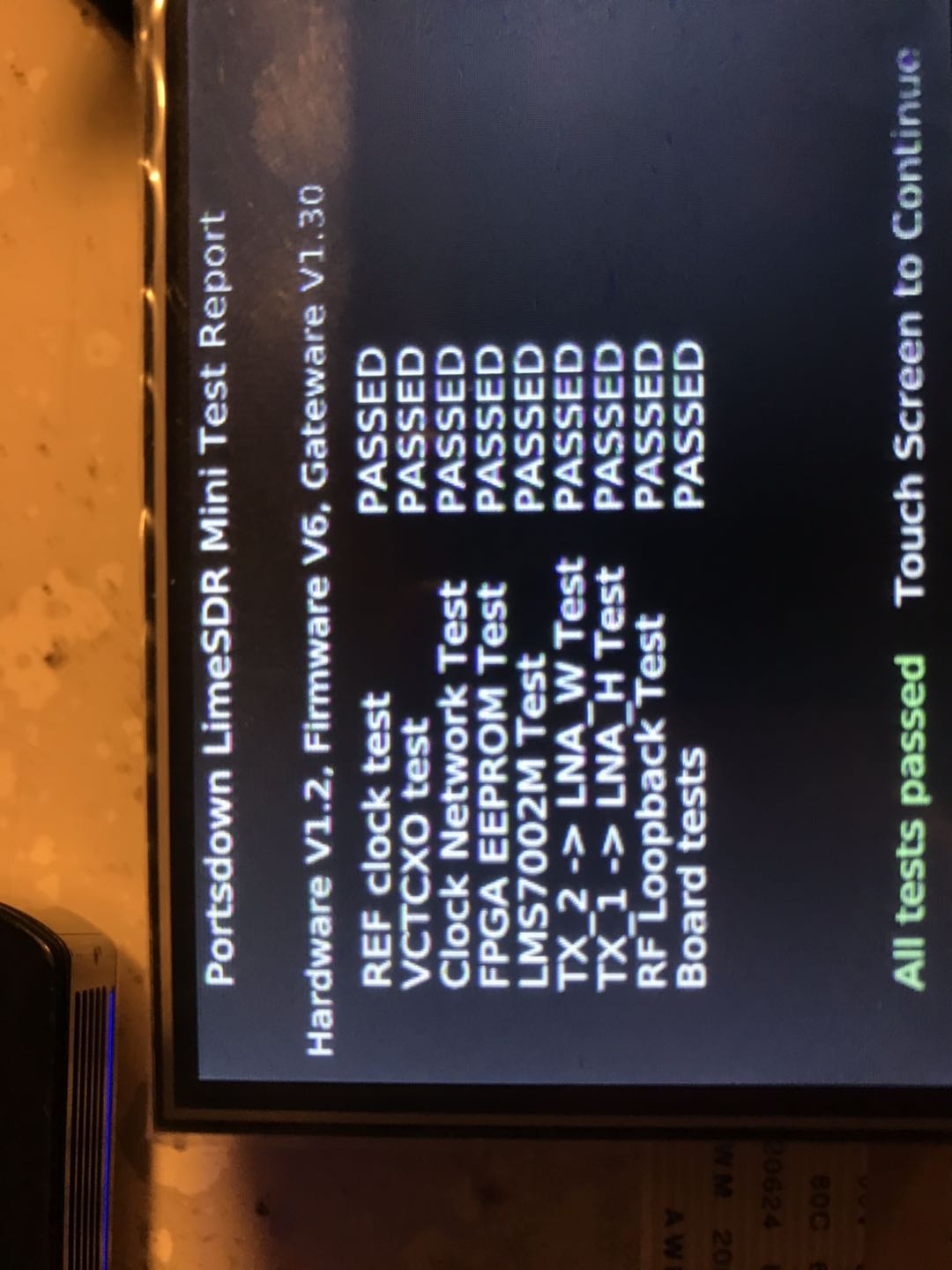

As shown.I tried to update the DVB firmware.In the test limesdrmini page display failure.The frequency spectrum of the test is still intermittent
I always doubt is one of China's network build errors.(though I've used when constructing portsdown proxy service)

Updated firmware DVB when connected to the Internet?
Posts: 3028
Post by G8GKQ » Thu Mar 26, 2020 12:14 pm
Hi BG0AUB
It does not require an internet connection for the firmware upgrade. Check that the file
Code: Select all
/home/pi/.local/share/LimeSuite/images/v0.3/LimeSDR-Mini_lms7_trx_HW_1.2_auto.rpd
is present on your Portsdown
Code: Select all
ls -a /home/pi/.local/share/LimeSuite/images/v0.3/
That's the file it tries to use for the software update.
As another test, reload the Firmware 1.30, and then select Lime Mini as the output device. Does that work?
