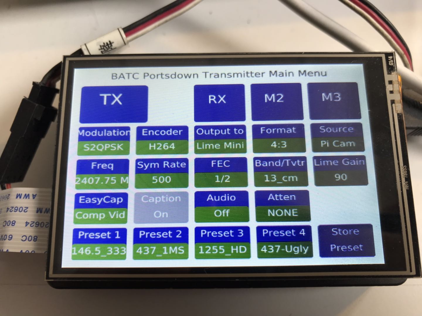

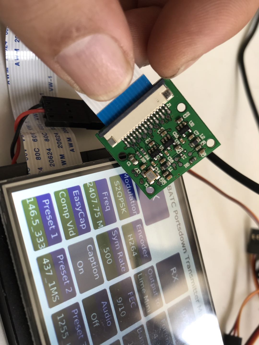

Unless I am mistaken, the camera in your photo is not a Raspberry Pi Camera (it looks like a Waveshare camera). It might be compatible with some modes on the Raspberry Pi (which may be why MPEG-2 does work), but H264 needs a Raspberry Pi Camera V1 or V2. Other "compatible" cameras are not supported in the bespoke H264 encoding software.
Please could you try it with a real Raspberry Pi Camera and let me know how you get on?

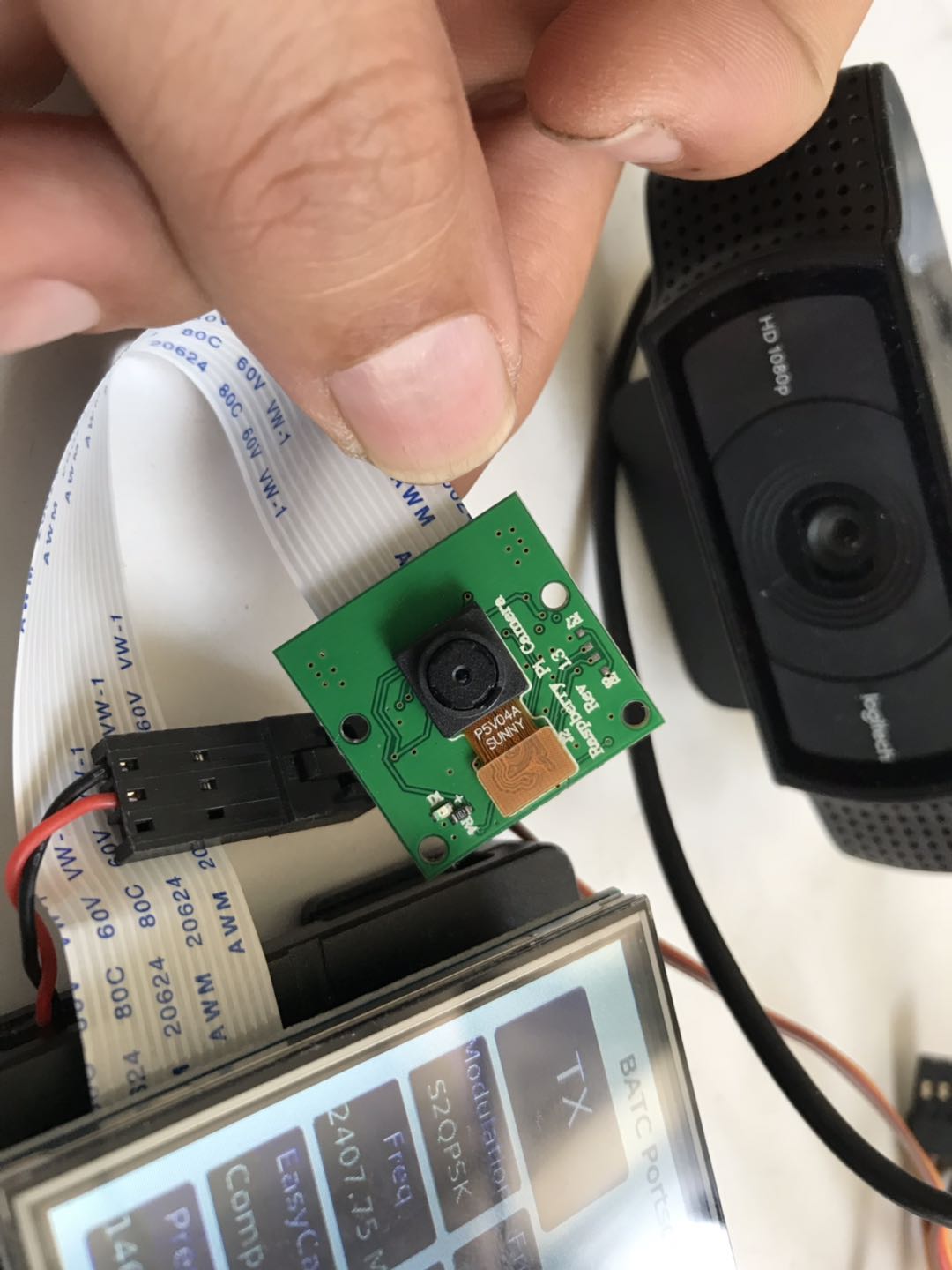

Maybe that's the real reason.I dug up a picam in the parts box, but I'm not sure if it conforms to H264.Can the C920 camera be tested?
zhaofeng BG0AUB

That PiCam v1.3 should work.
The C920 does not work particularly well for H264 with the LimeSDR at the moment, but we are working on improvements. To test it, you could try selecting "WebCam" as the source (NOT C920) and running H264 333KS 1/2 FEC. That works for a minute or so before it has problems.

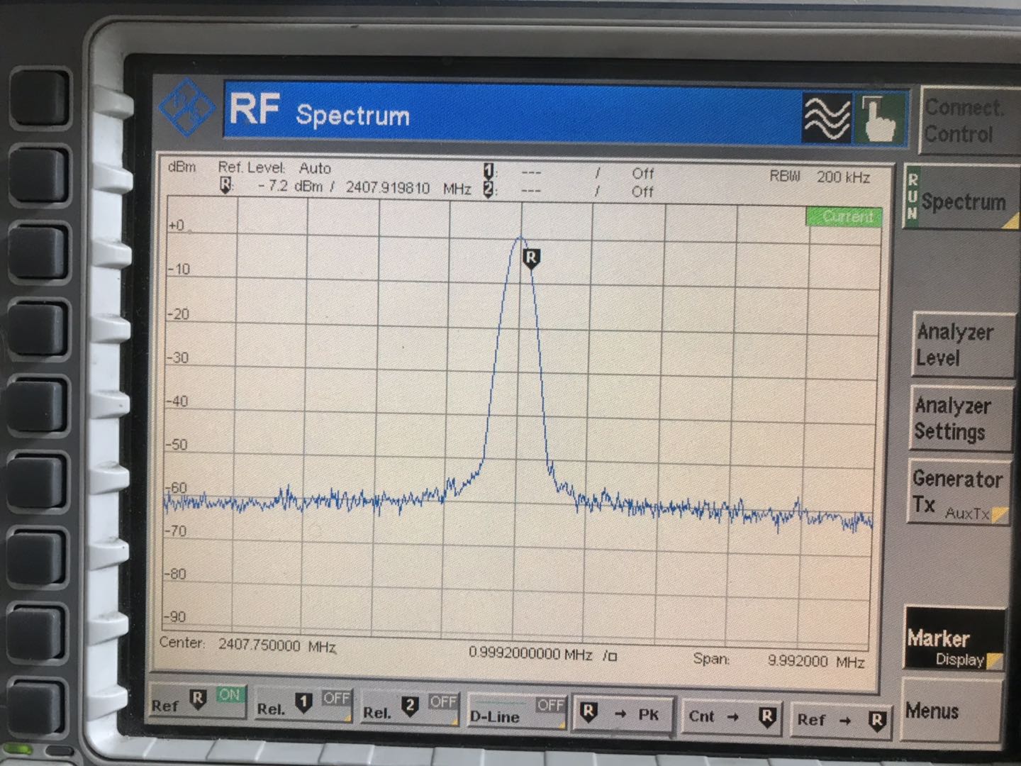

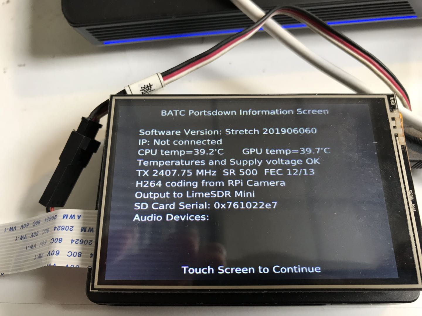

Bad news.Still no solution.I decided to recompile the SD card once in the test.

When you select transmit, does the Picture from the Pi Cam appear on the touchscreen?
Re: Portsdown2019 H264 mode will not work
Picam is chosen as the signal source, MPG - 2 mode, the LCD display a preview image.H264 mode, no picam preview image.Only Portsdown logo image
