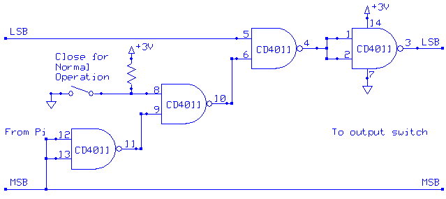

Here is a bit of logic to eliminate accidental 70cm/23cm selection by the transverter switch. Other Nand gates could be used.
The resistor can be anything in the neighborhood of 10K.
A software method of using the 4M port for the transverter could be done with one additional output from the Pi for the RF output switch LSB.
4M tranverter output.PNG (7.26 KiB) Viewed 3850 times

Hi Adrian
Yes, with a slight rewriting of John’s logic, it should work with the attenuator logic as I currently envisage it.
