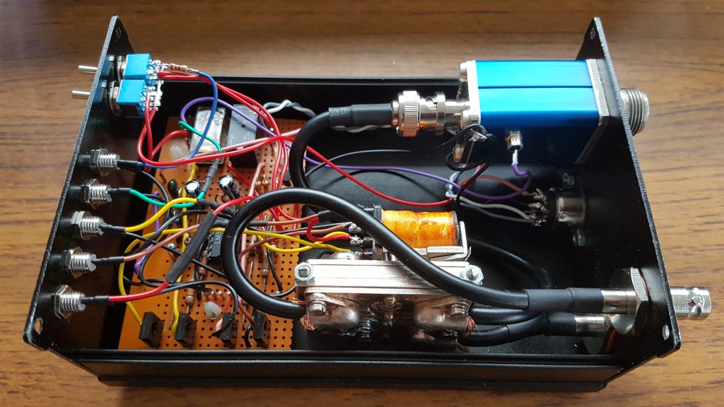

Posts: 347
Re: Developing the G8ADE sequencer [CQ-TV 125] for Portsdown
Post by M5TXJ » Tue Jan 09, 2018 12:33 pm
Some pictures of my sequencer as promised. I'll draw up the circuit at some point this week.
73 Dave

M5TXJ
Posts: 347
Post by M5TXJ » Tue Jan 09, 2018 8:22 pm
OK here's the circuit diagram - not showing the coax relays (don't forget back emf diodes) or the on off switches (power and preamp power). I'm sure you can work the rest out for yourselves. As seen in the photo's I just used veroboard.
73 Dave
