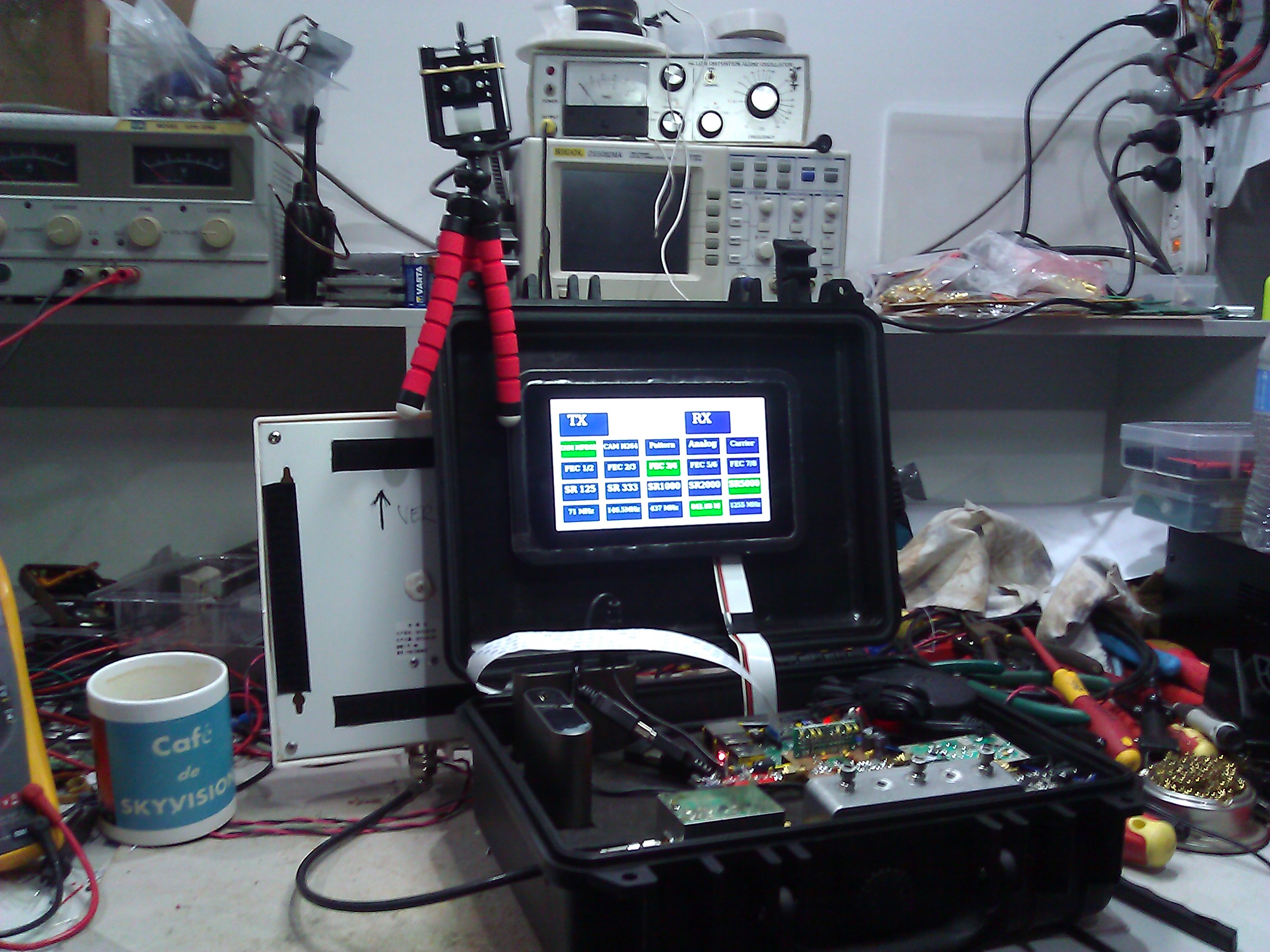

The Ports Down-Under with 7" touch screen
Post by VK5YYY » Fri May 26, 2017 1:55 am
Thanks for your kind words Ken
The Ports Down-Under was demonstrated at our National Ham get together last weekend, hence the case
I'm not sure the HF crew actually knew what they were looking at (not for want of telling them) HF won't keep our hobby alive in my opinion
The case was left over from a hand held CB twin pack with the foam on the inside turned upside down with cut outs to hold everything in place
Overall it's it's quite cutting edge, the double conversion technique is common in commercial equipment and gives a couple of stabs at filtering
The 7" screen was born out of necessity as that was in the cupboard, it doesn't actually suck much current
It runs on 5V from Orico 10400mAhr power bank $36AUD, it's powered by the micro USB and the GPIO which is more stable (red light doesn't flick)
The power bank has a internal limit at 2.3A which is similar to the Pi on board resetable polyswitch fuse
Next job to figure out how to get a watt or two out of it with 5V, I'm guessing will have to employ a buck to get up to 12V, which will be noisey
Has anyone got any suggestions for a 5V, 1 or 2 watt 23cm amplifier?
Cheers Roger VK5YYY

Yes I was able to get the 7 inch screen from Element14 (order code 2473872) to work with the Portsdown Project, I did not have to download any drivers so yes they must be part of the latest Jessie builds. The 7 inch screen connected to the Pi's Display port not HDMI using a 400mm flexible flat ribbon cable (the one supplied with the screen was quite short as the Pi is expected to be mounted on the back of the display, A Pi camera ribbon cable is a bit longer that may help get you started), and the touch screen data connected to the GPIO port pins 3 and 5 (along with power pins 4,6). Dave has made a modification to the Portsdown Project that corrects the rotation of the Touch screen with respect to the Display orientation.
