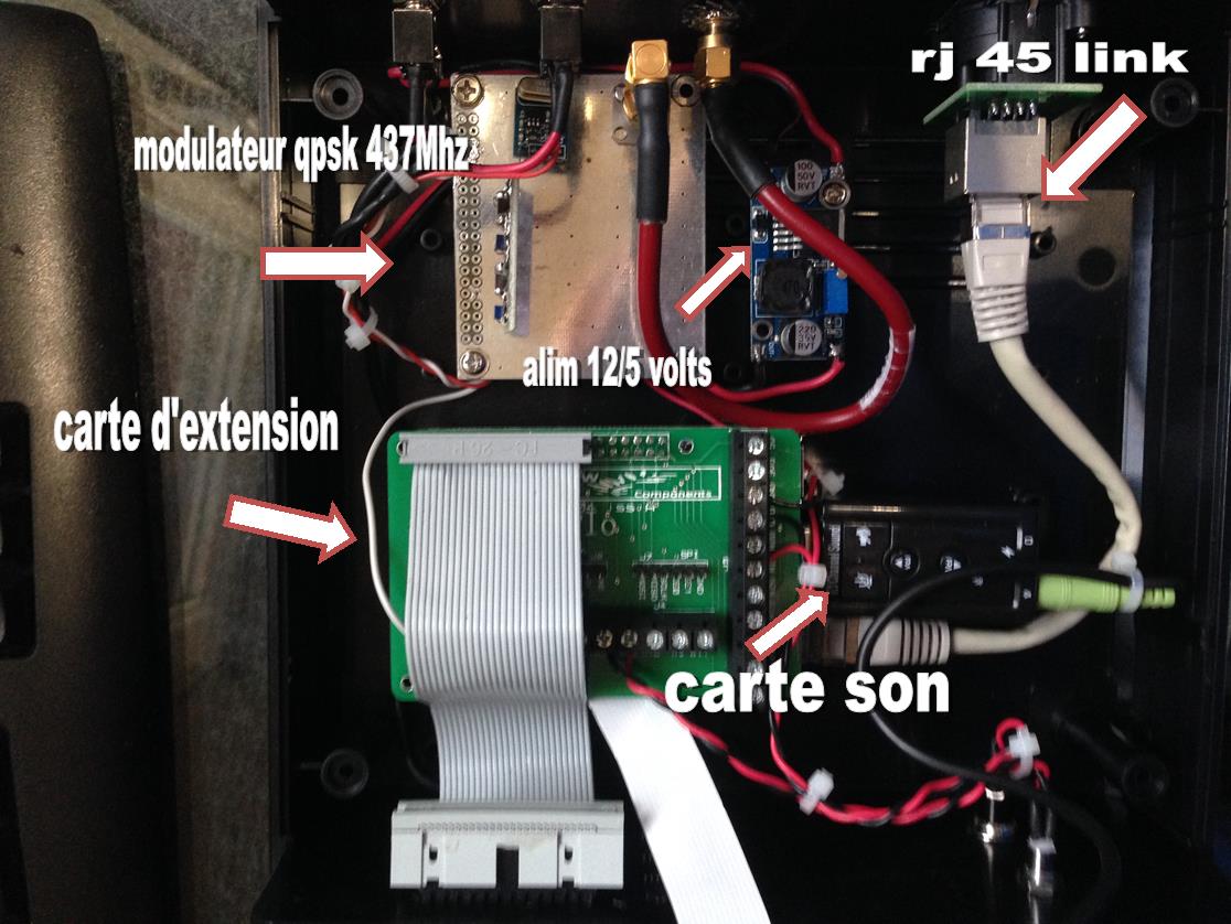

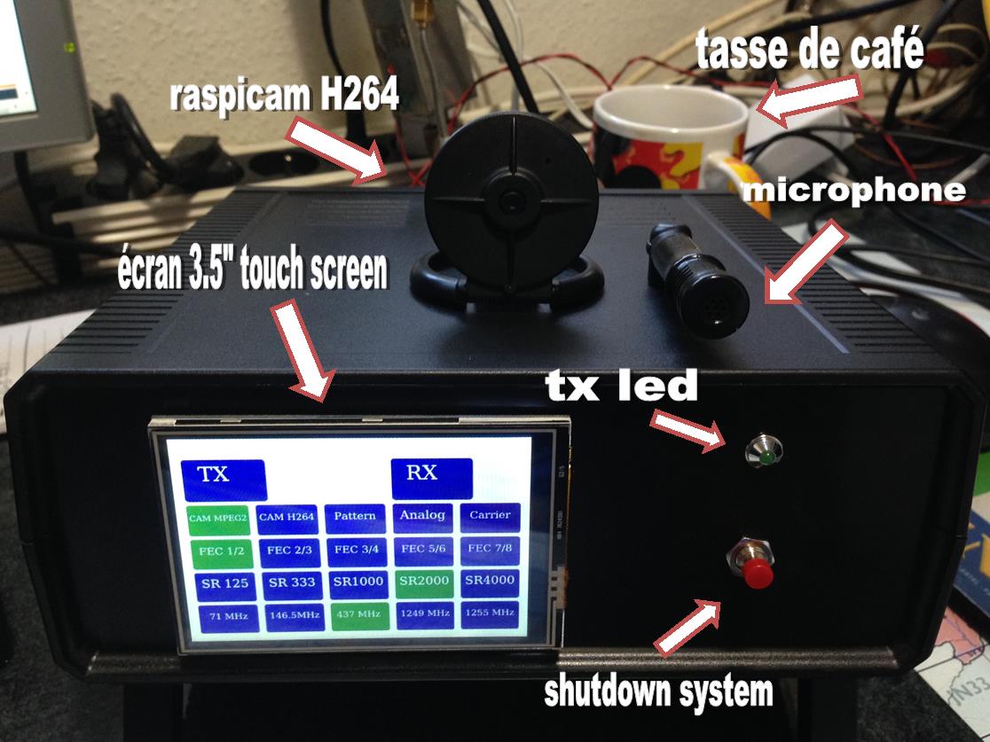

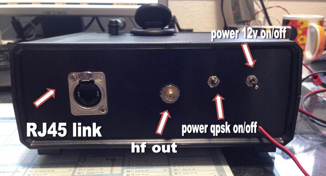

Hello everybody,
I have done a light version of the wonderful Portsdown digital transmitter (only 437 Mhz) for now but how is my pleasure to show you the result :
many thanks to all for your help !!!! but the adventure will be continued :)

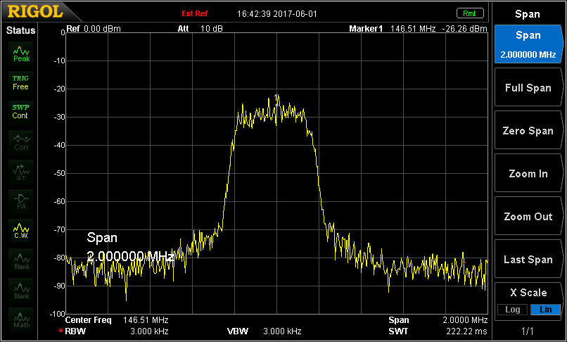

Mine is up and running, just waiting for a few bits to finish the PA for 146.5MHz and I am waiting for an enclosure for the touchscreen from a 3D printer to mount it on the case front.
Mark
G0MGX

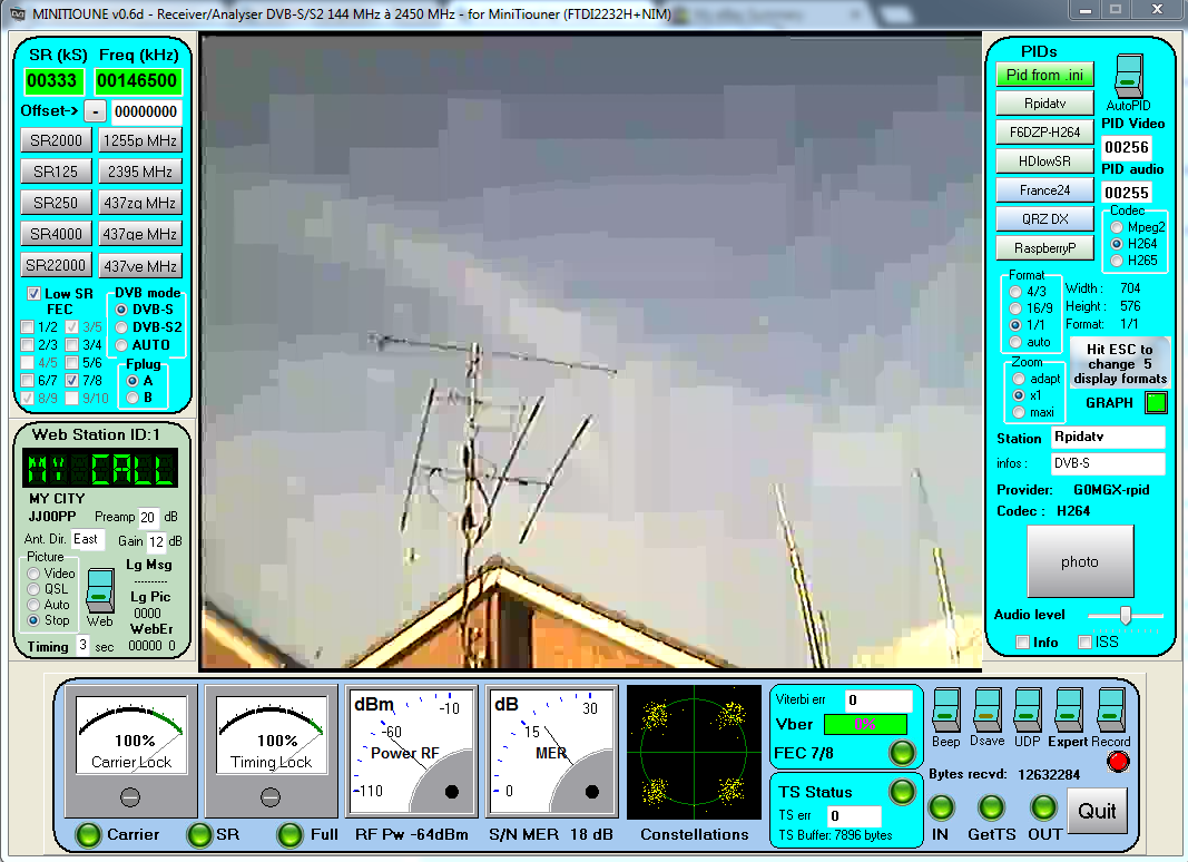

Signal 146.png (25.19 KiB) Viewed 8680 times
AntennaCam (1).PNG (299.62 KiB) Viewed 8680 times

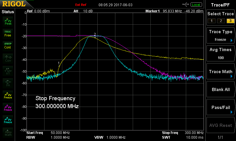

Hi All,

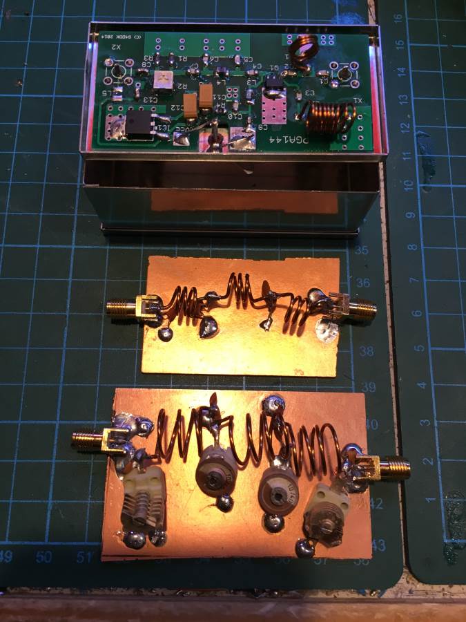

I've now completed a BPF, LPF and a PGA44 preamp from 'DDK:
http://g0mgx.blogspot.co.uk/2017/06/fil ... lters.html
I can provide build details of the filters if anyone is interested. The PGA144 is a tiny bit low in frequency which I need to address - but I think it will be OK for the time being.
Mark
G0MGX

g0mgx
Posts: 34
Joined: Sat Dec 31, 2016 7:57 pm
Re: Success Stories
Post by g0mgx » Sat Jun 03, 2017 8:06 am
The filters look pretty good.
The Yellow is the PGA144 with 20dB attenuation on the tracking generator - so the gain is 20dB. The notch is supposed to be 98MHz but mine is at more like 92MHz so it's all just a little bit "low" but will be OK as-is I think.
The Blue is the BPF and the Purple the LPF.

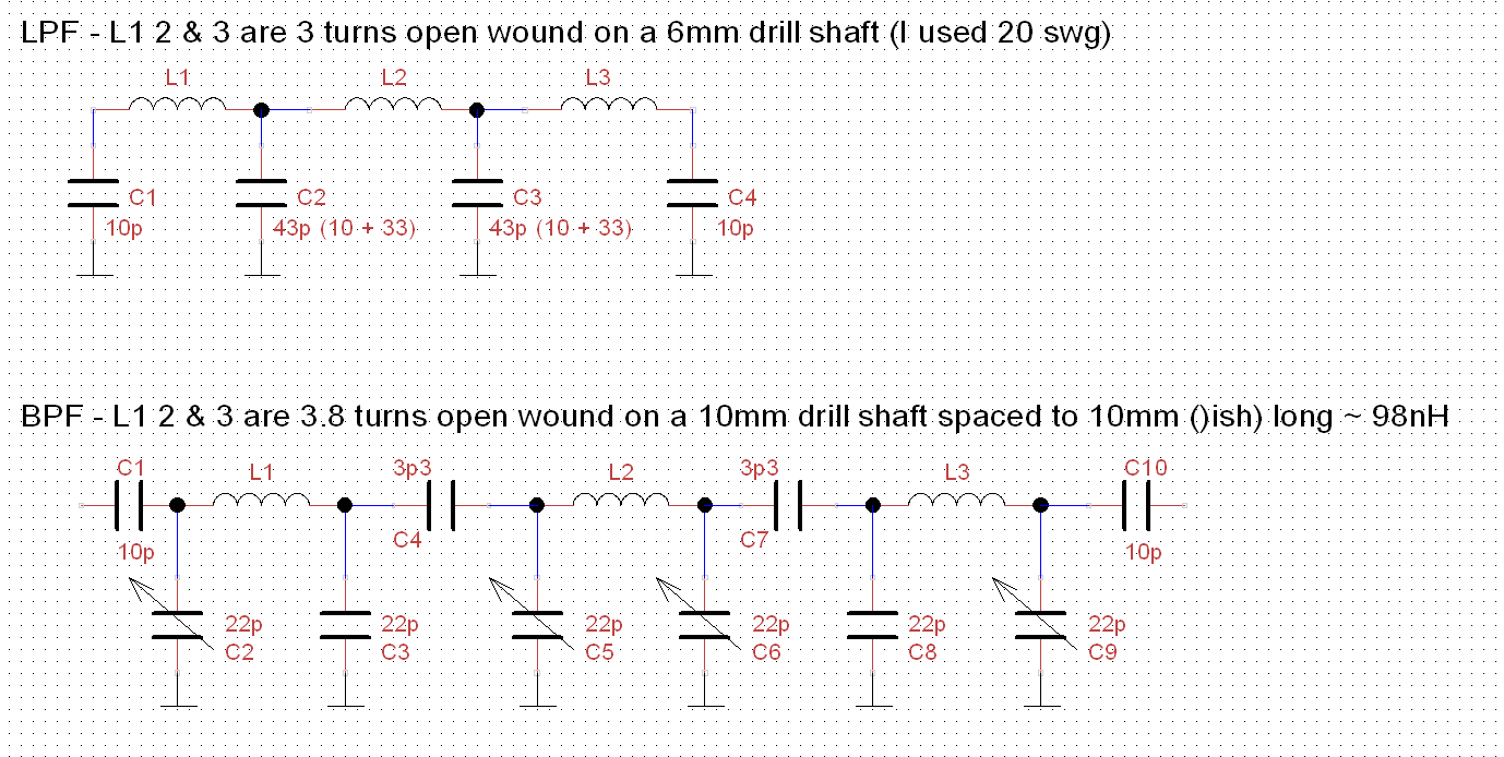

I'll draw a quick schematic of the filters and post them here.
Mark
G0MGX
g0mgx
Posts: 34
Re: Success Stories
Post by g0mgx » Sat Jun 03, 2017 8:24 am
Filters:

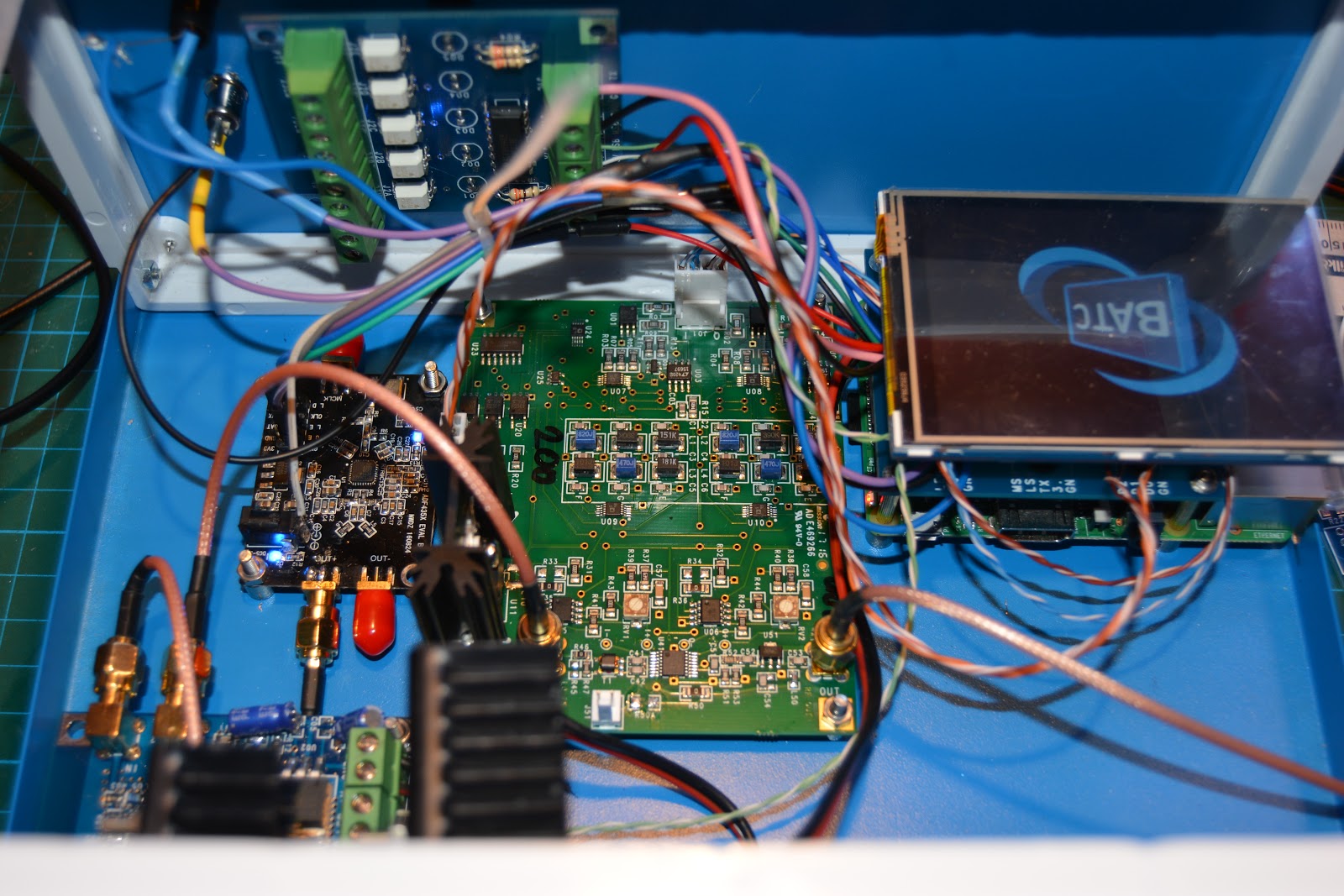

I have mine nearly working now it is in a case. At the moment, the 2m performance isn't good, I can't demodulate the transmissions. 70cm is better and 23cm good. Performance improves at higher symbol rates. 70cm 333ks has a wide spread in the constellation, so time for trouble shooting. I am concerned the switching PSU I used may be injecting noise onto the power lines.
Incidentally. I had not updated for some time. When I came to test after updating I had a few issues. I used the reset to defaults option and this fixed it.
I will post a picture. We need a better way to mount the touch screen - that has proven the most difficult part of the project. My first screen didn't work properly for touch.

Post by G8GKQ » Sat Jun 03, 2017 9:49 pm
Are you using a new Serit tuner? You might want to check that your phase noise problems are not in the receiver first. Put a 10dB pad on the tuner input and see if it improves matters at 70 cm and 146.
Yes, I'm about to need a bezel. Flat to an Aluminium panel. Has anyone on the Forum got a successful 3D print design for this?
