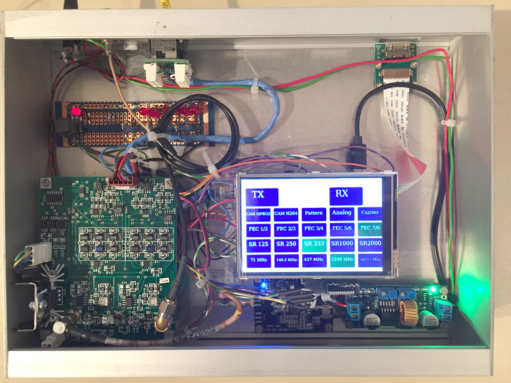

Sorry to keep you all waiting, but we wanted to make sure that this project has most of the bugs ironed out as early as possible. I have put the first prototype in a box, and have some facts and figures that I can publish. Here's the way that I have mounted it:
Demo Portsdown.jpg (229.73 KiB) Viewed 10381 times
The modulator board measures 95 x 79 mm and has a 5v linear regulator that needs some heatsinking. The board itself draws around 250 mA, so the regulator dissipates 2 - 3 W in normal operation. The heatsink in the picture above is not big enough for 12 V operation - I'm currently using a 9 V supply. I used a switching regulator to supply 5v for the RPi and Synthesizer, which added another 500 ma or so to the total current consumption at 12 V. I have left space in this box for an EasyCap analogue video capture dongle, a USB sound dongle and an RTL-SDR for the bonus receive capability. These will all add to the current consumption, but I do not see it getting over 1 Amp at 12 V.
Output from the modulator board depends on the band (71 - 1255 MHz), but is in the range 1 - 10 mW (0 to 10 dBm). QPSK MER measures at 31 dB on MiniTioune V0.4c. Video latency is lower than previous projects, but sound is still a work in progress for the H264 modes.
I am mounting all the connectors on the back panel, including an HDMI socket (physical standard only - they're not HDMI signals) for the RPi Camera, RPi network connection, 12 V input and RF output. I also plan to mount a USB (extension) socket, video and audio inputs and an RTL-SDR receive input. I will tidy the wiring and remove the LED indicator board when the testing and build is finalised! Note that I have left space to allow the Micro-SD card to be swapped out from the RPi (to the right of the touchscreen). The modulator board is raised from the box base to allow access to the RPi Network and USB connectors.

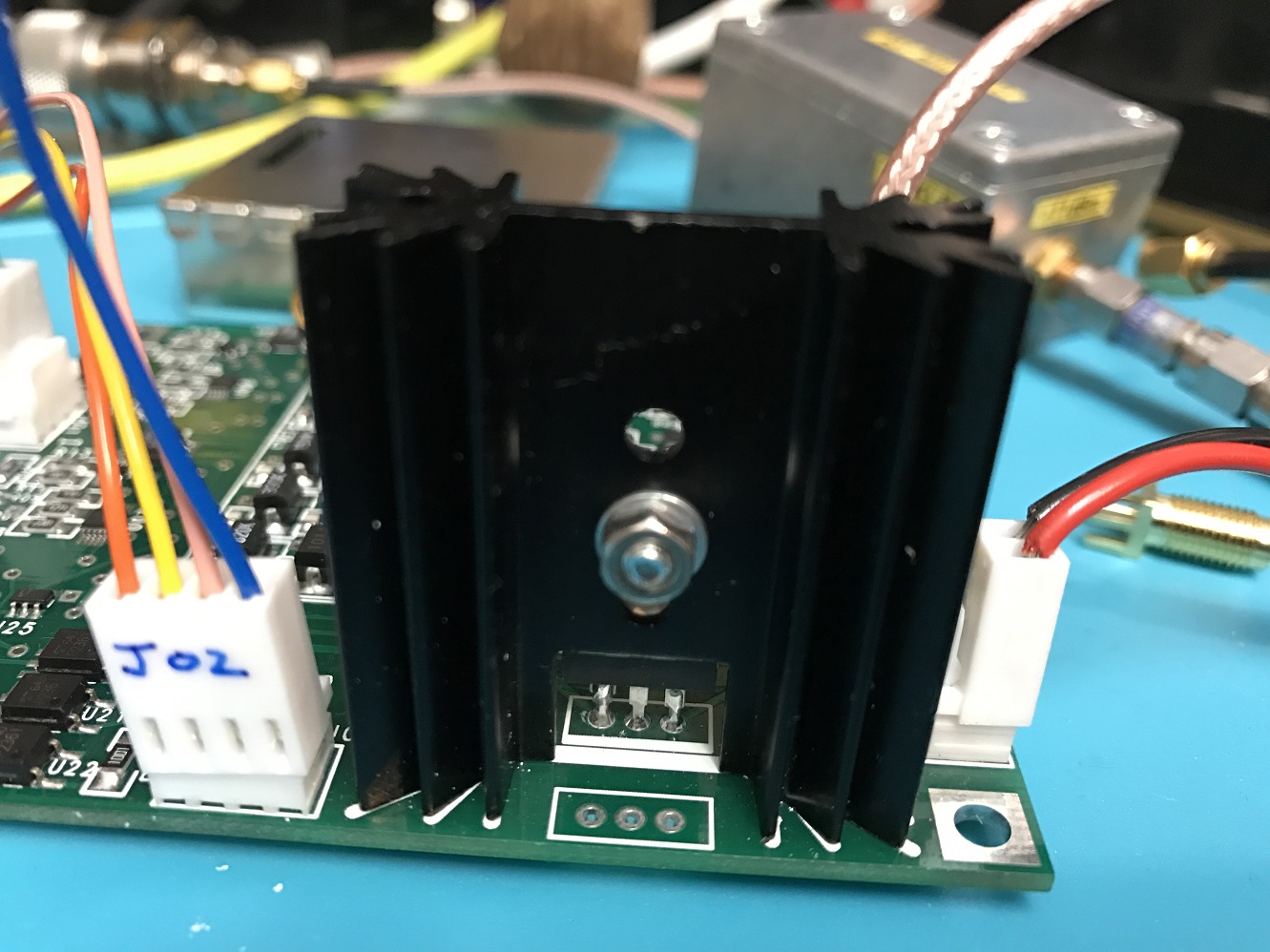

The heatsinks in the parts list are designed to run on a typical portable voltage of up to 14v input but are fairly large, the one in my photo below is the small one.
There are multiple ways to fit a heatsink, there are alternative pads on the edge of the board for fitting a regulator to a chassis or laying it down flat if you don't want to use the large heatsink.
The current isn't all that large but when dropping say 9V there is a fair amount of heat to dissipate (as I say the ones in the parts list are fine).
I have used a switching power supply set 2V higher than the the regulator on all my recent projects, a small heatsink can then be used or in some cases none at all.
