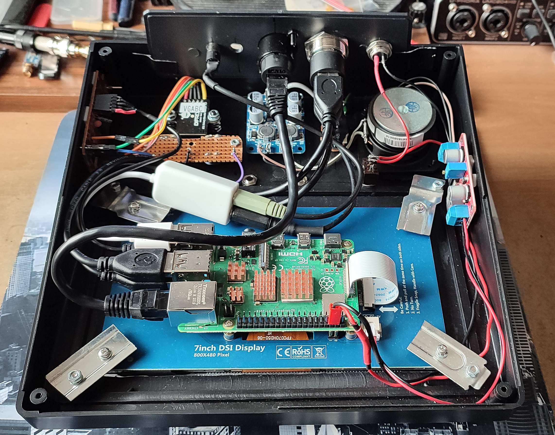

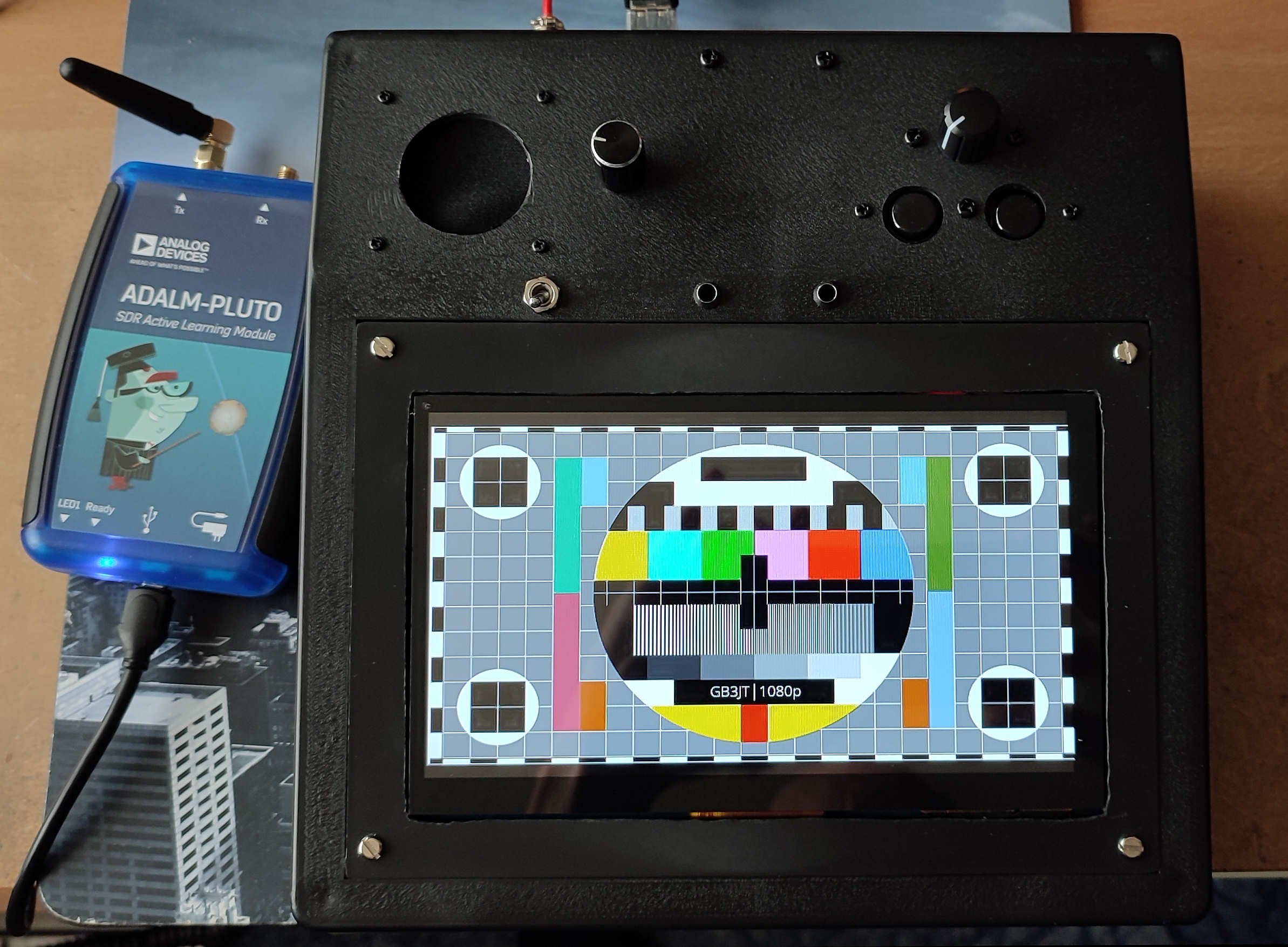

FWIW, this my Portsdown/Langstone built into the case previously mentioned, obviously with the Pluto external.
As you can see, my cutout skills for the touchscreen aren't great... :roll: Not essential, but I wanted a grille over the speaker cutout, I've yet to find anything suitable.

If it works...use it :-)
Aluminium bodywork repair mesh makes reasonable speaker protection as you have 4 fixing screws for it already. https://www.ebay.co.uk/itm/373396391323
Great to see more building :-)

Thanks again Gareth, that should do the job.
