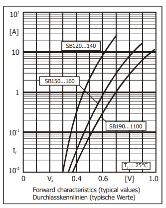

:) No, well not quite no. Each diode has a curve and the voltage drop depends on the current, so for example the aforementioned SB130 diode:
Screenshot 2024-12-10 113717.png (35.91 KiB) Viewed 4631 times
drops 0.45V at 1A but only 0.4V at 300mA so there is a little difference. In F1 that would matter, but here, not really. Also note the higher voltage diodes drop more for the same current. That matters with a switching regulator, don't over specify the reverse breakdown voltage.
