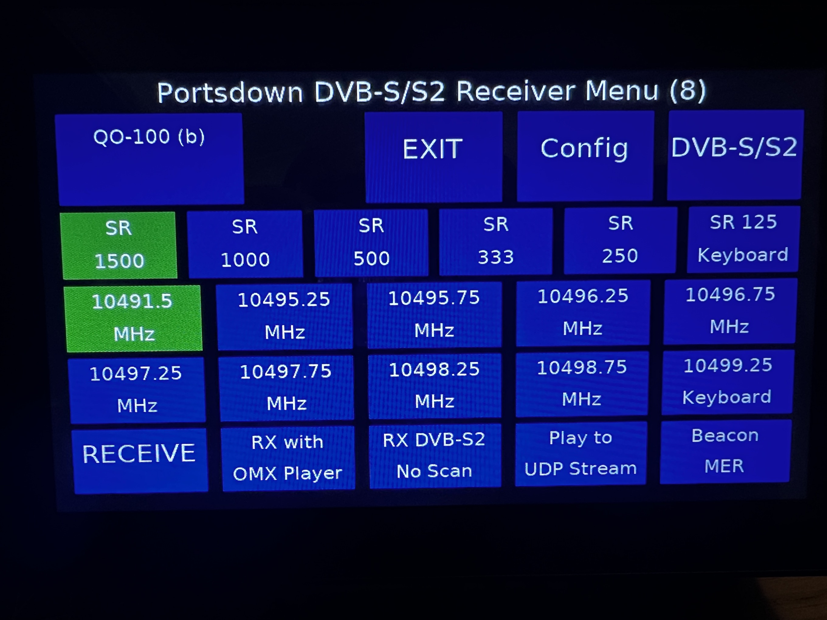

I have built a Portsdown-4, a PicoTuner and added my 90cm dish and LNB.
From what I understand when I hit RX followed by RECEIVE it should change screens and end up showing the QO-100 beacon, but instead I end up at a grey screen. What have I not setup correctly please?

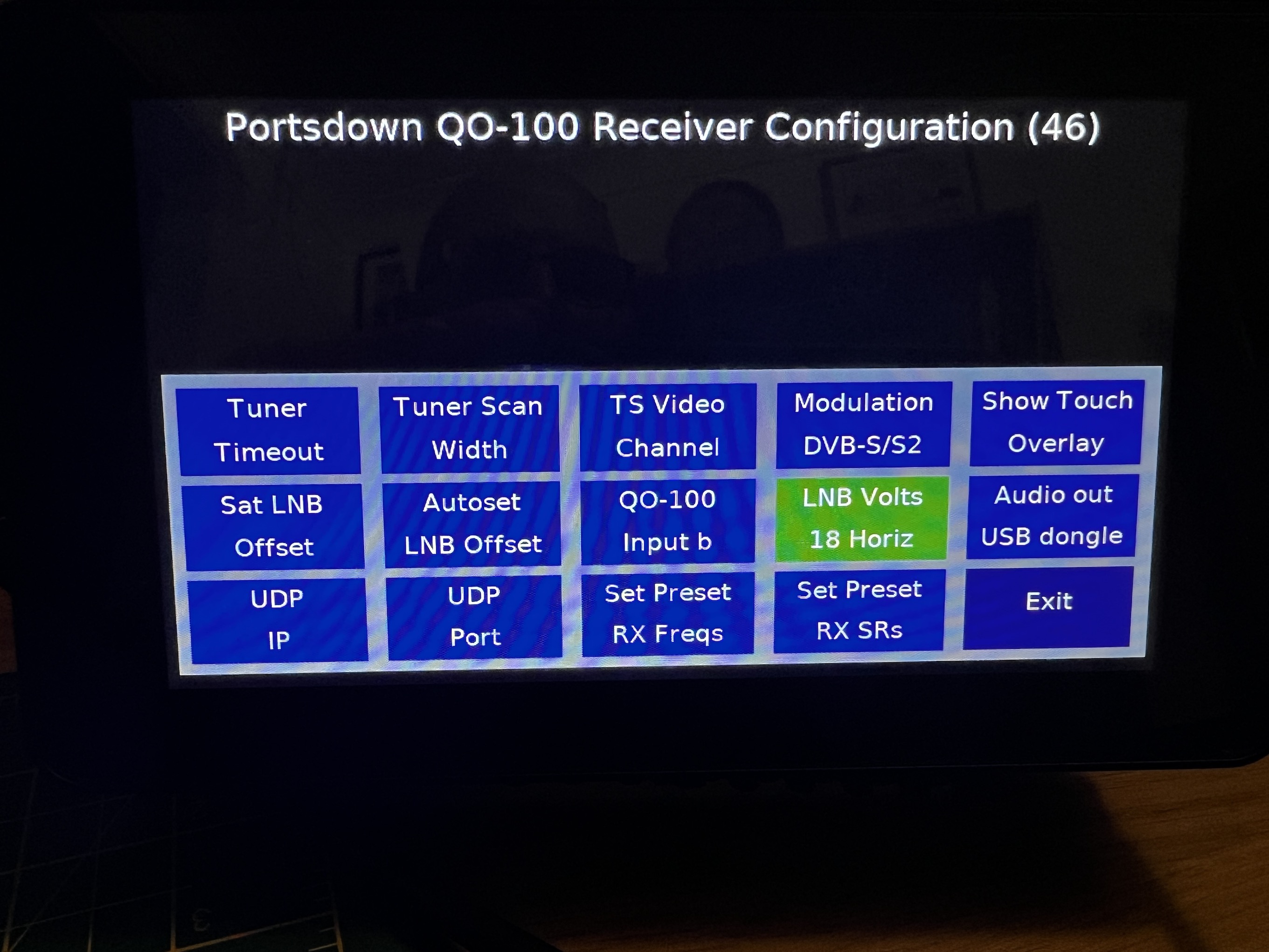

Config Screen
Config Screen

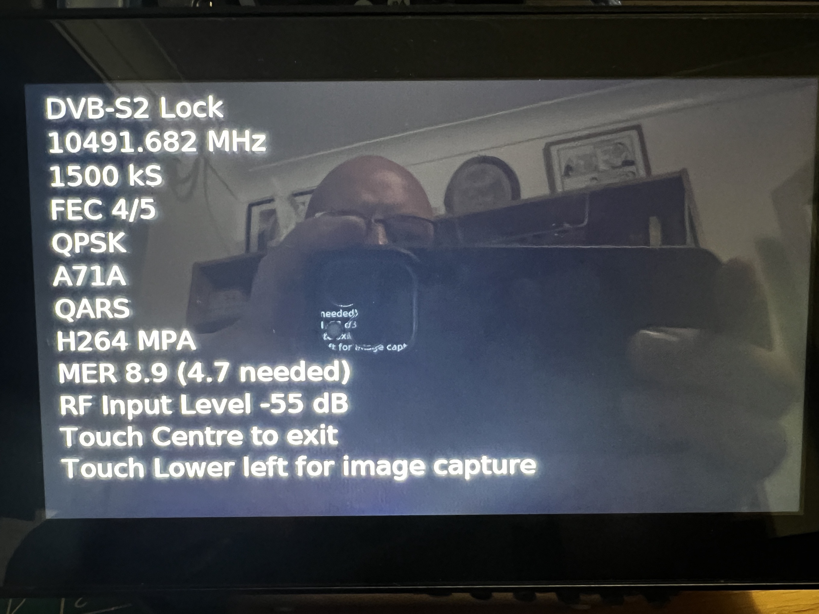

First Screen after RECEIVE selected

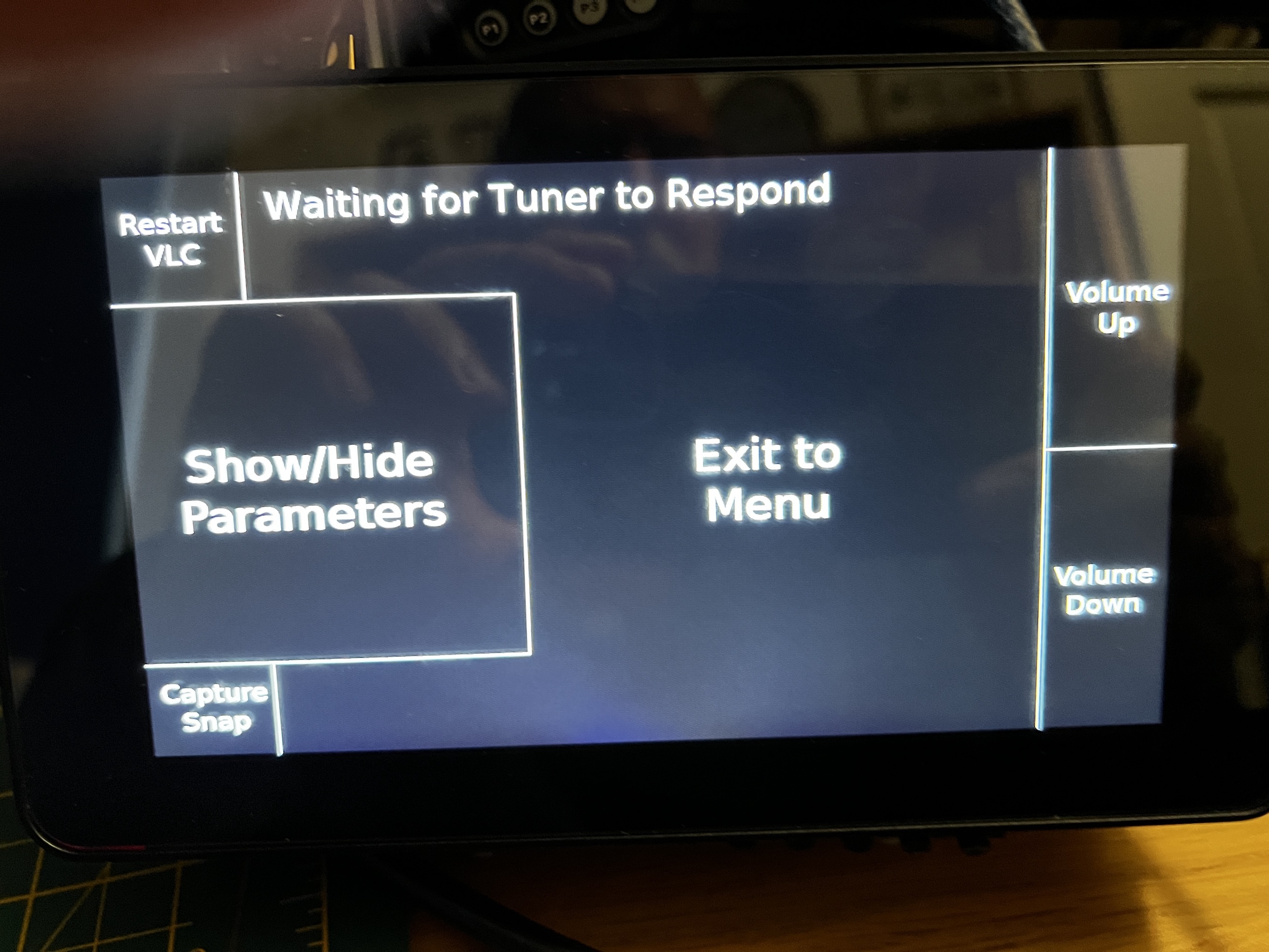

Second Screen after RECEIVE is selected

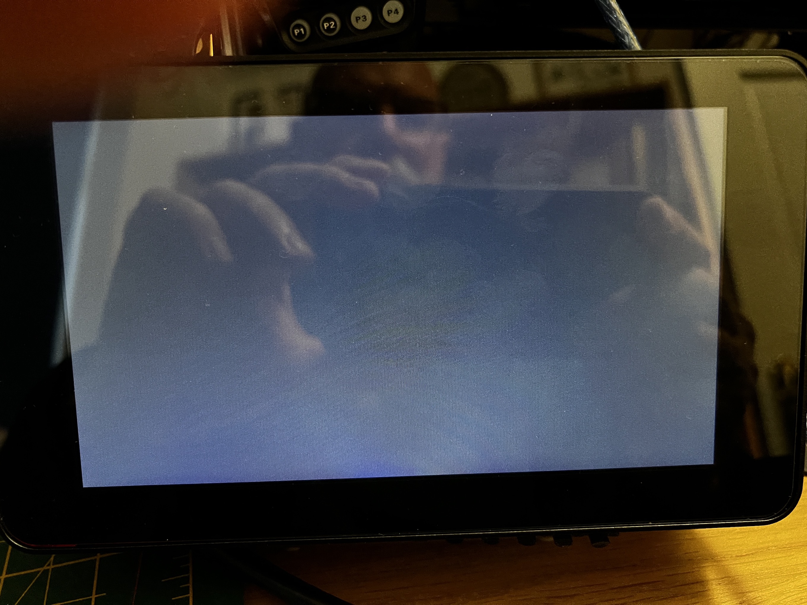

The final Screen instead of showing the image.

Sometimes the beacon is not working properly. Try again.. all looks OK, the MER is sufficient and it is clearly receiving it. You might just have picked a bad time.

Unfortunately it is doing the same thing this morning and I think it's a deeper issue with my PD4.
I have a mother issue that it shows the same grey screen when I try to stream to the PD4 using OBS and FreeStreamCoder. I select M2/IPTS Monitor but get no picture on the PD4 screen.
My reading leads me to believe both issues involve VLC and/or ffmpeg but that's as far as my 'understanding' goes. Could it be that vlc or ffmpeg have failed to install during compilation of the img. Is there a way to check or test them?

Have you checked that you have 18 volts coming out of the tuner as this is required to power the LNB in horizontal polarisation mode?
May need to power the LNB via a bias tee at 18 volts.
73 Keith

Hi Keith,
Just put the meter on it again after reading your message and it's putting out 18.73vdc at the box.
