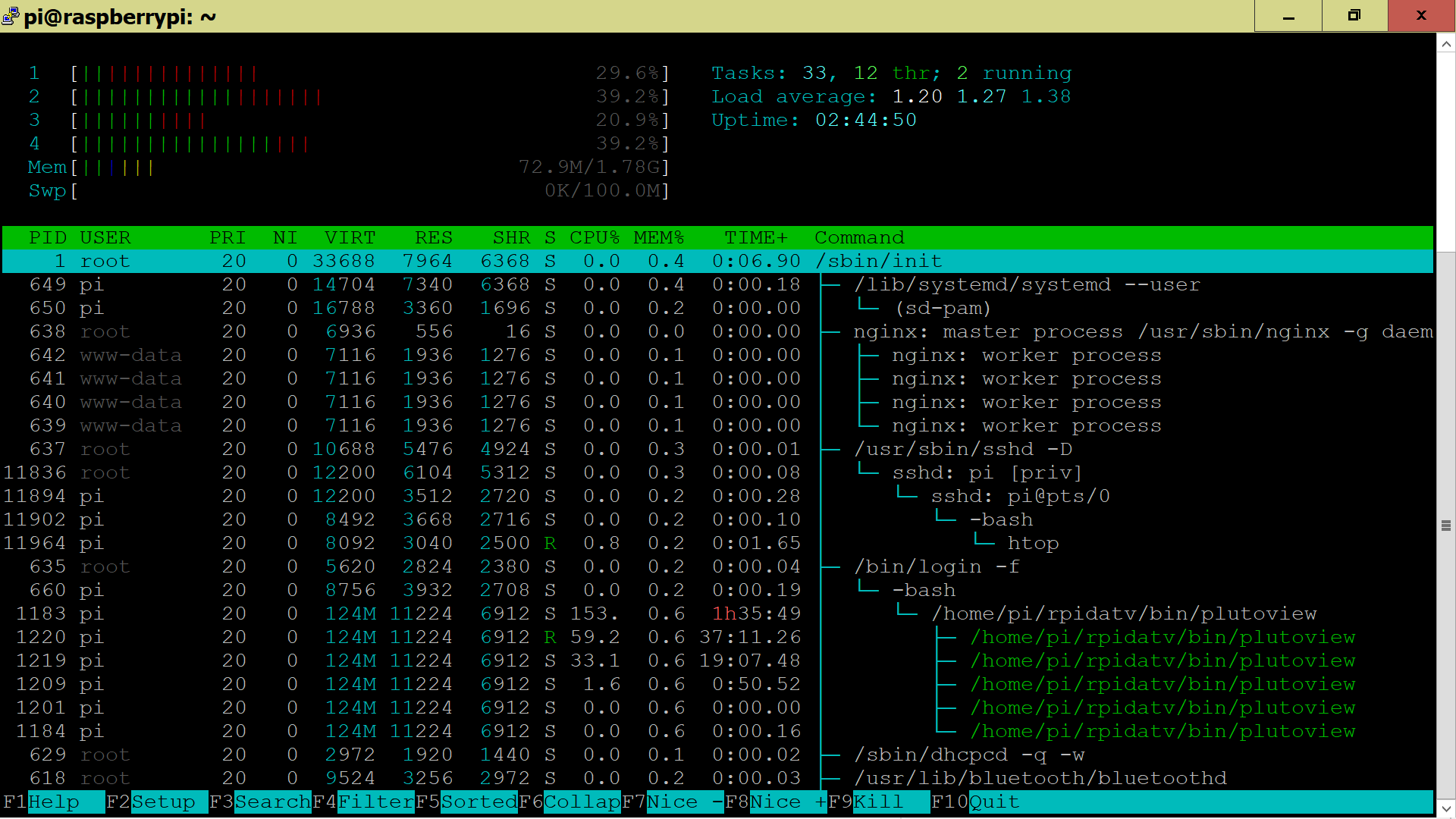

Post by G4EWJ » Mon Apr 29, 2024 5:33 pm
This one?

Post by G8GKQ » Mon Apr 29, 2024 7:06 pm
Hi Brian
Thanks. No clues there. It looks exactly the same as htop running on the development system (which does not show the spurious text).
What happens if you go to Settings and Centre Freq? Is the text still there when the page is redrawn after using the keyboard?
