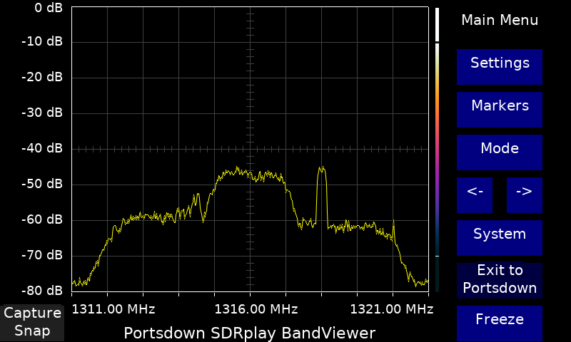

Just loaded the latest Portsdown 4 software on to a RPi 4 with no screen, just network, power supply, HDMI screen and SDRplay. The HDMI screen works and the Portsown web control allows control of it's funtions. NOT a supported feature but useful all the same!
Using it to show the received signal band veiw of GB3NQ on my input to the repeater...
There is a signal just below the main 1316MHz that has come up today. You can see both the 1316MHz 2MS/R and the 1318MHz 250kS/R signals
