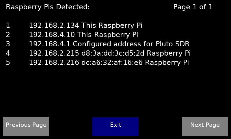

I have just released a minor update (202401251)for the Portsdown 4 that introduces the following new features:
  • The ability to list other network devices or other Raspberry Pis on the LAN. Select from Menu 2, File Menu. Only works for 192.168.*.* LANs. Similar to "Fing" or "Advanced IP Scanner"
