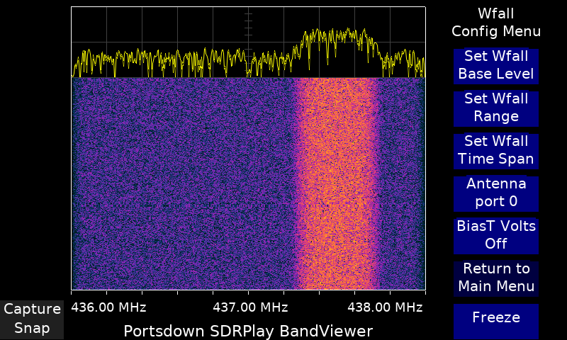

I have just released an update for the Portsdown 4 (202309260) which adds the ability to use the SDRplay series of SDRs with the BandViewer application. It also includes a waterfall display capability for the SDRplay BandViewer; I hope to add this capability for other SDRs soon.
The release also includes some updates to the MeteorViewer software.
Full details of the SDRplay BandViewer are on the Wiki. Please read before asking any questions. https://wiki.batc.org.uk/Portsdown_Band ... own_4_Only
