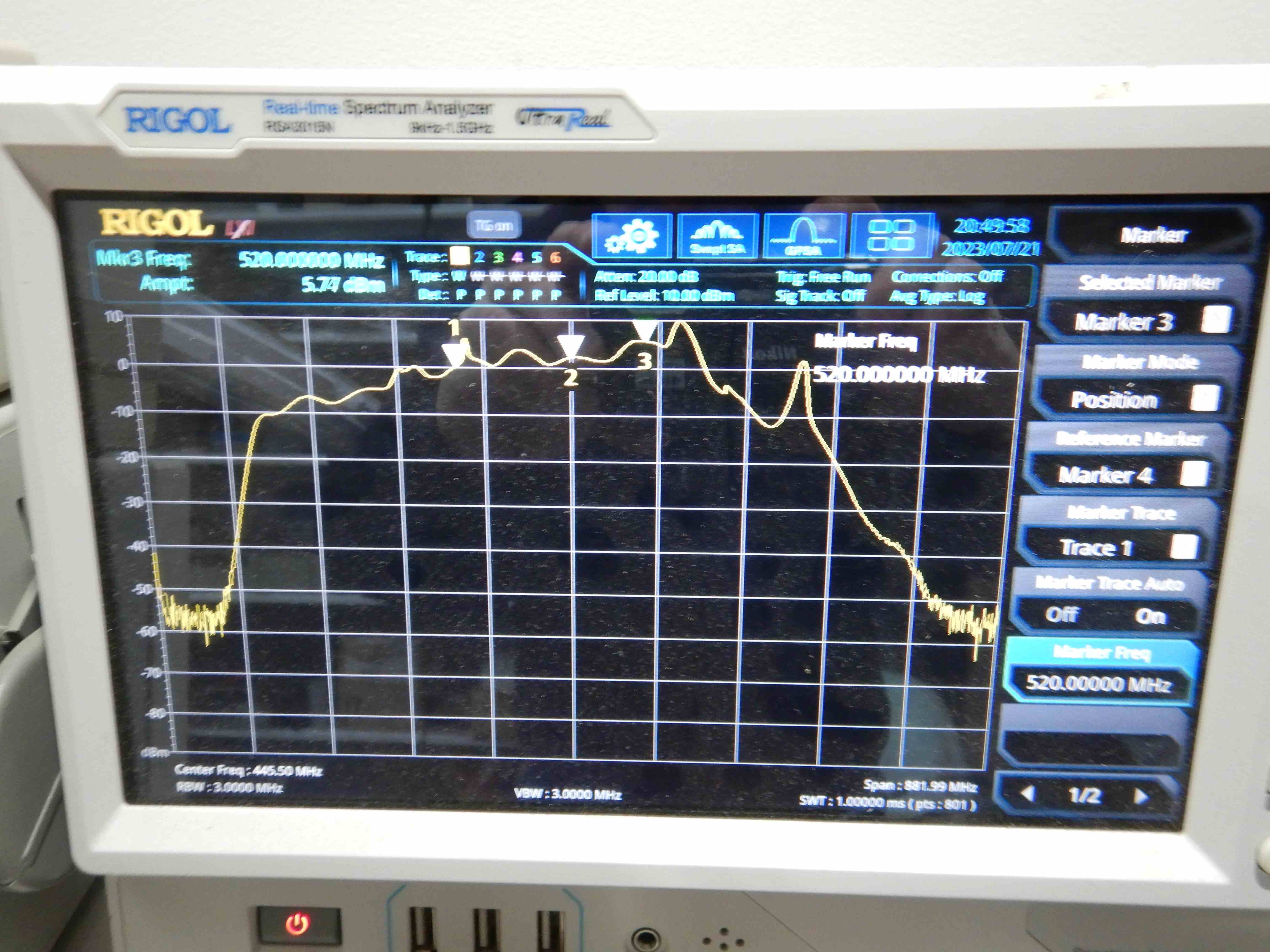

Did tests on the UHF RD60W3352F version, tests done at 445.5mhz
It does have 30ishdb gain, swept at 0db in, trace below with 30db attenuator IE 0db Ref is 1Watt

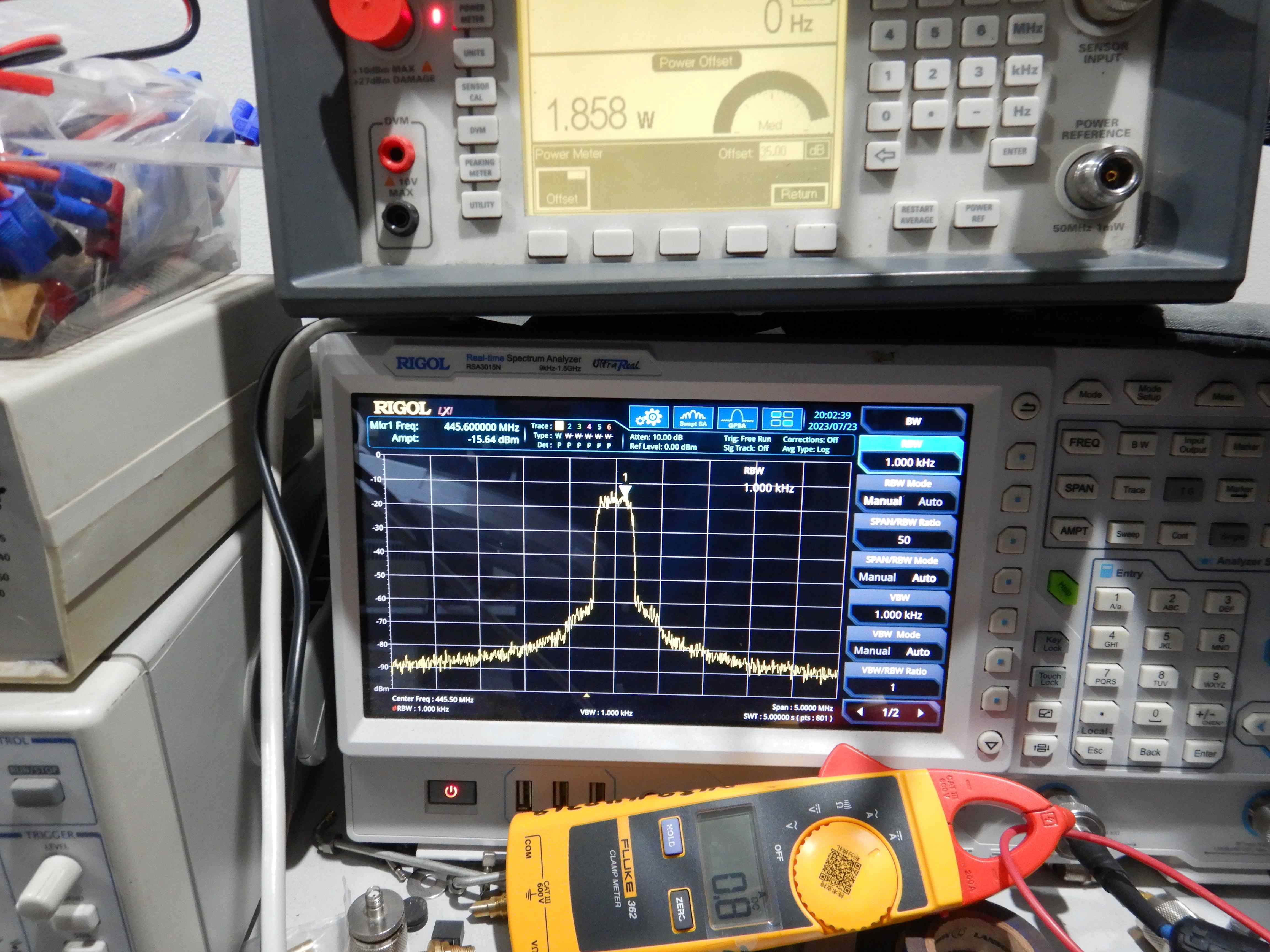

DVB-T 7mhz like we use in VK, don't even bother, got about 250mW before it took off (bad oscilation)

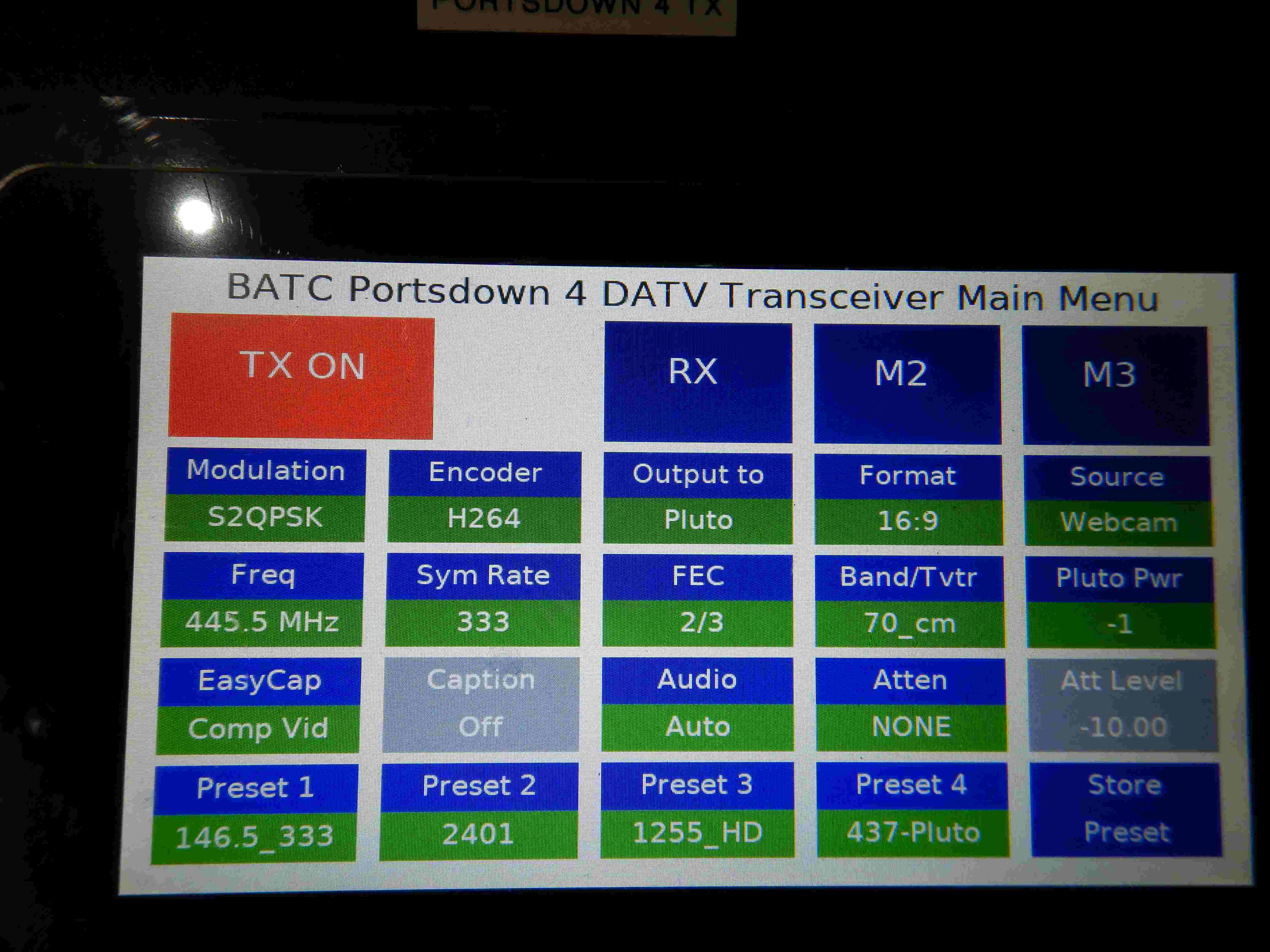

With Portsdown/Pluto got around 2W before it took off

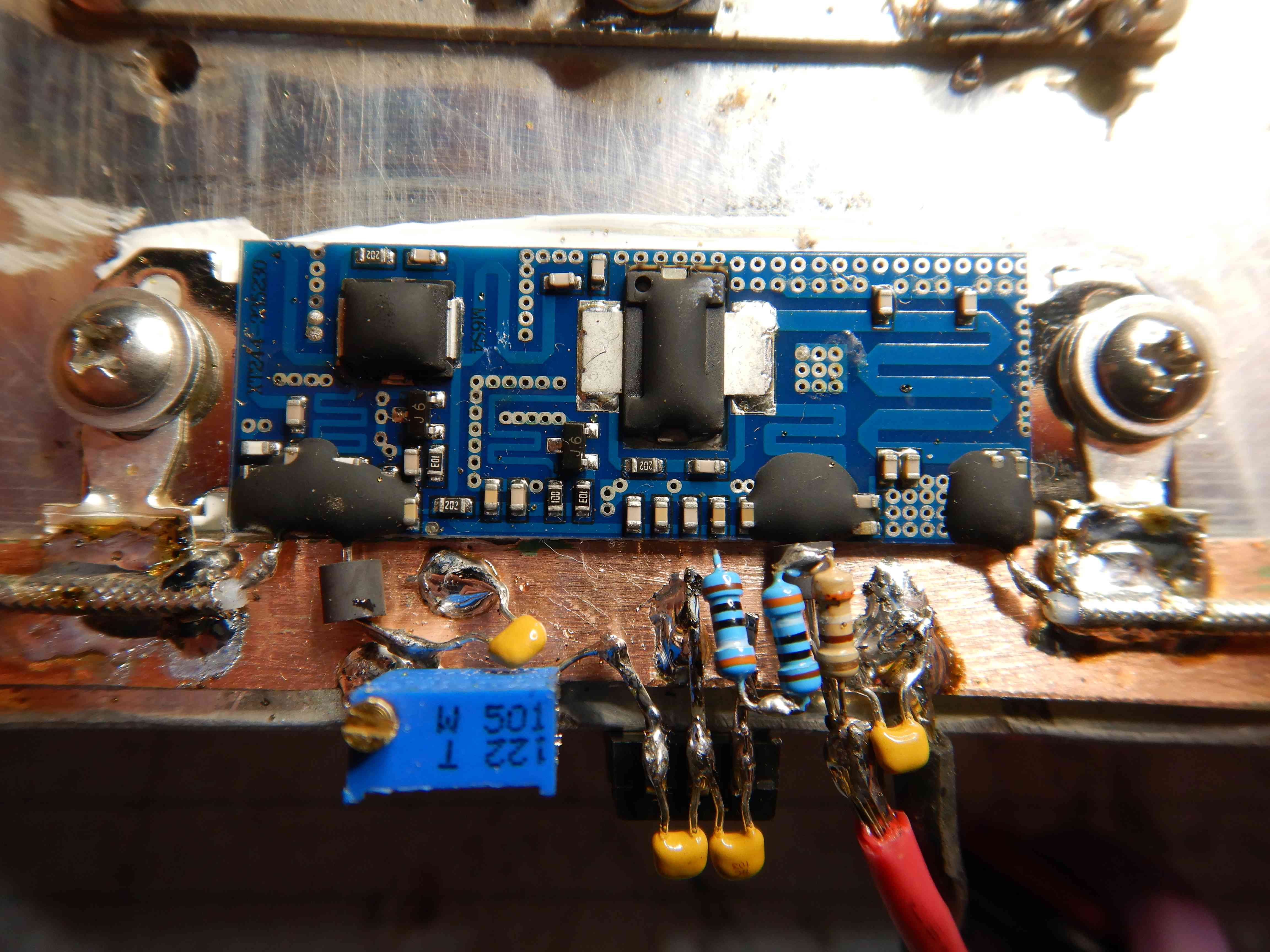

Needs an 3/6db pad on the input, Mitsubishi Modules have a pad built in
Recomended drive of 4.3V seemed about right current peaked around 0.8A @24V, stayed cool on a nice heatsink
Summary: a quarter of the cost of a Mitsubishi: you get about a quarter of the performance
Likely the VHF module will have a bit more gain, the only difference between VHF and UHF unit is the positioning of some matching caps
Mitsubishi have done way more R and D, the knock off radiates RF too, no nice metal box, that would really set it off
The real thing is very linear and harmonics are small, the knock off had major harmonics
