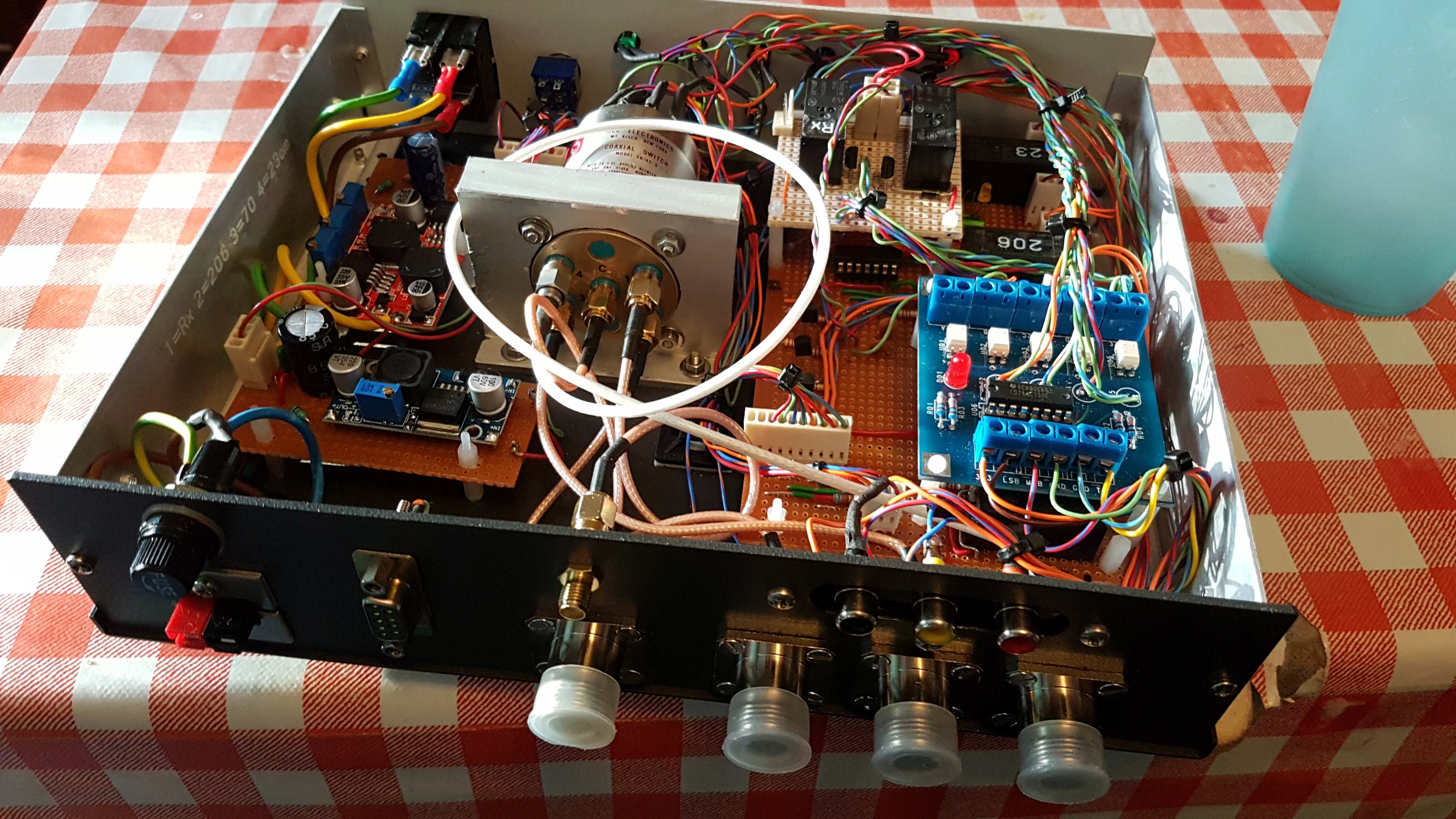

If you can find a many into 1 coax switch at a rally or on the web for sale then I used one of these to make my three band Rx/Tx changeover controller.
This one uses logic chips and G3KKD's sequenced changeover design to take the 4 band decoder outputs minus 70MHz [wasn't much use at the time] to connect the right amp or the receiver to the one aerial. I have a 4into 1 non-latching switch. It's been brilliant as I don't mind coupling one of the three aerial coax leads lying around the tailgate of the car into the rack.

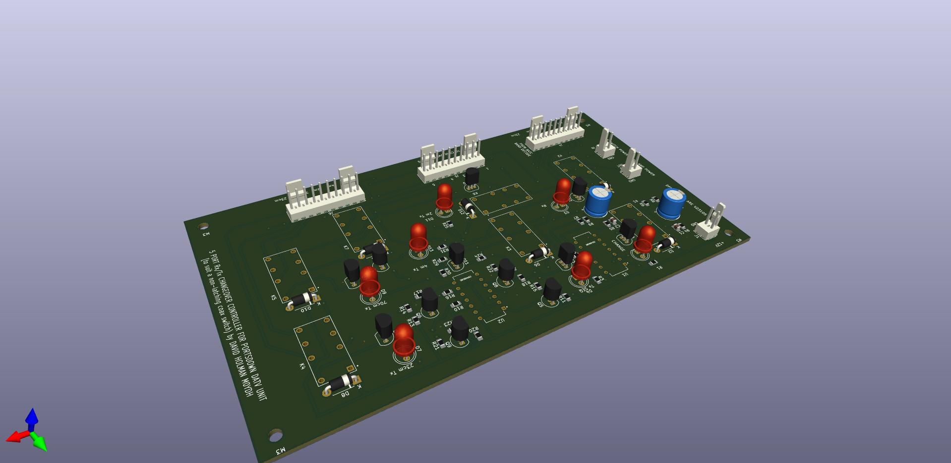

The other schematic is for the device under development by M0RNW for the G8TA unit seen in CQ-TV 278. We have a latching 6 into 1 coax switch so need pulsed switching . Ron likes Arduino sketches and the resulting circuit card will fit easily in the unit rails.

RxTx-Changeover.pdf- M0RNW design under development
- (85.57 KiB) Downloaded 581 times
M0YDH Rx Tx Changeover controller.pdf- Schematic from KiCAD
- (83.93 KiB) Downloaded 560 times
- Rx Tx change over controller.jpg (101.46 KiB) Viewed 8948 times
- non-latching 4 into 1 caox switch in a Rx-Tx changeover controller
