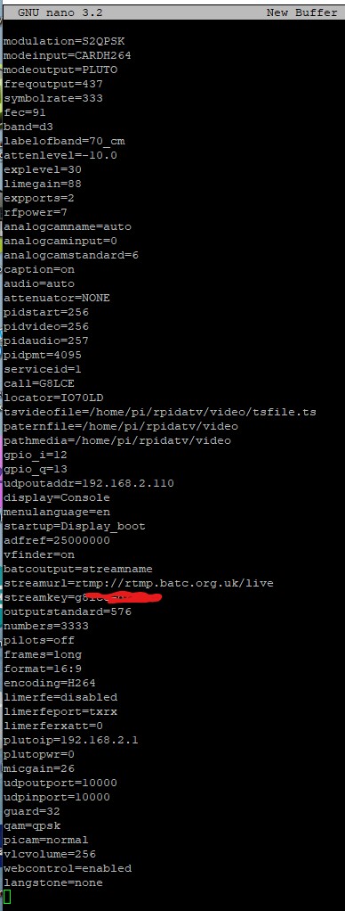

I have a spare RPi4 so used the Touchscreen remote control feature I think. BUT I updated without checking to the latest updated software and now cannot enable the web control. I have other Portsdown 4s and updated those to the latest firmware and they work from the remote touchscreen control but they also have screens. It is the one without a screen I cannot remote web control. And yes I have tried to enable it from the SSH console menu.
Martin G8LCE

Post by G8GKQ » Sat Jan 07, 2023 4:04 pm
Hi Martin
Please cut and paste the contents of the file
Code: Select all
/home/pi/rpidatv/scripts/portsdown_config.txt
here and then we can see what has gone wrong.

Post by g8lce » Sat Jan 07, 2023 5:14 pm
Had some trouble doing that! Hope I have got the right data...
Screenshot 2023-01-07 171229.jpg (98.68 KiB) Viewed 7342 times
Martin G8LCE

Post by G8GKQ » Sat Jan 07, 2023 8:16 pm
Martin
Please follow the instructions on the Wiki page that is linked in the first post about this capability. Particularly the section that details how to set up the Portsdown 4 to work without a touchscreen: https://wiki.batc.org.uk/Portsdown_4_We ... _Connected
I think that will solve your problem.

Posts: 435
Re: Portsdown 4 - Web Control without a Touchscreen
Post by g8lce » Sun Jan 08, 2023 11:01 am
Thanks Dave,
That was the reason.
