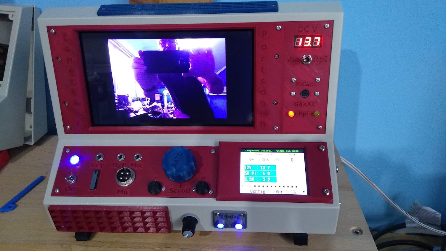

Here's mine, one USB on the side for band viewer etc...
Pluto, sound dongle and Arduino mouse emulator built in, (so its Langstone capable too), audio amp and speaker, Morse key, lick sockets VBatt and V RPi also RPI camera and on the back I/O for amp control and other add-ons like Power meter.

thanks Gareth!
I followed the development of your "set-up" since the beginning!
as well as the Martin's (G4FKK) one.

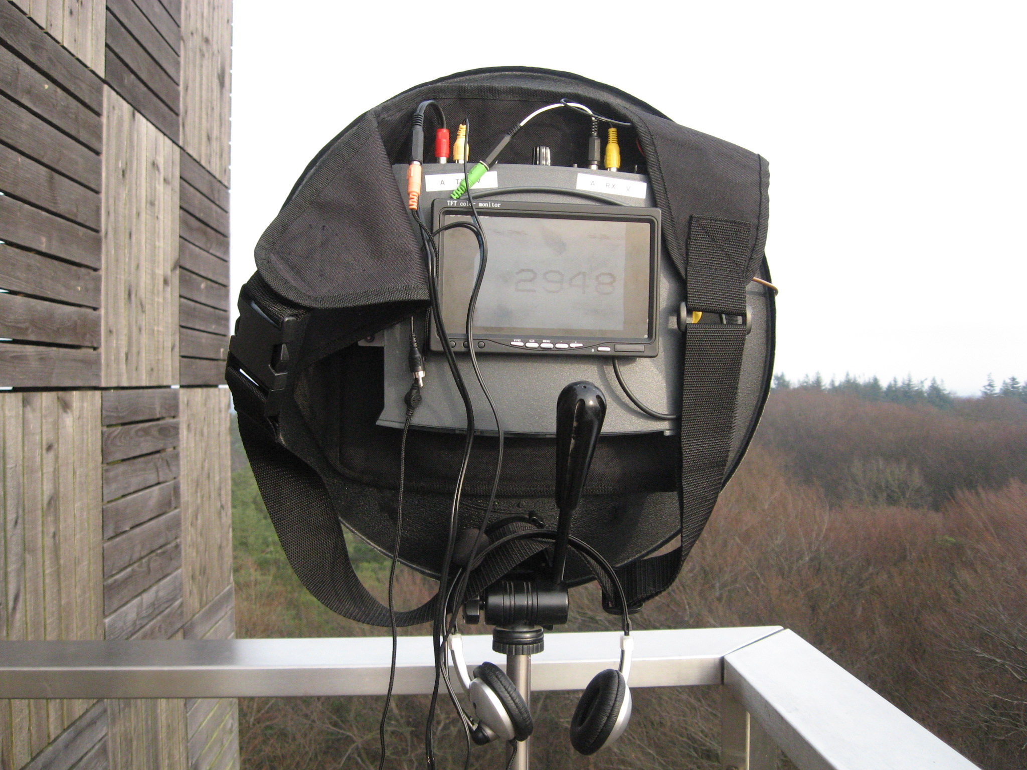

Other small ideas (maybe obvious):
make kind of belt on the equipment that it makes it possible to carry the station an easy way. Eventual even with your hands free. Even when the distance between the car and the location is small. I cannibalized some backpack for that. Or ensure at least some handgrip.
I also use some Velcro, for example to attach the TFT monitor to the station. Makes it possible to do an easy switch between the stations (but not very handy in case wool gloves are used :D ).
6 cm portable station of PA3CRX.
6 cm station of PA3CRX.JPG (919.91 KiB) Viewed 4778 times

Post by i2NDT » Wed Mar 30, 2022 12:40 pm
thanks Chris!
that's a good idea: I have a couple of flat antennas I can use (instead of a dish) for 6 cm portable!
