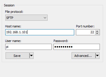

Hi Ken
As you know I've been changing the testcards for better quality versions for a couple of years. I use WinSCP; download from here: https://winscp.net/eng/download.php
Then find your Portsdown's IP address from the M2 menu and press 'Info'
Start WinSCP. In the Login window click 'New site'. Fill in the right hand pane so that it looks like this:
Change the IP address shown to match what you have in the Info report and the default username/password is pi/raspberry. Change the password if you have altered the default. Click Login.
You'll then get two panes like File Explorer, the left hand one is your PC and the right hand is the Portsdown. You can then use the upload and download buttons to copy files in either direction.

Thanks Clive,
Just what was needed
