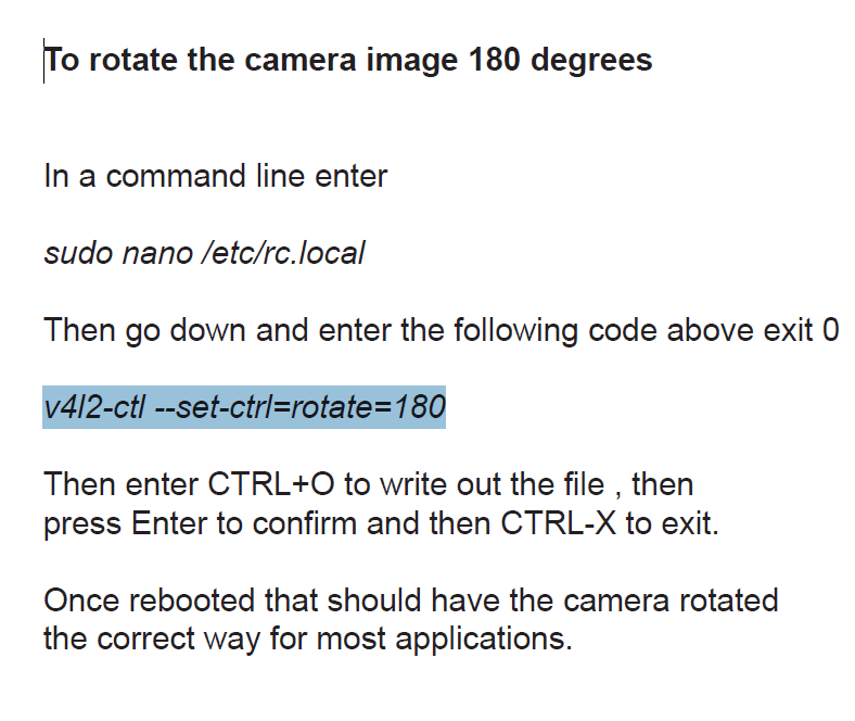

Thank you Dave,
Glad to hear it about the camera. In the meantime I found this and it inverted the picture (posted in attachment) if someone needs to invert the video with Pluto
- Invert camera.PNG (38.51 KiB) Viewed 3775 times
