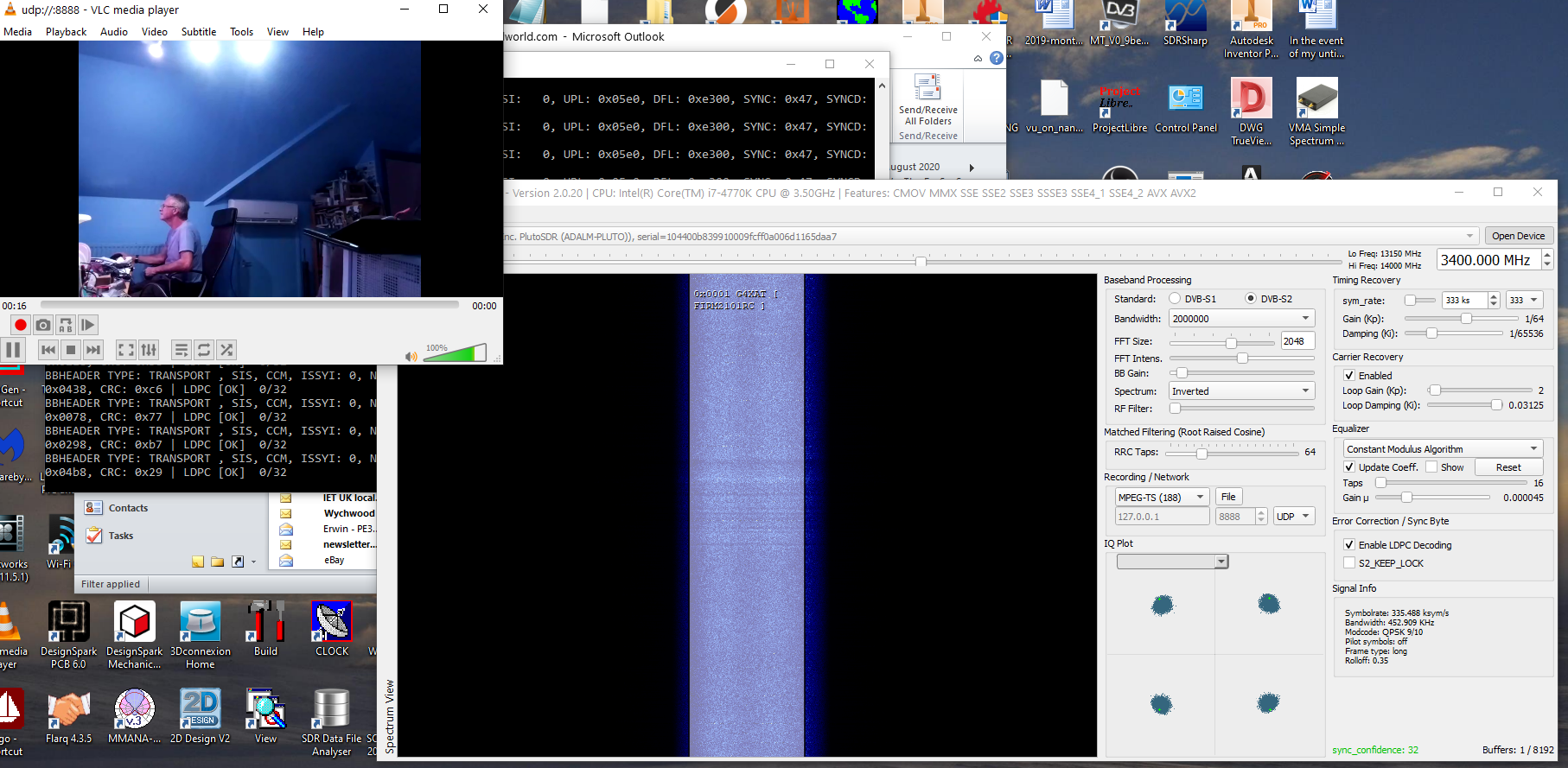

A cheapo (£5 delivered) Picam plumbed in this evening using a 12" ribbon, Pluto to Pluto across the shack on 3.4GHz. Glaring lights are very bright LED so I can see what I'm doing,
Lucky to have a working Purple Stealth amp for the band too and a duplexer that should help the front end.
Next question is a suitable gain antenna. Bi-quad perhaps? Flat-plate from yagi.pl? Gareth

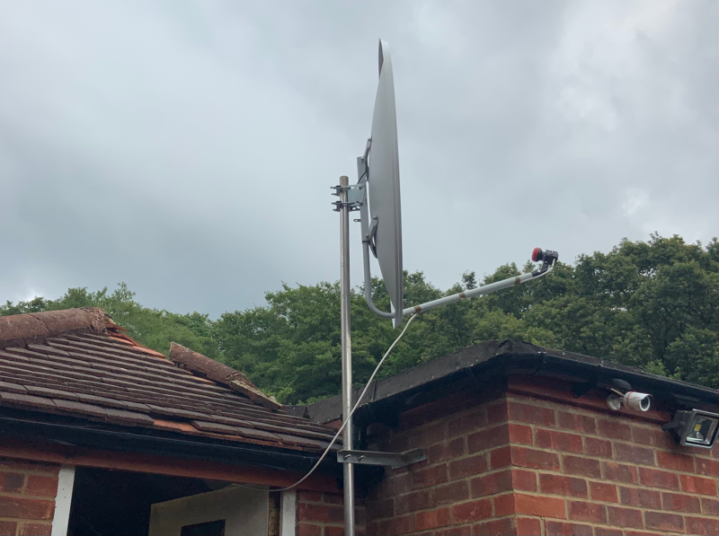

1.2 m dish is above the garage at the moment so i can adjust it and see in the shack but thats moving later as well.
