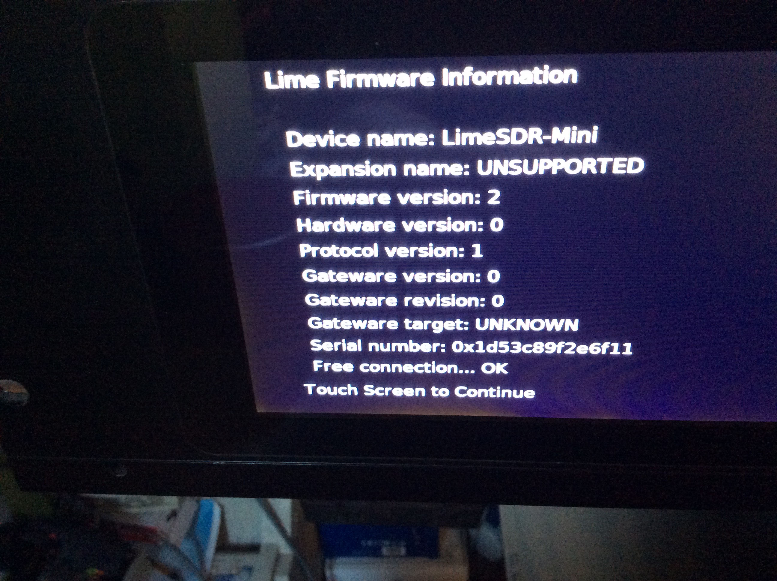

Ok just tried going from 1.30 to dab firmware. No output at all, the TX spike suppress line doesn’t change state now either. If I check the firmware I get as shown in photo. Only way back to the v1.30 is via lime suite.

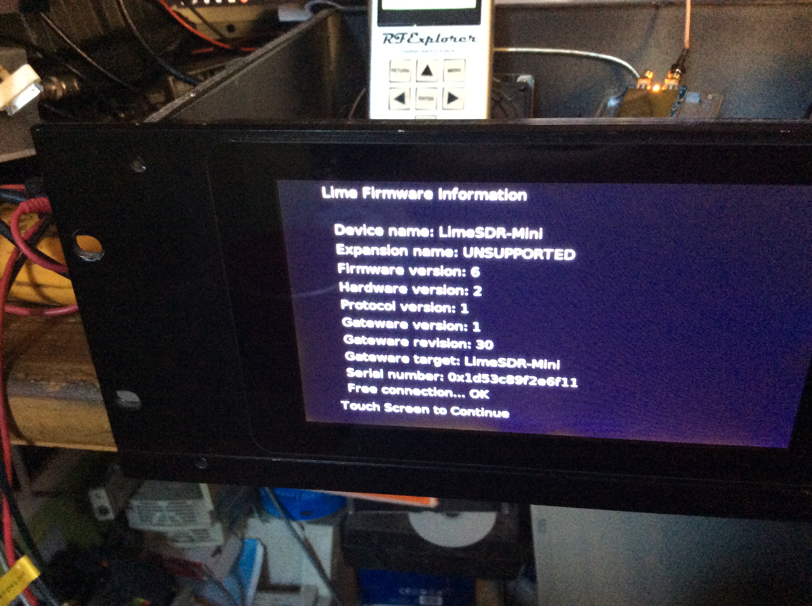

Info having used lime suite to recover lime

Try plugging the Lime directly into the Raspberry Pi.
The symptoms point to a faulty USB cable, faulty Raspberry Pi or a faulty LimeSDR. The Portsdown uses LimeSuite to do the programming, so there should be no difference.

Ok. This morning I realised the comp video usb stick was plugged into the other usb 3 socket. Removing it and putting it to the usb2 socket solved the problem, I can update the lime, upgrade to dvb and the TX looks ok on the analyser. I need an on air test to confirm this and I’ll do it later on. Thanks for your help, I was looking in the wrong place, ie an Rf problem when all along it was a usb issue.
