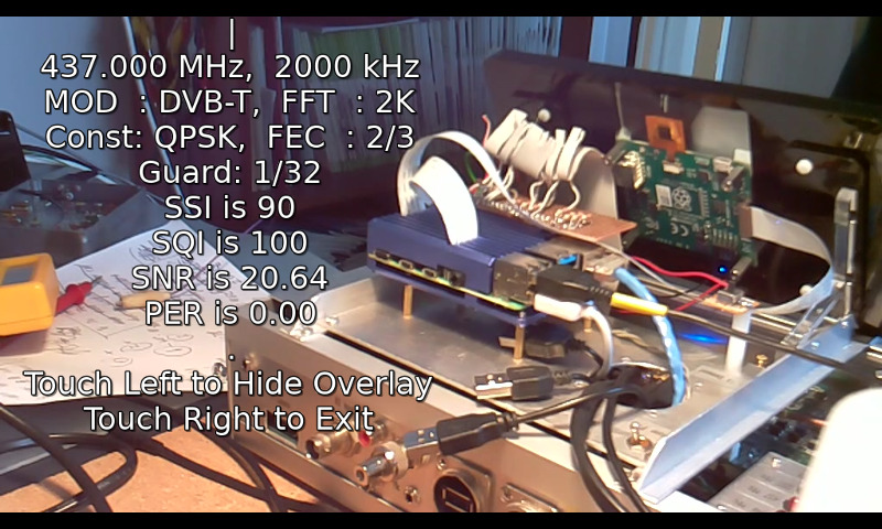

I have tried to make the Pluto work at 1.7 MHz, but there appears to be a problem specific to the Pluto. The LimeSDR, using almost the same software, manages 2 MHz bandwidth (as below) and works well at 1.7 MHz.
Not sure if the problem is in the Pluto USB driver software in the transmitter, or the Pluto on-board USB interface. I suspect the latter.
Perhaps someone with more expertise on the Pluto could take a look at it?
