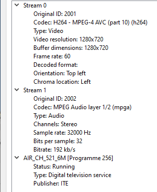

I think I might have just spotted the problem. There is no active audio stream coming out of your LKV383A.
Try reconnecting the HDMI cable (this can cure a no audio problem if it should be there) or using a different HDMI source with audio. You are looking for audio stream information as shown below. Note that I have set this particular device for 720p output.

Hi Dave,
Very well spotted! Lack of audio on the HDMI port was the problem.
I found that the sound settings on the HP Z-Book Laptop I was using as the HDMI source was still set to the Realtech Audio and not to the HDbitT HDMI Sender.
All working fine now. Many thanks for your help in fixing the issue.
