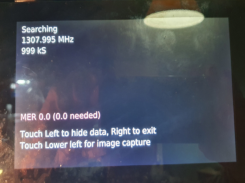

ive got my portsdown built wiht a lime and mintioune v2 all in the box with touch screen.
when i go to rx on a set freq . it goes to rx screen and scans around the freq required but after a few mins it just stops
i have to tap the right hand side of screen a few times before it comes out of rx then go back in to rx
it does this in
Play with ffmpeg in vlv, omx player and vlc
