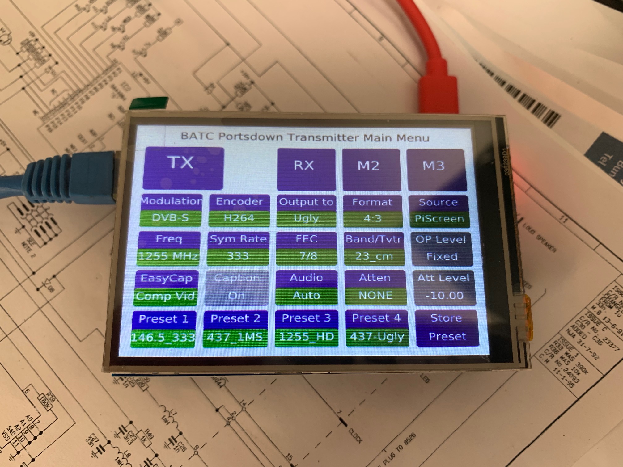

Re: Starting out
Success!!!!!!
After the 4th OS install and portsdown install??????
I'm sure there will be a billion questions..........
Thanks Dave.
Thanks Dave.
Regards
Mark

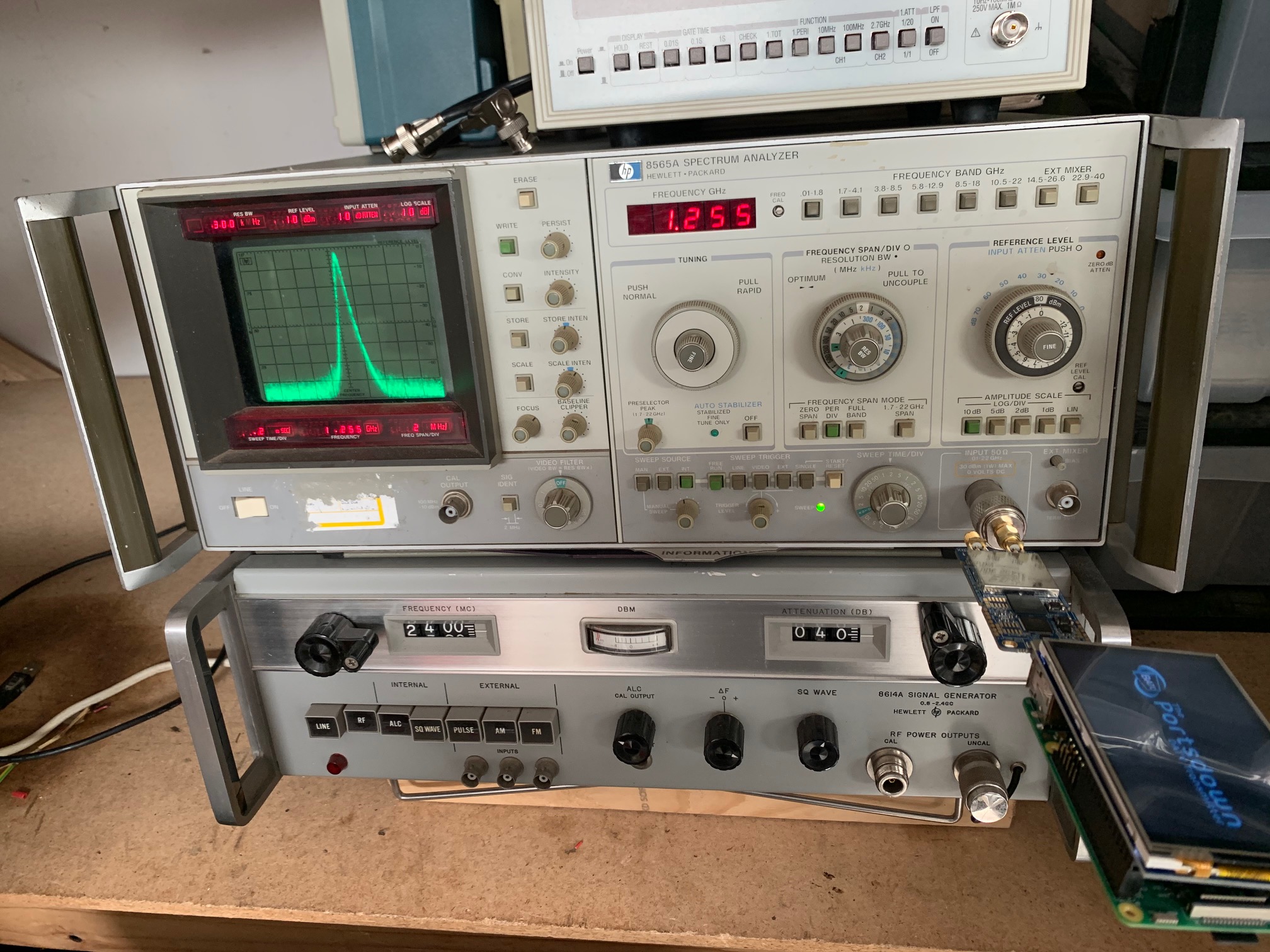

Re: Starting out
Even more success.......great project Dave.
- IMG_9667.jpg (696.08 KiB) Viewed 4002 times
