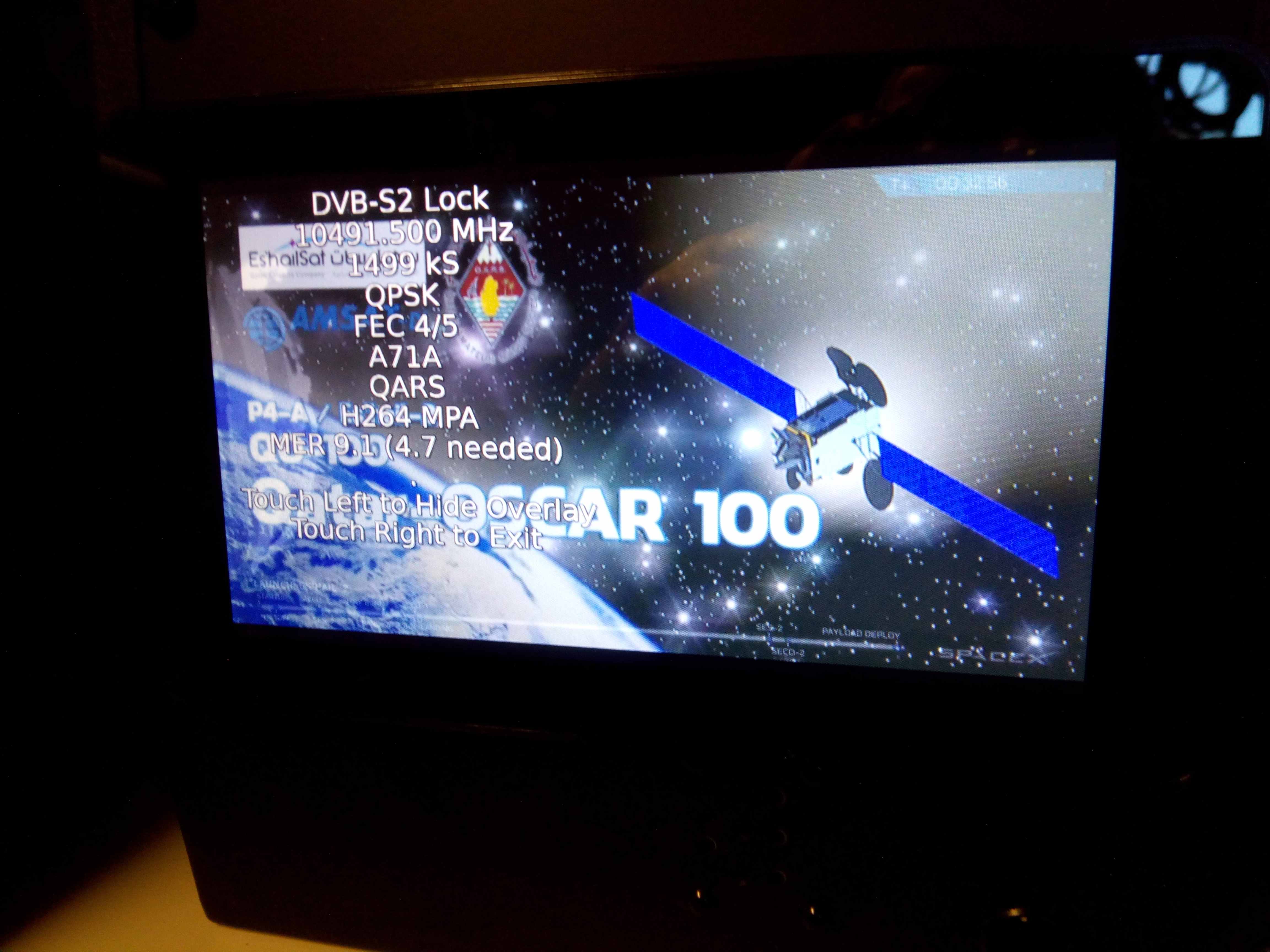

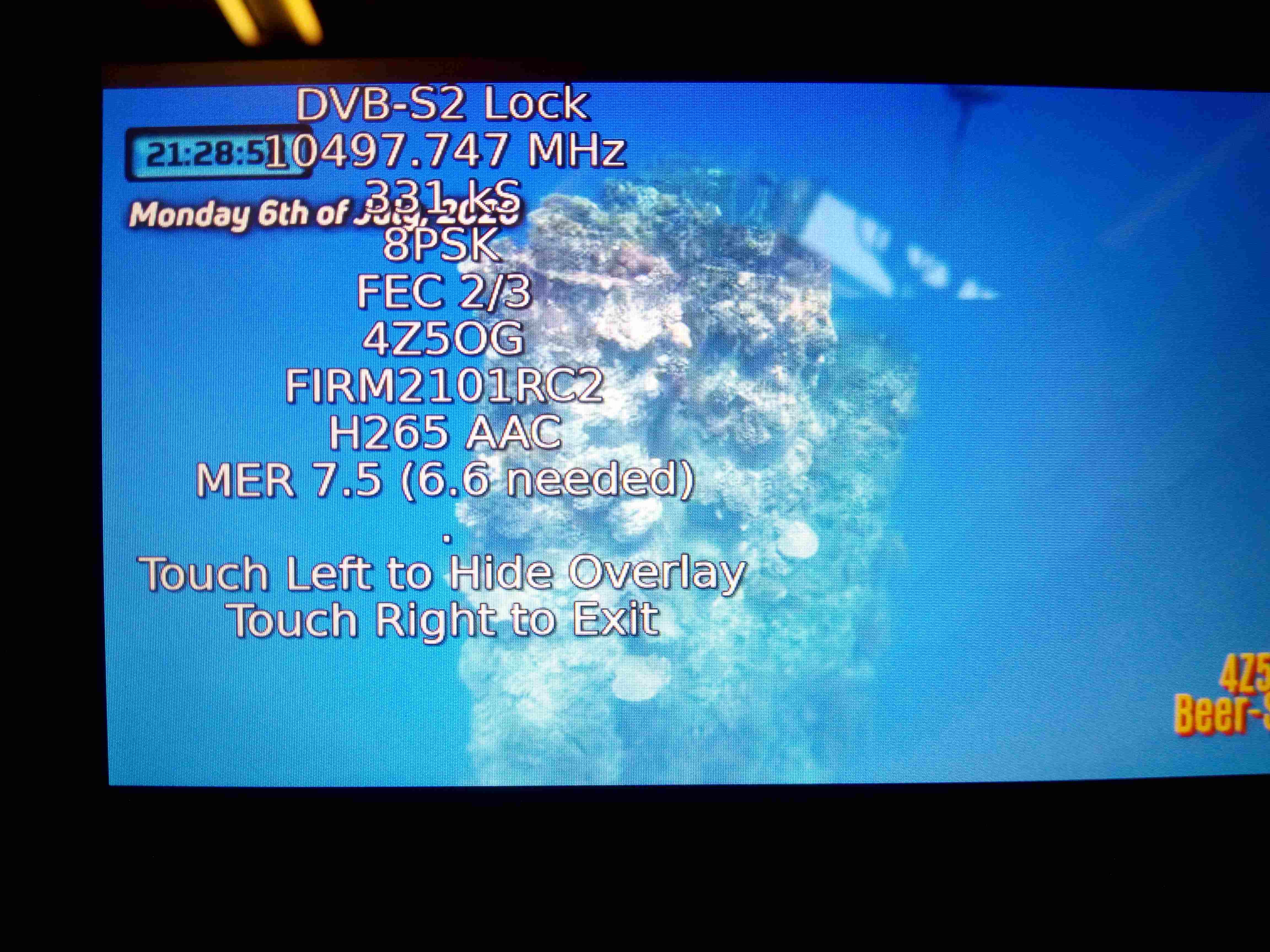

I have just released a new Portsdown Buster 2020 version: 202007011. There are major improvements to the LongMynd receive functions, but no changes to the transmit side of things. Well worth updating for the receiver improvements:
  • There is a new receive video player "ffmpeg VLC" on the bottom left button of the Receive menu. This is now the preferred player and generally will display any selected signal (MPEG-2, H264 or H265) on QO-100 including the beacon.
  • The signal parameters (Station ID, MER, encoding etc) are displayed as on overlay on the video from this player for 8 seconds after signal lock, and then they are blanked. You can display the parameters again by touching the left side of the screen (remember though that touching the bottom left corner takes a video snap).
  • DVB-S signals now have their MER reported (it was stuck at zero in previous releases)
  • Receiver frequencies are now displayed and entered in MHz, not kHz.
  • The tuner power control (for LNB power with the extra PCB) has been properly enabled.
  • If you want a large screen MER for non-beacon signals, this is available by selecting the UDP button. This is useful for aligning aerials for maximum MER when in outdoor situations. The large screen MER for the beacon remains available from its own button.
  • I have fixed the bugs that caused the streamer display (and IPTS monitor) to fail to start.
